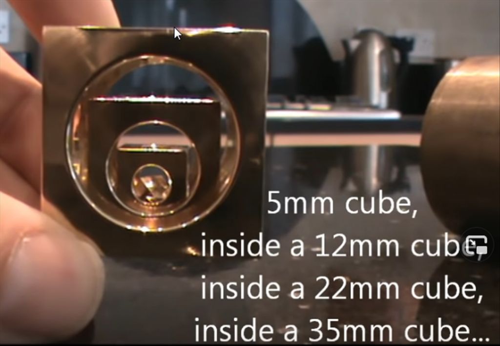

      I am stuck indoors still recovering from a operation so I'm a bt bored at the moment so asking this question. In the early seventies my father who was on maintenance at Vauxhall motors Luton was in the apprentice school and he told me at the time that a competition with Opel Germany , how many balls in a square block can be turned. By all accounts Luton won I think six balls, if this is true is there a web site that can explain the process.
      Bob

          I have not seen balls machined in a square box but this is a Youtube link to a Turners Cube, cubes turned inside of cubes
          **LINK**

          BOB BLACKSHAW 1
            @bobblackshaw1
            Thanks Paul, it was a long time ago so my memory got it wrong.
            Bob
            #501711
            Henry Brown
              @henrybrown95529
              I had the "pleasure" of making one of those cubes as Paul's photo when I was at Worcester Tech on my block release while doing my apprenticeship. I remember it was pretty straight forward until I got to the last side of the cube and the tutors insistence on accuracy of both bore size and depth became apparent, I remember when breaking into the other bores it was a bit scary!

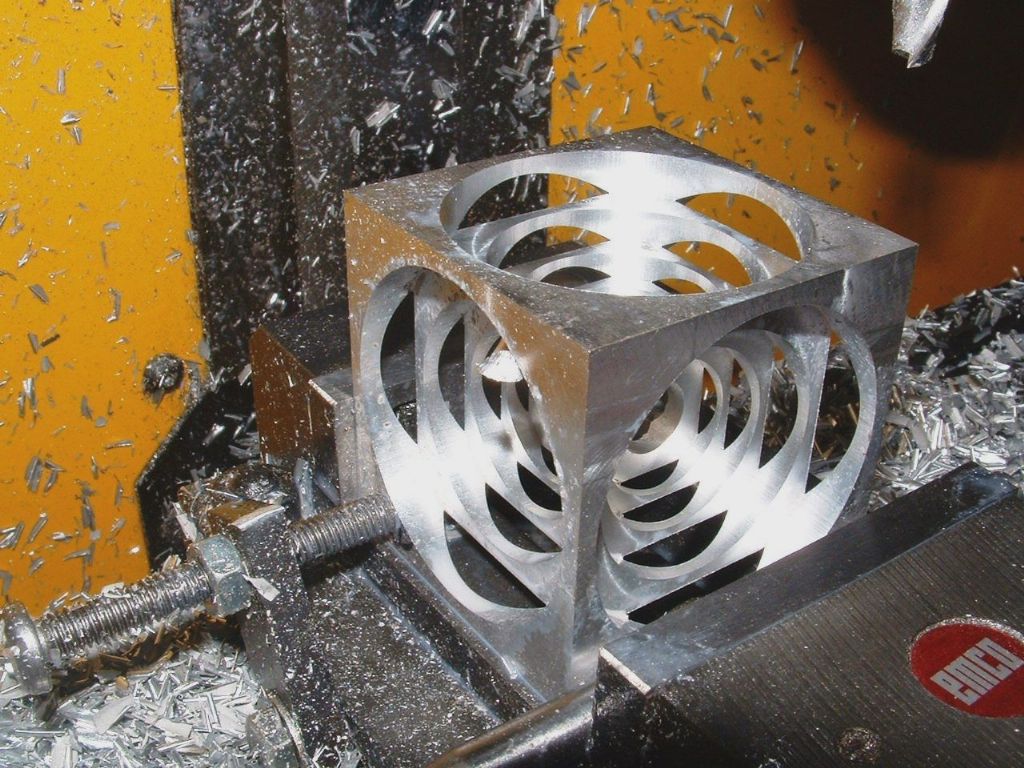

                      This was done some years ago when the article appeared in the Digital Machinist mag, final cuts had to wait until a suitable 45 deg dovetail cutter was available, final cuts still not done many years later.
                      Emgee
                      #502146
                      Henry Brown
                        @henrybrown95529
                        I made mine on a lathe, was that done on a CNC mill Emgee?
                        #502152
                        Emgee
                          @emgee
                          Yes Henry, using a HSS 2flute 3/8" cutter at 2000rpm, the max spindle speed.
