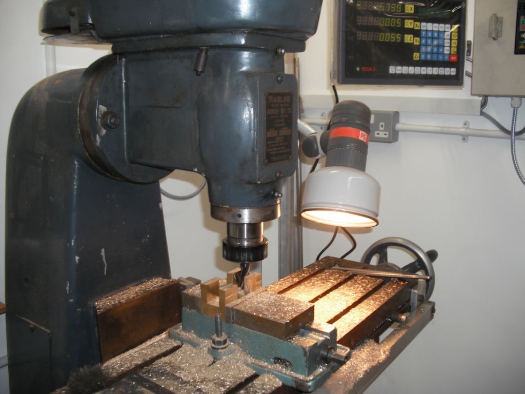

                              I am getting a good finish at least IMHO, fast cutting speed and slow feed with a very sharp solid 12mm end mill.
                              Corners are sharp but a small clearance is not a bad thing all be it there is only 1/32" left on each side after the bearing is machined so just the minimal removed. May see how the fit goes as to how much to remove from the corners, as for getting the keeps parallel that's another story as it only takes a very small amount out of true and you can be 0.001" out.

                                  Made a start on the axle boxes

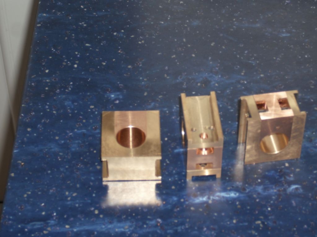

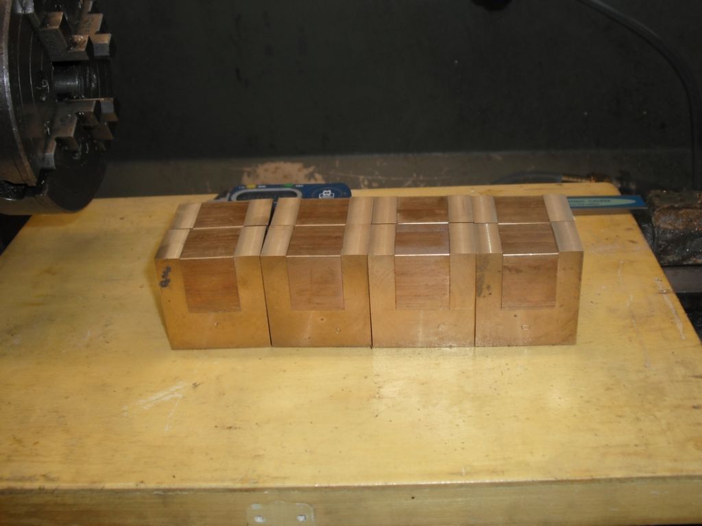

                                    I now have 8 blocks with inner piece fitted, they are a sliding fit, they will not drop in but a little pressure from a finger and they slide in. I used a deburring tool to take a slight chamfer off the bottom edge where it meets the corner.
                                    Bob

                                      Have completed the machining of all 8, I fitted the keeps, machined the outer faces and the holes for the axles. One thing I found was the axle boxed closed up a fraction as the keeps are a little harder to fit than they were but I can still push them together by hand. I marked each pair as they are matched so removal should nt mean they get mixed up.
                                      The drawing shows a slight curve to allow the boxes to "rock" but does not say how much so put a slight angle on each end and dressed it to a sort of curve may be 0.020" wider at the ends than the centre. The leading and trailing boxes are 1/16"th wider than the middle pair to allow for cornering.
                                      A further question is what should the axle clearance be? I settled on a couple of thou but not sure that is enough as the axles "rock" when traveling around the track. Once I have the axles assembled in to frame I will try it on the club track to see how it copes with the curves.
                                      Bob
