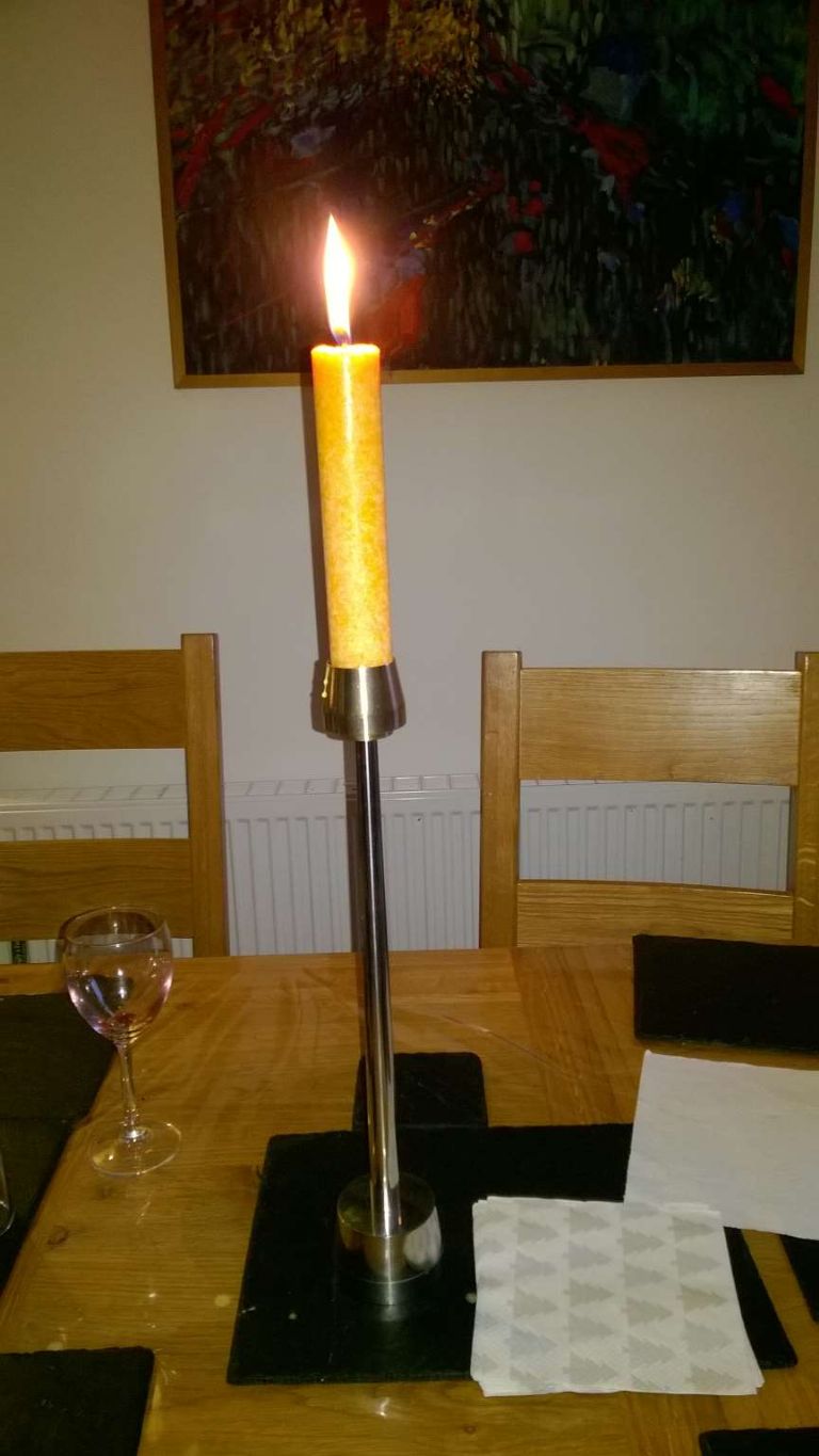

      So for Christmas I made a Candlestick out of steel and brass. Mainly to prove to SWMBO that my hobby could actually produce recognisable things.
      This quite confused her as it was reasonably good and recognisable, but soon enough she found the flaw. It drips wax. It's a fire risk. It needs a wax catcher. And it was duly put to one side.
      Never one to be daunted, I've eventually got round to making my wax catcher.
      the idea was a round plate of brass flat to the base of the tulip thing that has the candle in and then curving up.

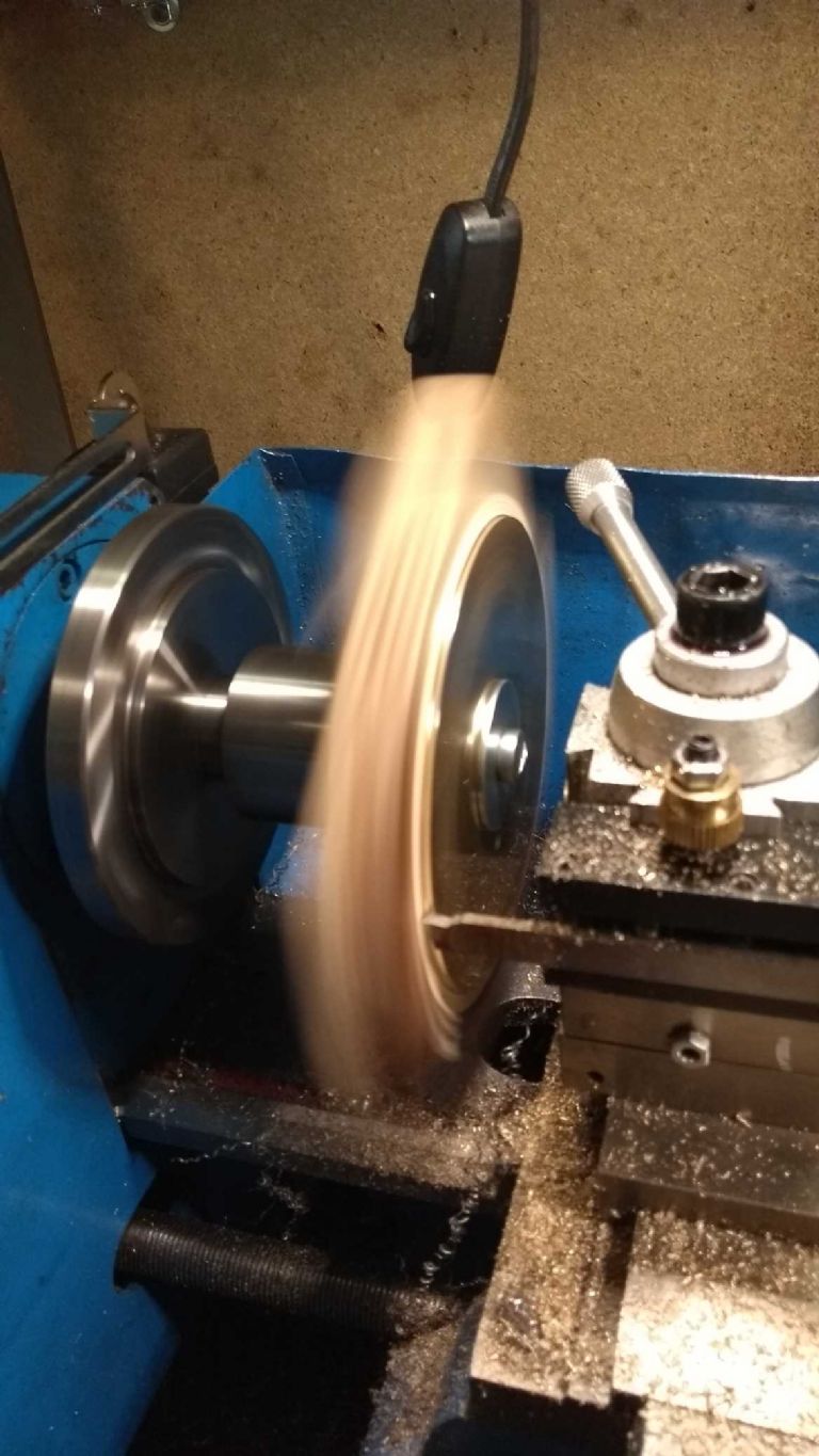

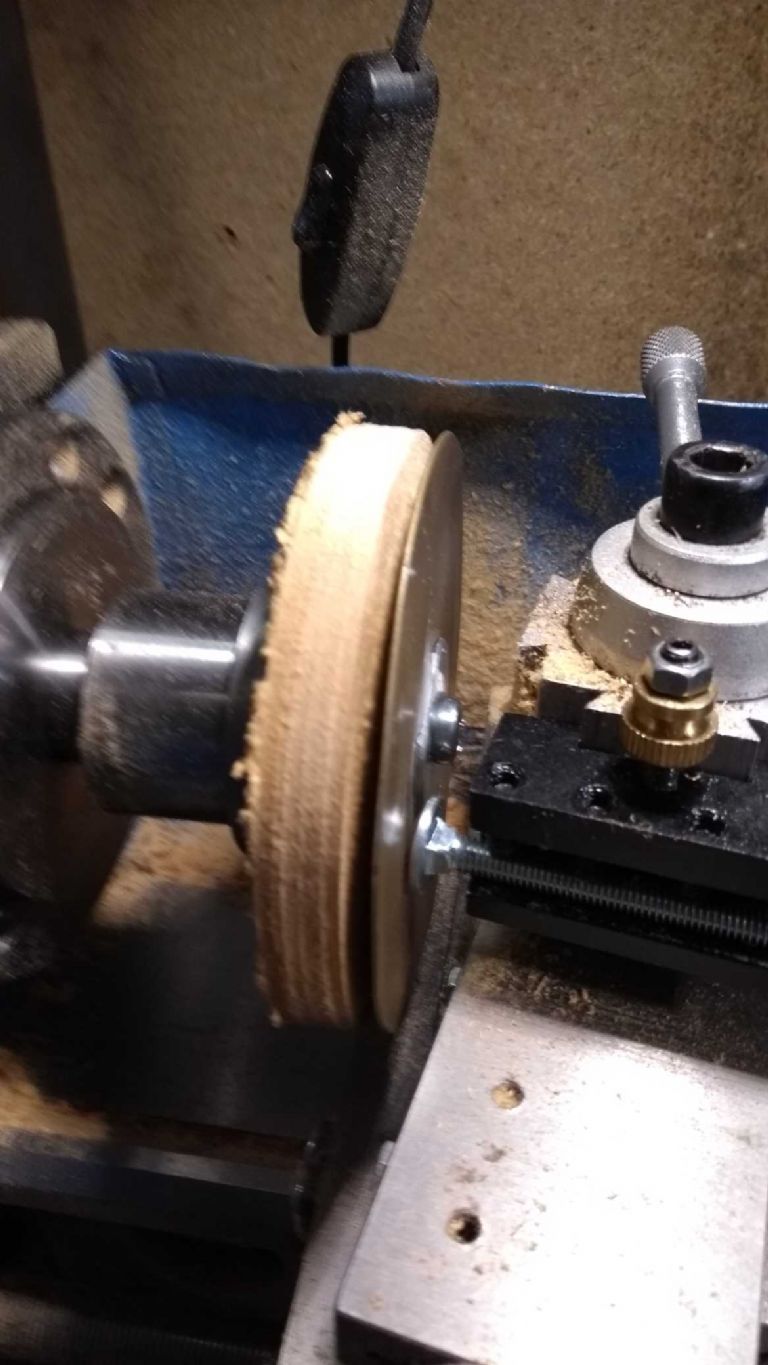

      I mounted the brass place more or less snipped to shape onto a piece of ply and bolted it to the MT3 thing (is that an arbour of sorts?).
      That worked really rather well (always a bad sign).

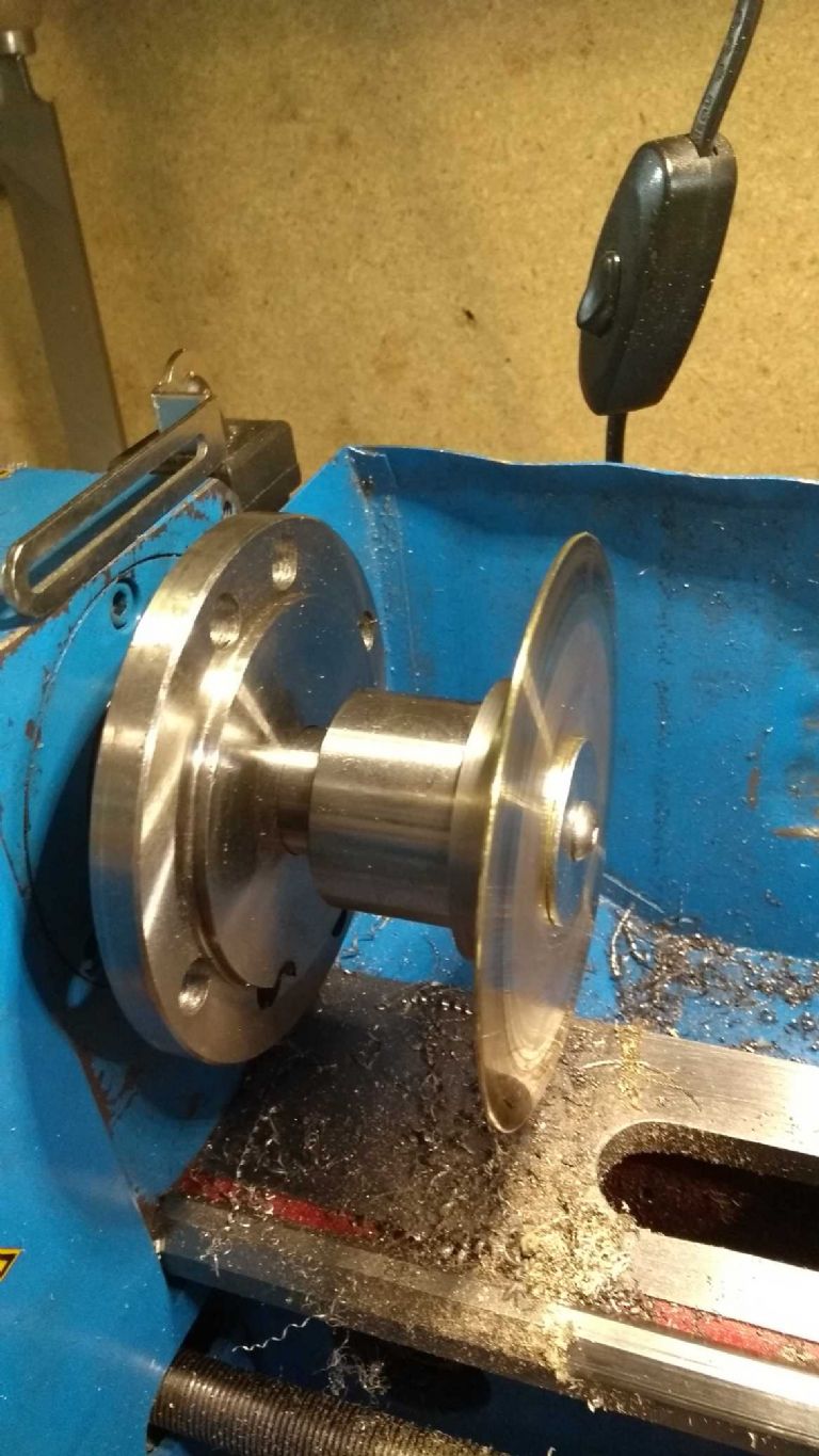

      Next took the wood back off, bolted the plate back on, turn the speed up to high and tried to reshape it.
      Somehow, it's managed to have almost no effect except to buckle the plate very slightly out of flat (1mm or so).
      I can get a curve out of the brass with my pusher as it spins (first a spanner end and then a hammer shaft to get a bit of leverage), but it always springs back (apart from the buckle I've somehow put in). The curve looks to be around 10 – 15 mm at the edge so it's a fair amount.

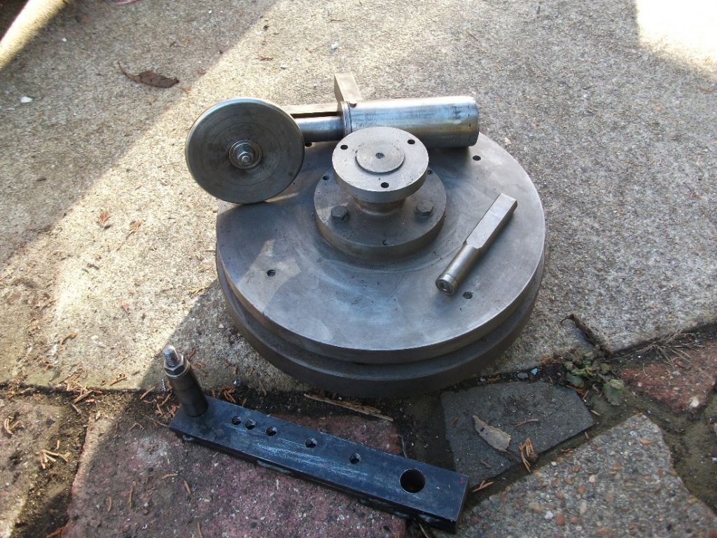

            Hi Iain,

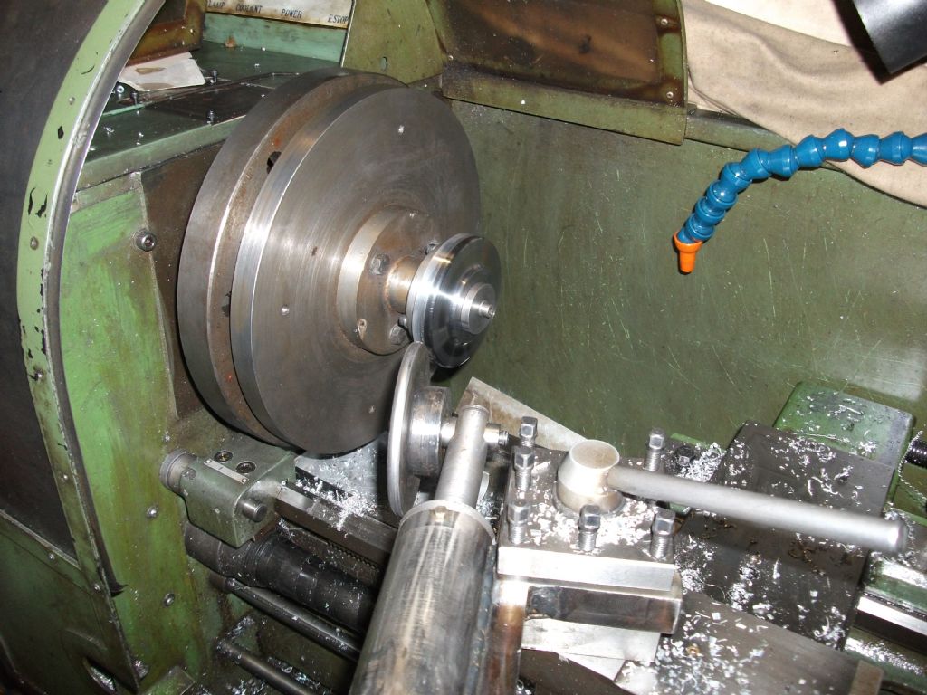

            Try annealing the brass before spinning,carefully heat all over to nearly red and
            allow to cool.I use a wheel type of tool ,the one in the photo is about 4 inch in diameter.For inside edges
            or sharp forms a mounted ballrace can be used as seen on right hand side.

              Hi Iain ,
              Here is a better view of the spinning tool making something similar to
              what you are doing ,material is stainless steel.

                      Well it does depend on who you bought it from at Ally Pally but I would say it's 95% likely you have a hard brass like CZ120 which will be difficult to spin even if annelaed, half hadd CZ108 would be a bit better as that is whats used when you need to bend it such as loco and traction engine tenders. Best for the job would be actual spinning brass CZ106 which is even softer.
                      3mm thick is also going to need a hell of a lot of force to spin, try something 0.5mm to 1.0mm thick.
                      I have spun steel using a rounded hardened tool held in the toolpost, this cap on the end of the cylinder was done that way and for a one off easier than making a load of spinning tools and rests.

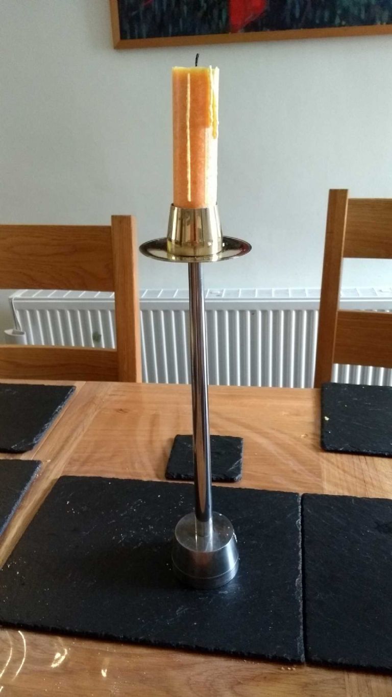

                                OK. Kind of success….
                                So I ordered some CZ106, but then realised that the disc was actually only 1mm thick, so I decided to carry on with that. I borrowed a blowtorch from a chum and found some firebricks I'd bought earlier. So two mistakes there. I suspect sticking with the original brass has made things more challenging and the firebricks are for a hearth so designed to absorb not reflect heat. I had the devils own job getting it red when it was touching the brocks.
                                The first time round I was freestyling. This time I made a former and used the topslide with a bolt in to apply pressure.
                                The main challenge with that was that at 10 degrees the cross and topslide were too close together so I had to take the handles off and turn with an allen key.

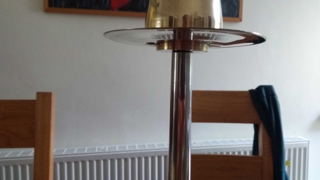

                                I had to anneal 4 times to get close to what I wanted. In the end I gave up with getting a cone and settled for a sort of saucer.
                                You can see the profile above
                                So it's worked and I've learned loads of stuff. and the candlestick now has a catcher.
                                Unfortunately, the catcher hasn't really added to the aesthetics of the stick and the form and finish are a way off perfect.
                                So success, but it could have been better. I can add spinning to the list of things I can do at a mediocre level in the shop. smiley
                                Many thanks for all the advice.
