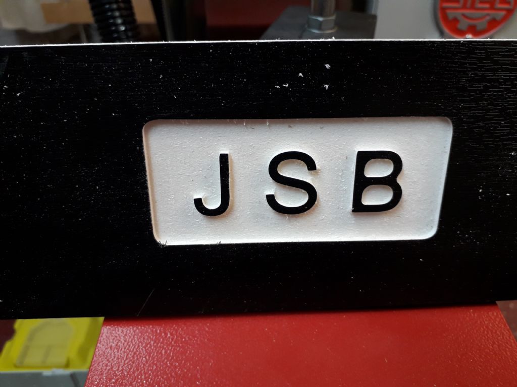

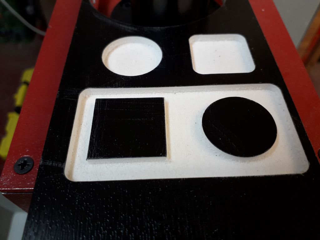

                                If it is fairly flat the offcuts of UPVC facia board work well, thats what i did some of my first cut in. This was a black surfaced one which shows the cuts well

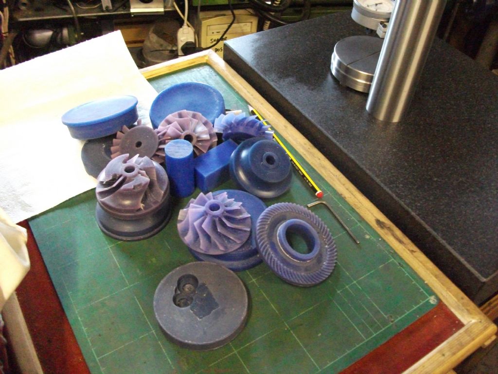

                                      You could try this from Artisan Foundry Shop
                                      https://www.artisanfoundry.co.uk/
                                      Artisan Foundry
                                      7 Baileys Lane
                                      Hale Village
                                      Liverpool L24 5RG
                                      P: 0151 425 2376
                                      E: [email protected]
                                      MOULD CASTING WAX 1KG FOR LOST WAX INVESTMENT CASTING
                                      £ 8.99
                                      It looks like the same wax that i use just a different colour .I collect the swarf
                                      and re- melt it into usable shapes.Some machined and re-melted parts here .

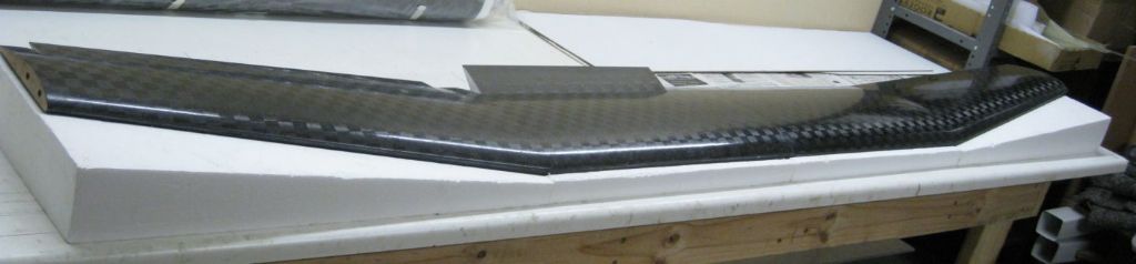

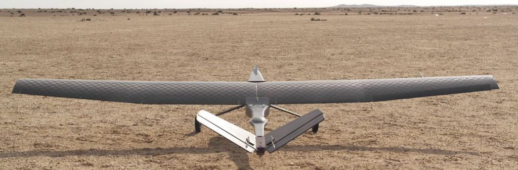

                                                I use Corian , A DuPont product – a material consisting of an acrylic polymer and alumina trihydrate. It is extensively used for kitchen counter tops and such like. It machines very well, with conventional milling cutters, carbide mills ( last longer) and Wood Router cutters. It holds sharp edges very, and polishes up to a near gloss – one or two wax coats and glass/carbon composites with laminating resin de-bond very easily.
                                                The definition achieved with Corian allows really sharp, fine wing trailing edges in a two part ( top and bottom) wing mold.
                                                For smaller projects ( the wings below are 3meter span..) many kitchen Installers will give you off-cuts of the stuff. really very nice to work with, although an errant tool path will still break the cutter…
                                                Machining does create fine dust though.
                                                Joe

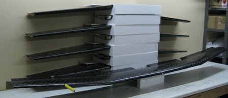

                                                The tooling board is more stable than aluminium when cut, there is not much stress in it (not stress free though) the tooling board machines faster on large gantry type CNC machines, the tooling block finishes easier by some margin than aluminium, both in rubbing down and sealing/painting. The tooling block is easy to bond into big lumps to make things like F1 chassis patterns or model aircraft wing patterns.
                                                Apart from that aluminium is pretty good. Horses for courses as they say.
