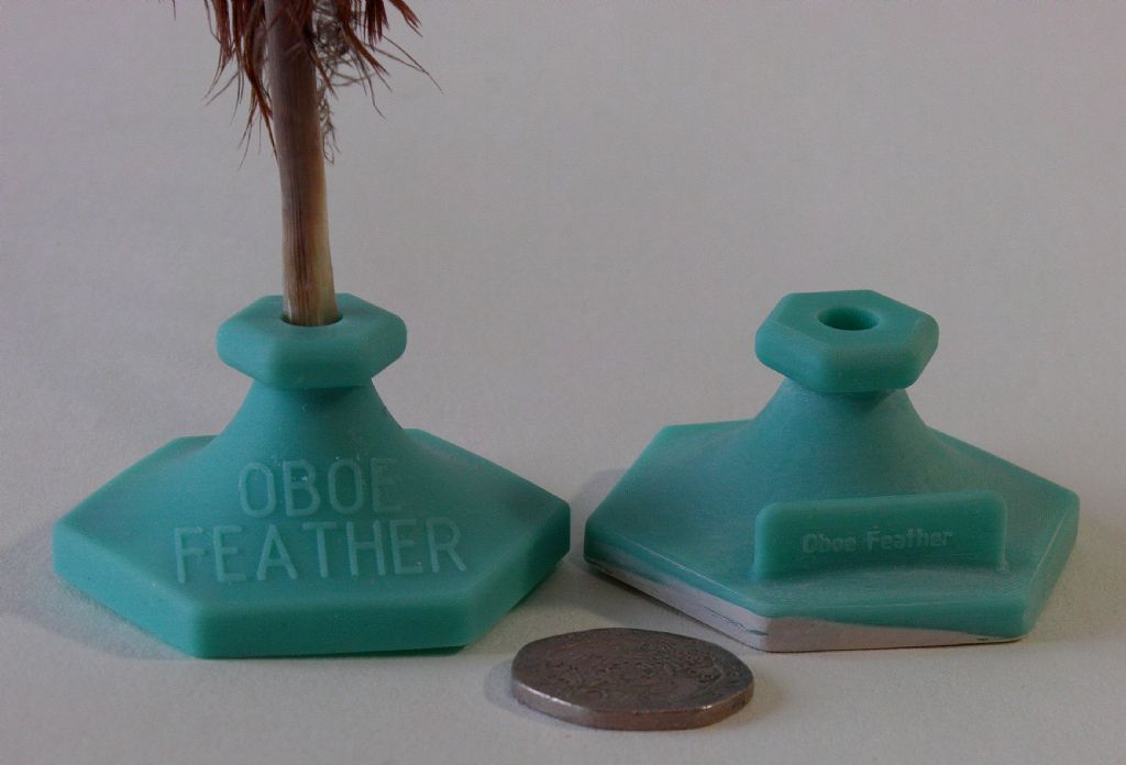

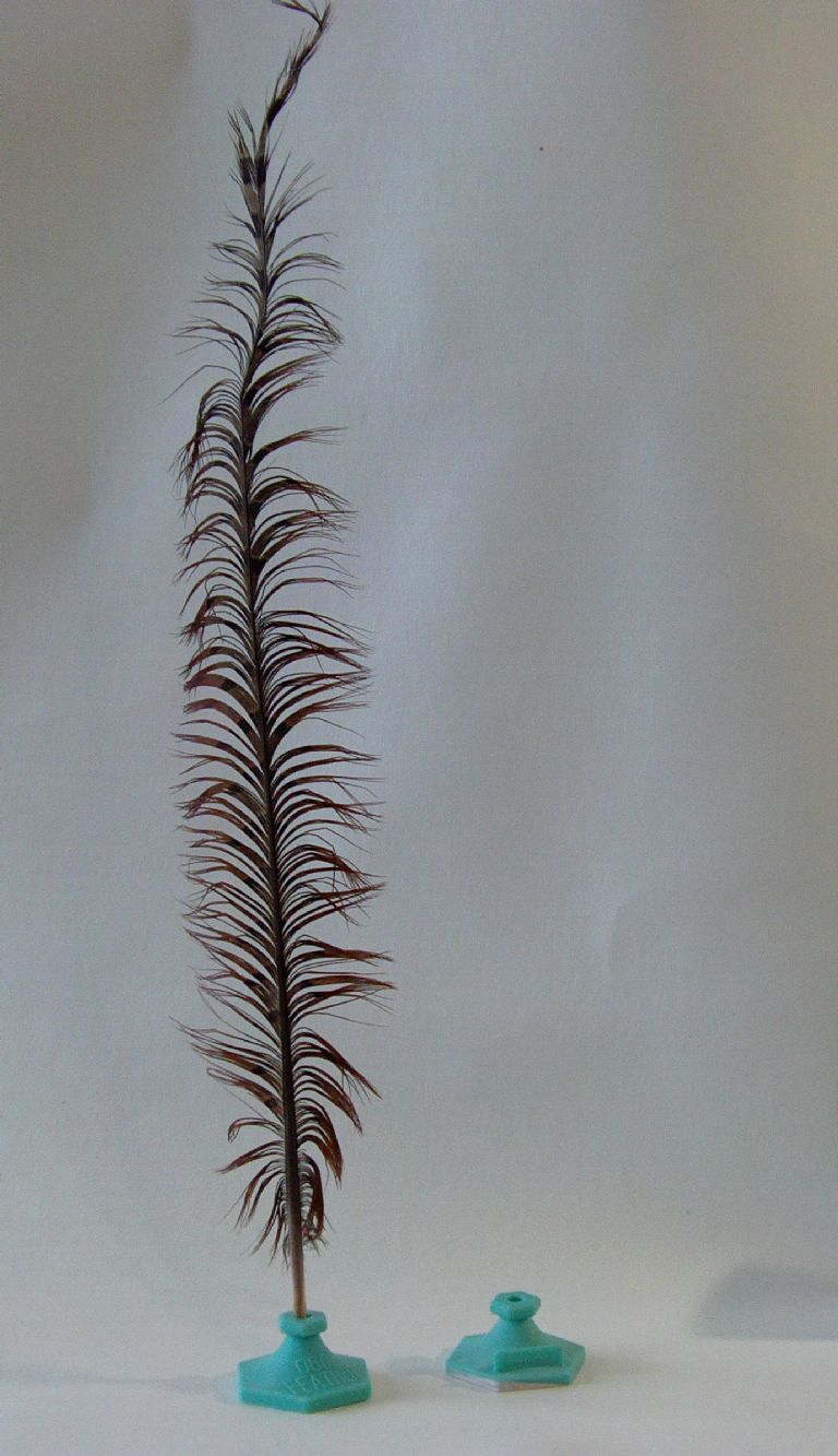

                      lee webster
                        @leewebster72680
                        Thanks Ian, I will watch the video soon. Even though I don't do many designs in SE, I did do this.
                        I have used a twenty pence for scale. The stand on the right was designed in Designspark. I used it to display a feather used to clean the inside of an oboe belonging to a friend. I didn't like the text on it so I tried designing it in SE. I had much better control of the text, it's position and extrusion. I can't say it was easy, but I did it! I had a partial fail 3D printing the first stand and I had to repair it with car filler. I will paint the SE stand, not sure what colour, and painting the text in a contrasting colour will be easier thanks to its size.
                        Lee
