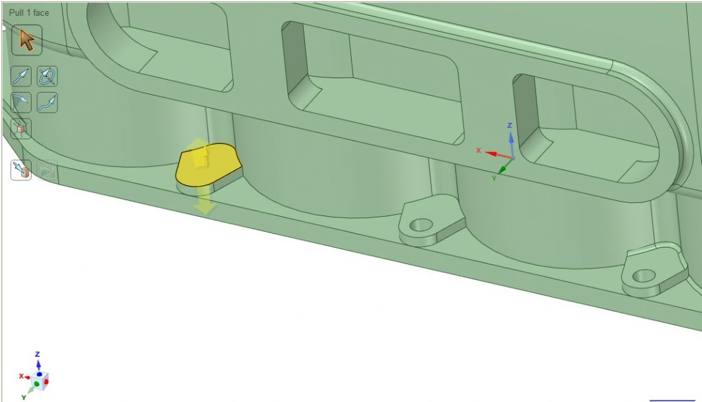

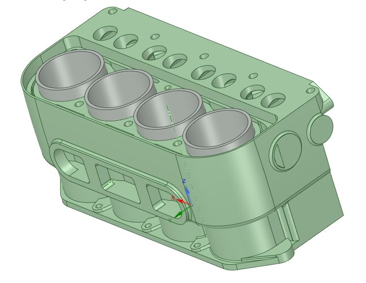

                    This image shows a surface in Design Spark 5 that I want to sketch on. The surface is highlighted.
                    This image shows the surface visible from the top of the cylinder block, no other detail visible.

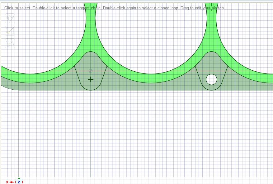

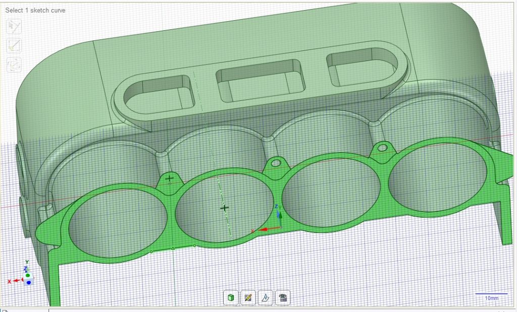

                    I start a sketch on the surface and the block is automatically "clipped" so that everything is visible.
                    I can rotate the part so that I can see the other side of the drawing plane and copy reference points from it.
                    I have drawn the stud hole and cut it out. The block is the active body, green, and the cylinder liners are inactive, grey.

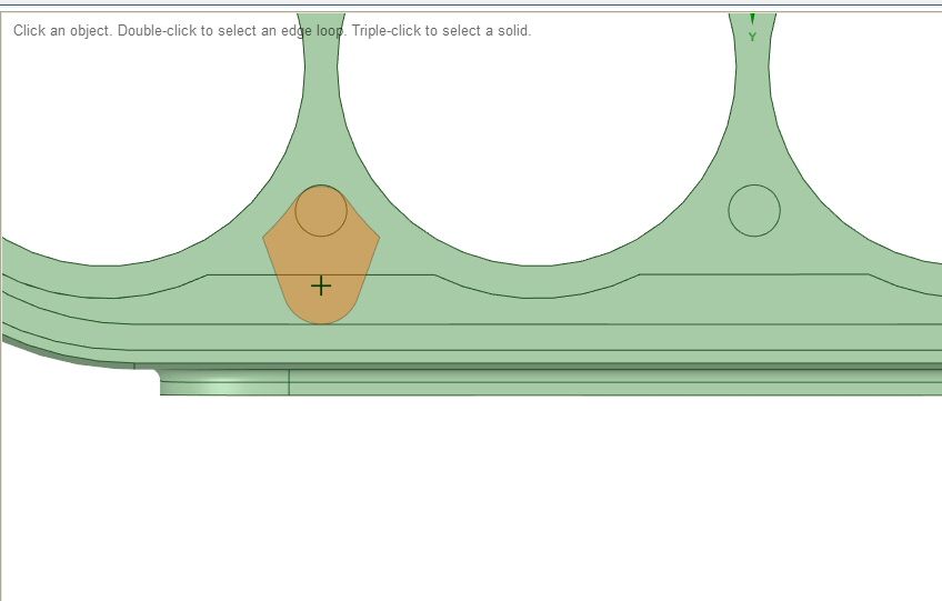

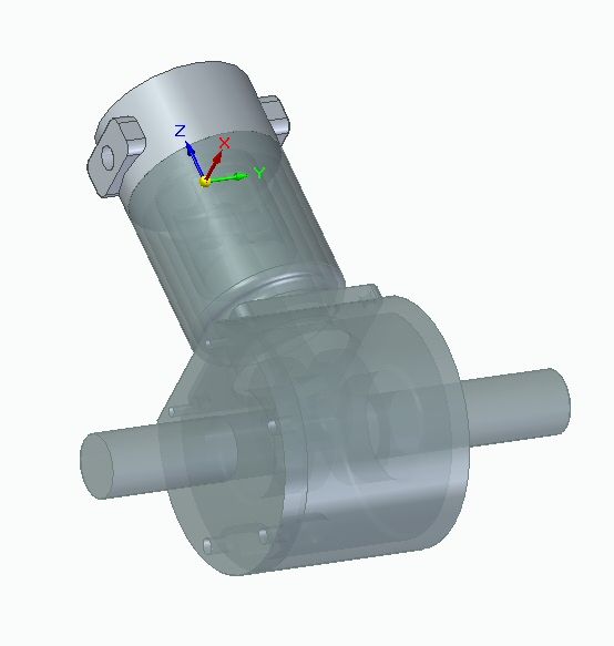

                    I do the same in Solid Edge to a simple engine, but can't see the surface to sketch on without hiding other parts. If I had drawn the same block in SE, It would have been very hard to draw the stud hole.
                    I select a surface to sketch on.
                    I can't see the surface.
                    Is there any way of automatically clipping the part at the sketch plane? I know I can add clip views, but that could get very messy.

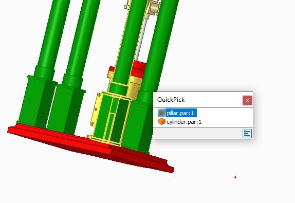

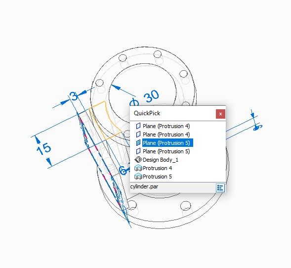

                          SE is similar, but I agree it's less obvious. The software has a number of ways of selecting faces. For example, this engine, a recreation of one of Jason's, is an Assembly. In this view the part I want to work on, the cylinder, is hidden behind a pillar:

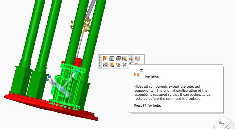

                          If I hover the mouse over the area, after a brief pause, the Quickpick menu appears. It lists all the features under the mouse and any of them can be selected. Of the two above, I click on the cylinder, but the pillar is still in the way:

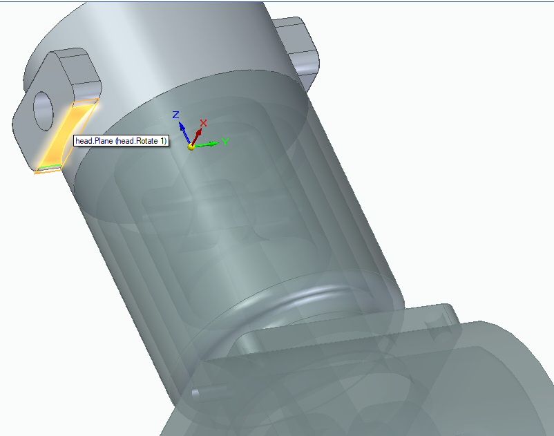

                          However, another menu opens with a bunch of buttons, one of which is 'isolate'. Pressing it hides everything bit the wanted part:

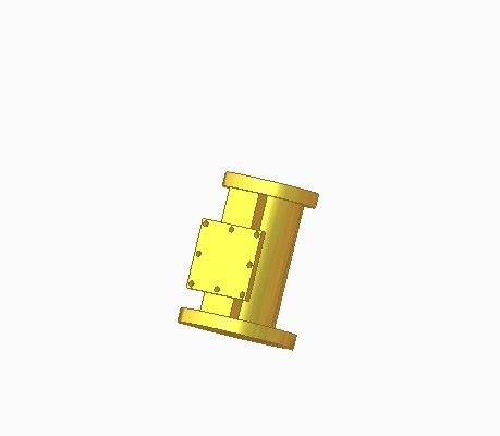

                          As can be seen the valve plate is unfinished, but so also are some internal details inside the cylinder. I can reveal more by switching into line view. This also allows quickpick, so I can select a face inside the cylinder. It's the one outlined below in yellow, 'Plane (Protrusion 5), which I can draw on:
                          When drawing, the upper part of the cylinder is still visible in line view, but it can hidden with the Show and Hide commands.
                          Bit clunky I feel, but it can be done. A bit of problem with SE is exactly how stuff works might depend on which menu is active. I found SE harder to learn than Fusion and FreeCAD but it's OK now I'm used to it. Comparing CAD packages can be tricky, swings and roundabouts. For example, even though I consider Fusion better organised than SE, SE's synchronmous mode gives it an edge in many circumstances. But having synchronous and ordered modes makes learning SE more complicated.

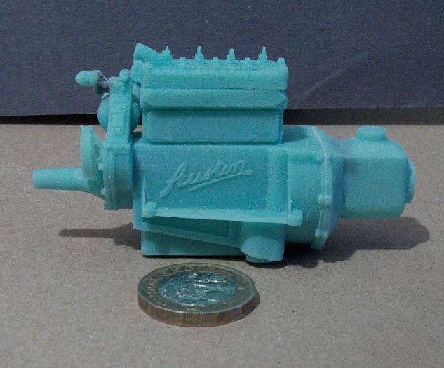

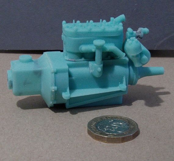

                            I took a break from trying to cast metal and started to design a one tenth scale model of my Austin Seven car in DS5. This is the 1/10th engine 3D printed in resin. I wont be using the engine in the model as I have decided on a closed bonnet model to simplify things. One pound coin for scale. The 3D print is made up of 8 pieces.
                            The block and head are printed separately and aren't glued on until they are painted.
                            I really did try with SE, but we don't get on.

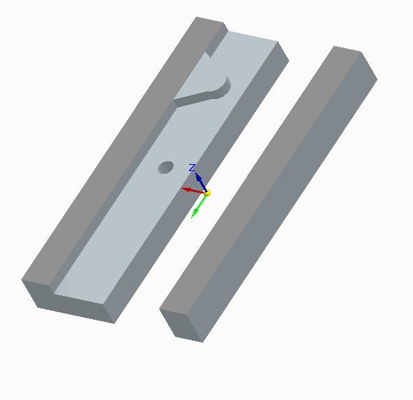

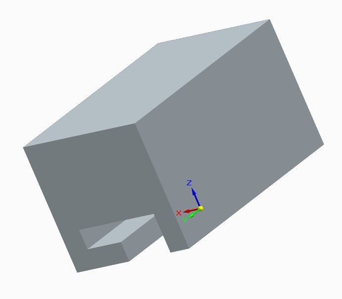

                                          I'm grateful to Ian for identifying a Solid Edge problem I didn't know I had! I think it's because I've never drawn an object like Ian's engine in that way, but it's a valid way to do business.
                                          Although SE can select and work on hidden surfaces, it doesn't automatically hide what's in the way. Unless someone knows better, it seems you have to set up clipping panes (a 3-step process in the View menu), and show the slice, which can be worked on in the usual way.
                                          I created this slotted box, so I could work on the inside:
                                          Setting planes allow this temporary view, temporarily hiding whatever is above. I drilled a hole and extruded the raised platform:
                                          Turning the clip off reveals the whole item, with the new features on the shelf:
                                          Be nice to have a single button that rendered everything above a plane invisible. I suspect the 'set planes clip' method is more general purpose than that and does other useful things as well. Needs to be explored further.
