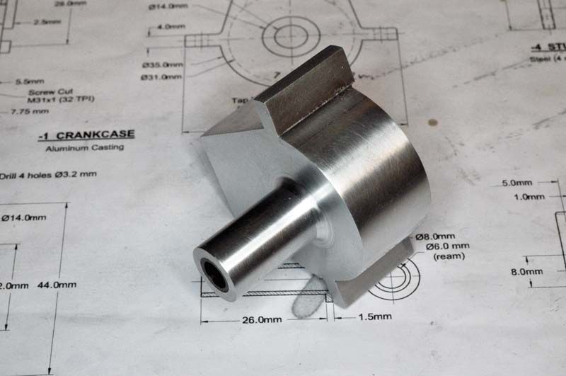

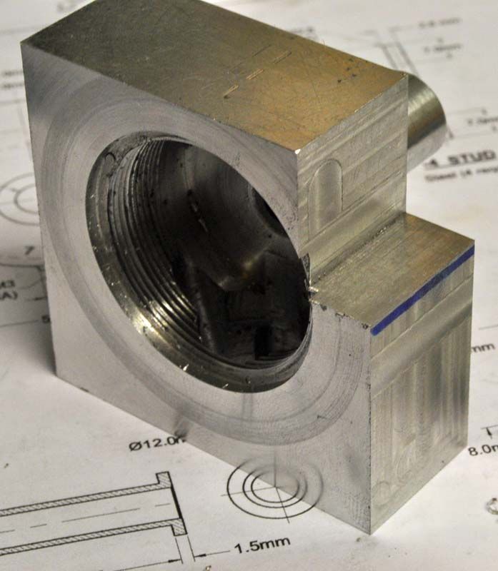

      Hi all – I need to carry out a largely cosmetic repair on an aluminium casting as a result of a being a little too hasty on the milling machine. Essentially it would a (small) gap filling exercise but before resulting to using Araldite or similiar I would like to explore the possibilities of a soft solder repair as it would be a good excuse to try a new (to me) technique. Has anyone had any experience of soldering alumimiun and able to offer some suitable suggestions, e.g source of alloy, soldering tools etc. required for the job?

                              A lot of very useful help and advice given here – Thanks for that. It would appear that my best options would be to use either the Lumiweld 5 rod + Wire Brush Kit or to try Alsol, the flux cored solder sold by Cup Alloys. I should have said that the cosmetic treatment involves filling a line gap from the inside of a concave shell casting typically 0.020" thick x 1" long which after soldering would be filed down to maintain the external profile.

                                  Given the fact that there is not a lot of parent material around the line gap perhaps the best option would be the CUP Alloys Type Alusol flux cored solder having a melting range of 178 to 287deg C, quite adequate for what I have in mind provided that it 'sticks' to the casting

                                    That sounds like the safest option, vee the crack if you are going to file down to the surrounding surface, hope it goes well for you.

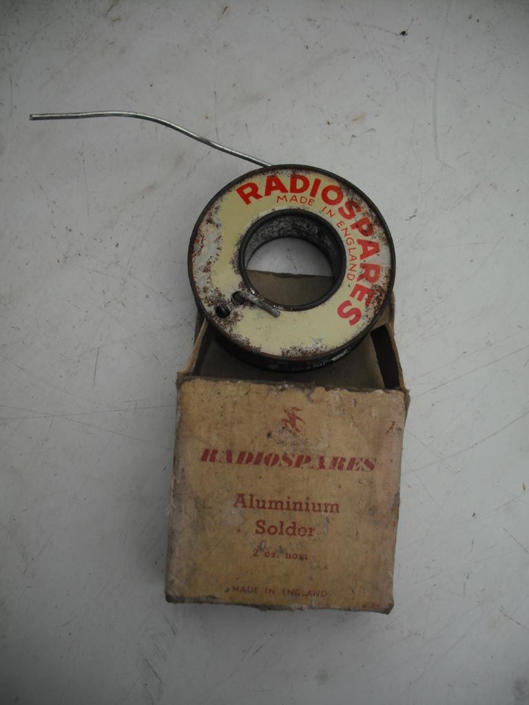

                                                  I found this in my drawer of soldering stuff. I've had it for a few years and haven't tried it lately, so I don't know if it still works. I haven't checked the RS site to see if they still sell it.ally_solder.jpg
