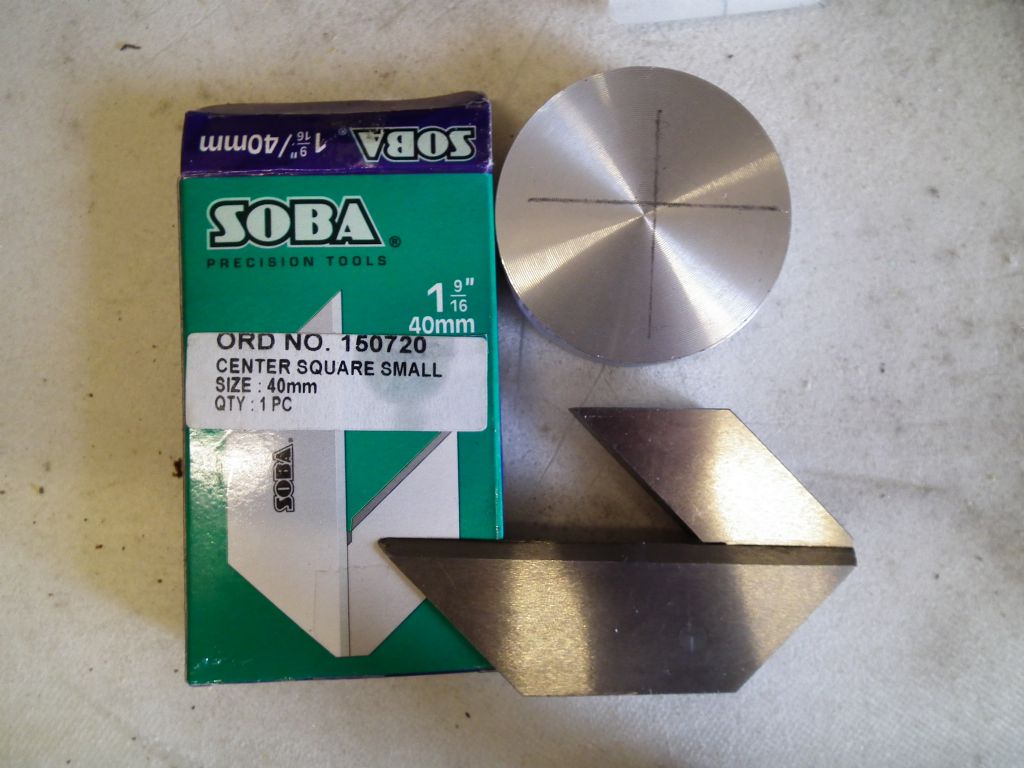

      Hi,
      After spending an exellent day at the Harrogate mex ,I bought this centre square from one of the stalls. As you can see from the picture it does not quite live up to the promise on the packet it came in. I think I could have made a better job out of lollypop sticks using a knife and fork! grrrr angry 2.
      Oh well there are many stories like this I'm sure .
      Regards OM (aka Victor Meldrew).

          Hi oil magnet.
          You can still use it although I would send it back for a replacement including cost of postage.
          Draw four lines at 90 degrees.
          The centre is in the small square in the middle.
          regards david

            Les Jones 1
              @lesjones1
              Are you sure that it is the straight parts of the square are contacting the bar annd not just the tips. Looking at the picture the bar looks to be on the limit of the capacity of this square. If the square is the fault it is a very large error in manufacturing. I was looking at some 90 Deg. squares on a stand at Harrogate and they were well off square. I finished up buying a Soba one which I could not check at the time as it was in a sealed box. It did turn out to be OK.
              Les.

                Martin W
                  @martinw
                  Hi
                  Just out of interest I transferred your picture of said centre finder into my drawing package and measured the included angle between the blade and the exposed leg. This turned out to be within 0.5 degrees of 45 degrees. While not a particularly accurate way to check things it does indicate that the error you are getting is greater than any apparent error of the finder. I support the comments by Les that the bar looks to large for the finder. Prior to sending it back I would try it out on a smaller diameter rod and see if the same error exists there.
                  Cheers
                  Martin
                  Superimposed the bar/rod onto the finder and it should fit between the legs albeit a bit close but should be OK . A quick measurement fom the photo on the drawing package supports this with the legs measuring, from photo, 50mm and the radius of the bar/rod 38mm. Not true world but gives a relative measurement that confirms clearancewink

                    #91086
                    Oil Magnet
                      @oilmagnet
                      Hi ,
                      Thats a scary thought njh, 2 billion cock ups every friday afternoon !.
                      The error is just as bad on smaller diameters, I used a larger one one just for the photo.

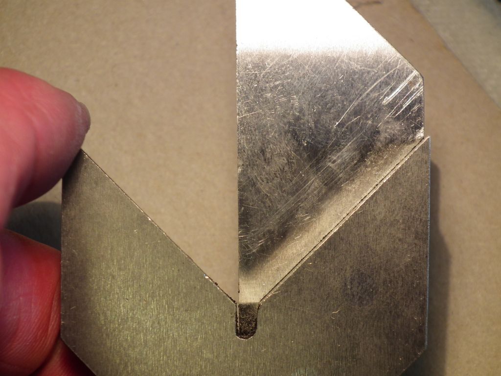

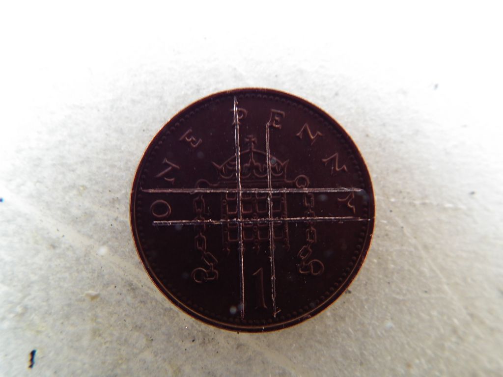

                            Oil Magnet
                              @oilmagnet
                              Hi all,
                              Just unlucky this time I guess. Its only a small item so more annoying than anything else.
                              Two more pics, the penny shows the square remedy suggested by DavidClark1, and the other showshow badly offset the scribbing arm is.
                              Thanks for the interest
                              Regards om

                              #91117
                              David Clark 13
                                @davidclark13
                                Hi There
                                You should be able to file or mill that true.
                                You don't need to go right into the vee, just far enough.
                                regards David

                                    #91125
                                    Richard Parsons
                                      @richardparsons61721
                                      Oil Magnet if I may suggest go to your local trading standards officer (if they are not in conference (aka down the pub). This is totally contrary to the Sale of Good Act as it is “NOT of merchantable quality and fit for the purposes for which it was intended” i.e. to mark the centre of a round item.
                                      Mind you if they were anything like the lot where I used to live you could NEVER contact them!
                                      rdgs
                                      Dick

                                          #91138
                                          Versaboss
                                            @versaboss
                                            Posted by David Clark 1 on 18/05/2012 16:15:57:
                                            If I'm not completely off my shoes, this would rather need the mysterious putting-on tool than milling something off (and making the error even larger).
                                            But who knows, maybe I am…
                                            Greetings, Hansrudolf

                                            Nicholas Farr
                                              @nicholasfarr14254
                                              Posted by Versaboss on 18/05/2012 22:13:23:
                                              Hi Hansrudolf, take another look at OM's close up photo of the square, it clearly shows that the marking off blade is over the centre point of the vee, hence the need to cut some off.
                                              Regards Nick.

                                                Versaboss
                                                  @versaboss
                                                  I agree… crying
                                                  To my excuse: not knowing this instrument, I thought the shiny surface was from the part which has to be marked.
                                                  Ashamedly hiding in a corner,
                                                  Hansrudolf

                                                  Chris Trice
                                                    @christrice43267
                                                    Hi There
                                                    regards David
                                                    No, you shouldn't have to. Send it back or there's no incentive for suppliers to supply decent tooling. If you try to modify it and screw it up, you can't return it and you've lost your money.
                                                    #91212
                                                    Tony Pratt 1
                                                      @tonypratt1
                                                      Send the heap of scrap back! Our manufacturers were screwed by cheap Eastern goods, now they are gone the suppliers left will have to come up with the necessary quality, don't accept rubbish!
