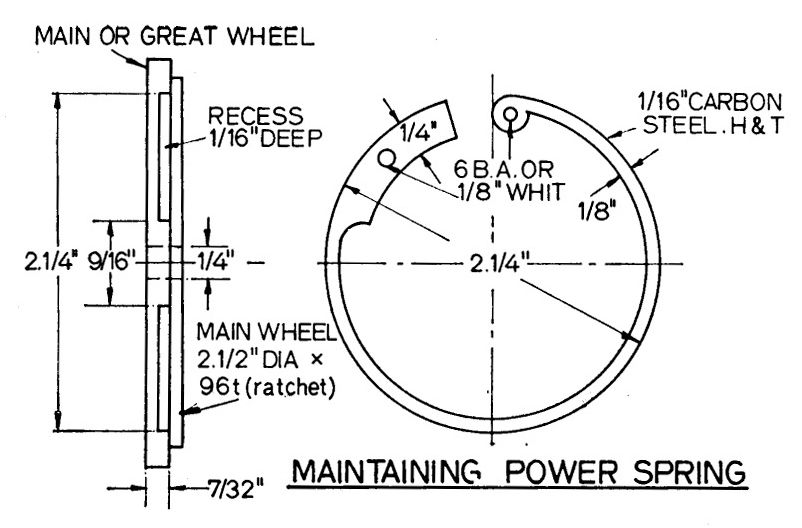

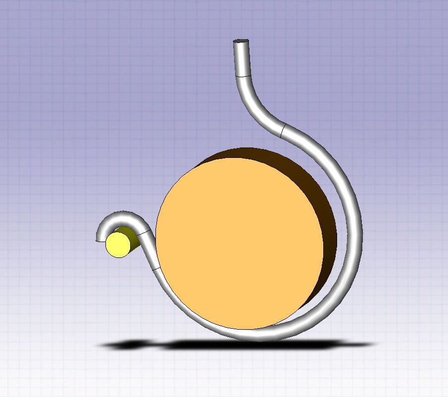

                                  Sam Stones
                                    @samstones42903
                                    Derek,
                                    I’m guessing the Wilding maintaining spring looks like this, and relies on support from the central boss.
                                    Of course this one shows round wire whereas yours is square in section.
                                    John Stevens cut his from an old 1/16” slitting saw which he annealed before filing to shape. Lots more work than plain rod/wire.
                                    He then followed up with H & T (harden and temper) to blue.
                                    I chose gauge plate (high carbon steel similar to silver steel in terms of carbon content), before hardening and tempering.

                                    derek hall 1
                                      @derekhall1
                                      Hi all
                                      Well today I tackled this strange looking spring, its exactly like Sam's first picture above. I had to file down some 1/8 square silver steel and then made a bending jig and practised using 1/16 round soft copper wire.
                                      Using the copper wire gave an approx length of silver steel needed for the spring. I first heated the silver steel to red hot and allowed it to cool naturally in still air. I then heated it to red heat where I needed to put in the bends around the jig.
                                      I all went very well to be honest. Thanks to all of you for your advice.
                                      So one other question this spring needs to be hardened and tempered. So obviously heating to red hot and quenching in oil or water, what sort of colour should i temper the spring down to?

                                            That looks a lot like an internal circlip, can you adapt one rather than making from scratch?
                                            #353946
                                            Sam Stones
                                              @samstones42903
                                              Duncan, I'd reckon you could. Mr Stevens used an old 1/16" slitting saw blade.
                                              Loosely wrapped around a central boss however, the spring Derek is making becomes rapidly stiffer as torque wraps it around the boss.
                                              The spring shown in Mr Stevens' drawing is only supported sideways; nothing in the middle. Also, and as I found out from my (one and only) clock, there isn't sufficient stiffness in Mr Stevens' maintaining spring to keep the clock running for more than fifteen seconds. This is ample for its purpose, but the point being that the spring has to be stiff enough.
                                              That would bring us to simple beam theory (thickness cubed) to determine the correct spring thickness, shown as 1/8" in Mr Stevens' drawing.
