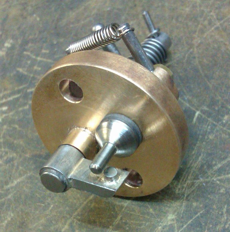

      As the title suggests for the ignitor on my 1/3rd scale Galloway hit & miss engine I have to solder some Tungsten to mild steel. Is there anything I should watch out for?
      I intend to use Easyflow and Tenacity No5 unless you know better.
      Thanks, J

                Hi Jason,
                Proceed as you thought with your silver solder and flux.
                Keep joint gaps small say 2-3 thou.
                Use propane to heat so you get good all-round heating of the joint.
                Allow to cool slowly.

                PS Same approach when brazing/silver soldering of small pieces of carbide

                  Thanks for all the replies particularly Keith.
                  I the past I have used carbide from blunt cutters but as this one needed 3/32" rod the suggested TIG electrodes seemed the better option and I just wanted to know if the lack of carbon in the metal needed a different approach.
                  As you can see the small round contact on the hammer wetted well, the longer rod comming out of the conical part not quite so well but I could not pull or twist it out so must be OK.
                  For those that are not sure how an ignitor works this shows it being tripped by the pushrod.
