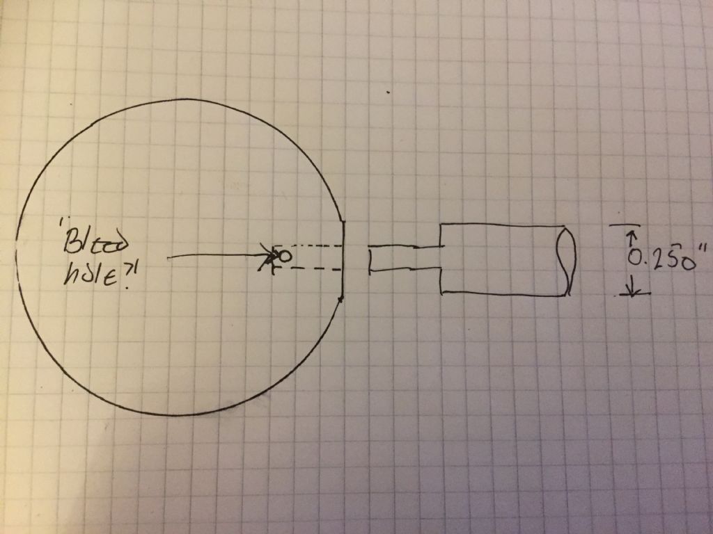

        I want to make a joint between a brass disc and a stainless rod: something like this:
        Questions are:
        (a) If I flux the parts, assemble and feed solder (455 / aka silver flo 55) from the shoulder of the tenon, would capillary forces draw the solder into the blind joint, or should I make a 'bleed hole' as shown in the sketch?
        (b) Would it be better to 'tin' the tenon first, flux everything, then assemble and heat? I've never tried tinning with silver solder, so don't know if it's an OK technique.
        Or (c) is this an 'if I were going there I wouldn't start from here' question?
        Any advice appreciated,
        Robin

          Two options [slight variation on a theme] that I believe are much more likely to succeed than (a)
          Place paillons of solder, or a ring of thin solder wire, [with flux] at the end of the blind hole; insert the rod; and heat.
          … A combination of gravity and capilliary action should do the trick.

            Just be aware if you mix your flux with water and the hole is blind when the water boils off it will push the rod out. You can get over that by putting in a hole as you show or filing a small flat on the side of the rod to give the pressure a path to relieve through. I do a similar job on the canopy support for my traction engine at least once a year, soldering a 3/16" pin into some 5/16" square bar and I know the solder works its way in because I have to drill out the pin when it shears off flush! (It's a carp design but there is not another way to do it that looks good and still allows easy removal of the canopy so I accept its a consumable item and renew when it breaks!).

                I'd go with the small flat filed onto the pin to let any steam out and that will help the solder in. Also apply your heat to the large disk which will also help as the solder will flow towards the hotter material.

                  Michael's approach is underestimated- it will work!
                  It simplifies the heating process by creating the ideal heat pattern to promote that all important capillary flow. When the 455 melts and flows, the capillary forces will centre the spigot in the hole.
                  The weight of the spigot and the capillary forces will ensure that the spigot sinks into the hole. Just make sure that your joint design allows for this.
                  No need to file flats on the spigot or worry about steam or flux entrapment.
                  Michael's approach underlines the simplicity of the silver soldering process when it is done correctly.

                          Thanks for replies. I shall try the method suggested by MichaelG and endorsed by Keith@CuP. By doing it that way I can be fairly sure that if I see an even ring of solder emerge at the shoulder of the joint the internal surfaces have been properly wetted. A bit like using Yorkshire rather than end-feed fittings in plumbing I suppose.
                          The disc is thick enough to allow a threaded joint, but that is difficult because (I didn't tell you this – sorry!) there will be another similar disc at the other end of the stainless rod, and the two discs need to be coplanar. I have done it this way in the past, using a locking nut at one end of the rod, but even with threadlock the joint has failed. The joints are subject to both and axial shear and torsional forces – the torsional forces were strong enough to loosen the thread . I have also tried retainer on an unthreaded spigot, but that has also eventually failed. Maybe I used the wrong adhesives, or perhaps my technique was poor.

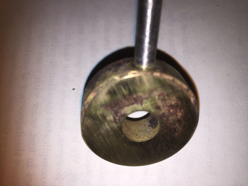

                                Other things having intervened as they inevitably do, I've only just got round to trying the paillon method Michael suggested. This is a poor photo (I rue the day I 'upgraded' to an iPhone!) of a test using scrap pieces:
                                Despite the poor focus you may be able to see that the solder migrated from the bottom of the blind hole and has wetted the stainless – there's actually a reasonable fillet as well. So thumbs up for this technique!
                                This is nominal 5mm stainless in a hole drilled with a 5mm bit. . As best as I could measure the stainless was 4.974 mm and the hole 5.015mm. Plus or minus a tad obviously*, but rather less than the minimum clearance recommended in the CuP guidelines. Anyhow it works!
                                I heated very gently at first to dry the T5 flux paste, no problems with steam forcing the thing apart.

                                    A couple of years ago I tried a "tinned" silver soldered joint to see if it worked. It was successful and good. But for the life of me I have not idea why one would ever use such a technique!
