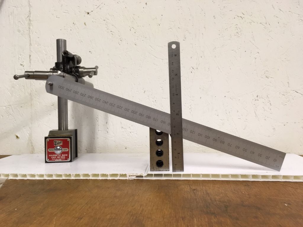

                    I guess you should start by "how to measure the included angle of a little detent". please.
                    edit: and the width, without special tools like digital angle gauges.

                      Nice try. About where I started before realising just how many ways of getting it wrong there were. Actually this turned out to be one of those time when doing it the right way is actually quicker and easier than diving in knife'n fork style. If you don't count the (painful) time taken in figuring out the right way of course.
                      Bazyle
                      Without special tools eh! I guess that means a gear tooth vernier is out then. Pity, been looking for a good excuse to use mine ever since I got it over 30 years ago.
                      Never mind the poor-boys' bevel protractor substitute will work just fine. Looks like I've got to take the indexing lever off to photograph the set-up even though careful use of a vernier with good knife edge jaws did it for me.

                            Had a spare half hour before tea so I quickly mocked up the Poor Boys Bevel Protractor device for measuring smallish taper angles. Basically two rulers. One supported at the end so it lies alongside the taper to be measured and one held vertically. Make two vertical measurements a suitable distance apart. Subtract small one from larger and divide by the separation measured along the sloping ruler. Result is the sine of the taper angle.
                            If you are careful and have a decent separation between measurements the accuracy is more than good enough for many purposes.
                            I used a magnetic base and one of my "ruff" 1-2-3 blocks for the picture as being immediately to hand but that's absolutely the high end sophisticated version. Especially as there is a weak bar magnet on the 1-2-3 block holding the rulers stable.
                            Does that meet the without special tools criteria?
                            Clive.

                                  That's rather neat Clive. I like the way you hung the rule using it's hole. Was in Lidl today and they have digital angle gauges at a tenner I think but I prefer things that don't use batteries.

                                        As Ian says the Poor Boys Bevel Protractor is a very old idea. Probably the grizzled old machinist who showed it to Ian 40 years ago was similarly shown it 40 years further back by a grizzled old …. etc, etc. Odds are that the guys who built the pyramids had a version in their tool kits. Almost certainly more names and variations than could be conveniently counted. Understandably being an ad hoc device made from what you have to hand. My father showed it to me using a pair of folding carpenters rules back when I was hardly tall enough to see over the table.
                                        Can be decently accurate. Consider measuring 30° with nominal 100 mm between vertical measurements. For practical purposes ± 0.5 mm on both spacing and verticals corresponds to ± 0.3 degrees. Not too shabby for an improvised device. Odds are that your errors will be in same direction so probably rather better. Using the depth probe on a vernier is objectively getting silly but better still. After all the thing is basically a sine bar.
                                        One great, and often overlooked advantage of old style analogue instrumentation is that you are largely in control of accuracy. Within reason. You know if quick and dirty will do or if its time to be really careful and do the best you can. Usually possible to figure out errors if need be and work around them. Digital instruments give you what they give you, quickly and repeatably. Which is great but when you get close to the limits you don't know what you have.
                                        In my view the inexpensive angle gauges, Wixley et al, are within 0.5° devices if you just plonk them on. Takes a bit more care to get accuracy and advertised resolution to match. Considering that they work by measuring the movement of a tiddly little pendulum the performance is remarkable. Especially given the very low cost. 0.1° is very little. Almost seems unreasonable that such a small pendulum can move freely and repeatably over such a tiny distance. The bigger and heavier pendulum in my Cowley level does no better, and frequently worse.
