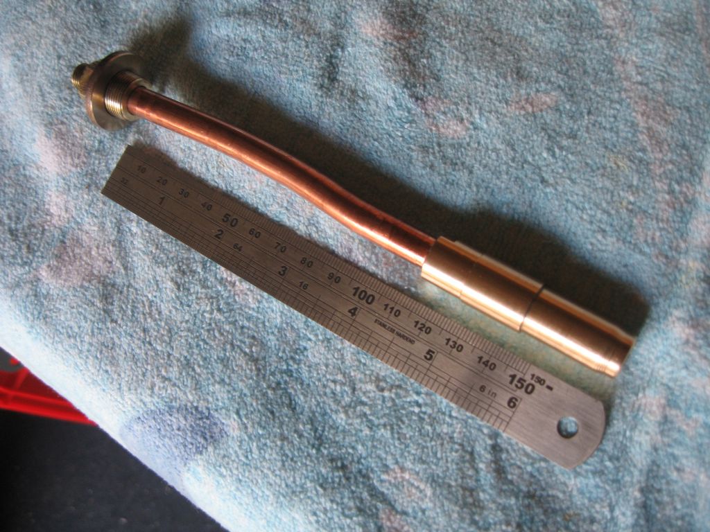

      Hello All.
      It has been necessary to replace the regulator on a 'Betty', all the parts are remade or refurbished and I now need to install these within the boiler. The original regulator does not follow the drawings, but I am trying to keep to the existing 'design and build' as much as possible. It is similar to the 'Simplex' regulator arrangement. I have three threaded connections, two are within the boiler itself and the third is in the bulkhead (smokebox end). The smallest thread is 3/8" OD. Connections are copper to bronze or bronze to bronze.
      Reference to 'Maisie – words and music' (p72) suggests using 'plumbers jointing' to make the joints steam-tight. I have a few questions relating to this.
      1) Are we talking about 'Boss White' or similar here? 2) Does it need to have hemp added? 3) Previous posts have suggested Hylomar (I assume Blue Hylomar) – which I feel more confident about as it has an aviation pedigree and possibly a higher working temperature. 4) Would you add hemp to the Hylomar – in this case?
      What does the forum think? I am open to any guidance and any alternative suggestions.
      I assume the joint sealing products and system will have to be approved by a boiler inspector, so I would welcome an inspector's point of view as well.
      Best wishes to all and 'Thank You' in advance.
      Alan.

                          Alan Donovan
                            @alandonovan54394
                            Hi all.
                            Thank you all for your input. Here is some feedback after your comments and suggestions.
                            After considering all responses I have decided to go for, what may be, a slightly unusual approach.
                            This is the refurbishment of an existing locomotive and I have found that the two bulkheads upon which the regulator mechanism is mounted are neither parallel to each other or axially inline. Therefore it has been necessary to 'manipulate' a section of the steam pipework to set the regulator housing in the correct alignment for a (hopefully) successful assembly with the regulator and stem. This requires the exact positioning of the three components that make up the regulator housing assembly.
                            Therefore I have chosen to use Hylomar with hemp packing for the two threaded joints on the copper pipe. Hylomar for the higher temperature and pressure rating and hemp to provide a 'tight fit' to the threads so that a firm but exactly positioned joint will result.
                            The finished joints were cleaned up after assembly to remove superfluous sealant and hemp to ensure it shouldn't become detached and block any steam passages.
                            All being well there should be a photo of the 'regulator housing assembly' below. The rule shows how the copper pipe has had to be manipulated to align the regulator housing (the RH end) with its mating components
                            Alan.
