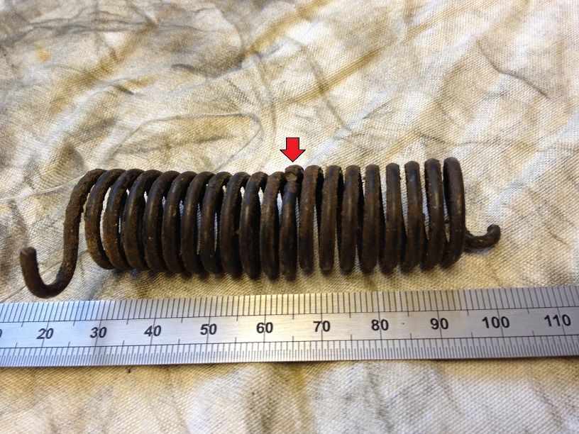

      This winter has managed to fracture the quick release return spring on my grandfather's trusty Samson Perfect No.37 vice.
      I have had a root through this site and google and seem to be unable to find out much about the vice or it's makers. Any clues for where to look? The date stamped into the casting on this one is 1940, so it's only part way through it's life yet!
      I am ideally after one that I can cannibalise, or possibly someone that can help make a replacement for the spring. Alternatively, I will look for another method to keep the pressure on the quick release plate.

            In case anyone was wondering, here is a pic of the offending item.
            Samson PerfectQR spring

                Its a torsion spring? have you looked at the sprung gate closer springs, they are torsion springs about the same diam. With a bit of heat you might be able to get good enough hooks to make it work.
                Frank

                    Time to grease the QR mechanism for you, samson vice owners . I would just butcher a spring and de-temper the end loop and bend it to the required shape. It would be interesting if you looked inside the spring at the break point to see if it had been rubbing on the shaft causing it to break at this point, normally these sorts of springs break at the sharp bends near the end.
                    Frank

                      thanks Frank. The torsion spring has broken in the center exactly as RobC's picture. Just metal fatigue I suppose after so long. I was holding back on making a spring myself but will obviously have to take the plunge. Tim

                        I found a replacement from another scrap vice in the end, Tim
