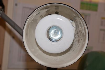

            Hi
            I have used two cheap goose neck lamps from Homebase. The halogen bulbs are protected by a separate glass cover and the lights will clamp anywhere convenient. The mains transformer is remote and plugs directly on the socket block and hence the lead to the lamp is only carrying 12V AC so is intrinsically safe.
            They are on sale for about £6 each and can be used as is or modified to suit, I have included pictures of them on my photo pages.
            Cheers
            Martin

                Hi Les
                Homebase part/stock number is 764071 and if you are really fashion conscious they do them in pink as well , usual disclaimer regarding connections with supplier. The one mounted near the mill I can move to either side depending how I am milling but the lathe one is screwed to a fixed bracket. One could always dispose of the plastic clip arrangement and mount the stem directly into something more substantial. S
                So far these have proved to be quite able to survive in this environment and when you compare the cost of these units to dedicated machine lights then there is no contest.
                Cheers
                Martin

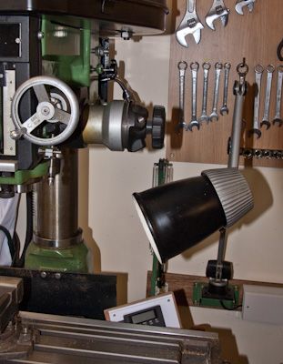

                                #68158
                                NJH
                                  @njh
                                  Hi Merry Miller
                                  Yes lots of light needed in the right place in the workshop and, in my view, a halogen light is best.
                                  When I aquired my lathe a while ago it came with a commercial low voltage(24v) industrial light. Unfortunately this was supplied from a 415 v transformer – no good to me! ( If anyone wants this they can have it for the price of the postage!) The lamp fitting however seemed too good to waste. With a little puzzling I managed to fit a halogen downlighter fitting inside the shade and fed it from a transformer which I managed to fit inside a dummy 13A double outlet box with a plain cover. ( Bottom right in pic)
                                  As I had already bought a lamp for the lathe I pressed this into service on the mill.
                                  From the end on view of the fitting you will see that the lamp is protected by a glass cover so splashes, swarf etc should be kept out.
                                  Hopefully the lamp life is good as the only downside is that changing the bulb will be a bit of a fiddle!
                                  Regards
                                  Norman
