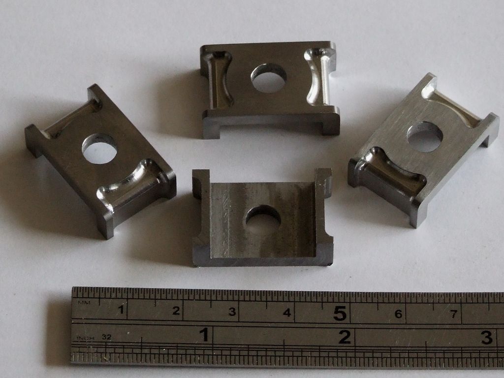

                S275 is a hot rolled low carbon steel similar to EN3B. Like EN3B it is a bit gummy and has a propensity to tear at low feeds and speeds. Drilling, tapping and reaming are fine and it grinds ok as long as one avoids loading the grinding wheel.
                I use a lot of it. Most of my traction engine motion work and many other engine items are made from hot rolled steel. Like these slidebar clamps:
                I don't worry about the mill scale. I just remove it in the course of normal machining. Anecdotally it seems less prone to rust than EN1A.
