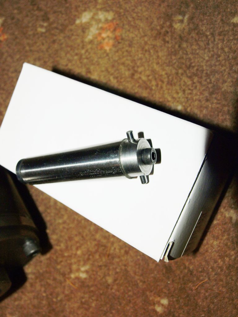

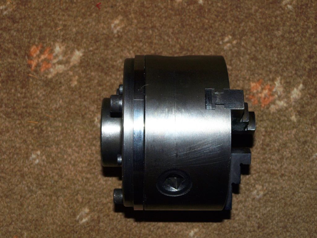

                          p2144278.jpgp2144276.jpgSafety in Reverse. This device was shown at MEX some years ago.
                          Edited By KWIL on 14/02/2021 12:58:33
                          #527134
                          KWIL
                            @kwil
                            Safety in reverse.
                            2MT adaptor with dowel
                            Intermediate backplate fitted with usual machining to hold chuck concentric. Intermediate plate bolted to backplate by 3 small bolts.Hole diameter greater than spindle bore.
                            In use, fit adaptor, fit chuck,rotate adaptor clockwise using allen key to take up any rotational movement of adaptor in dowel slots, fit drawbar.
                            It will not spin off now.
                            Yes you do loose the through spindle hole whilst in use.

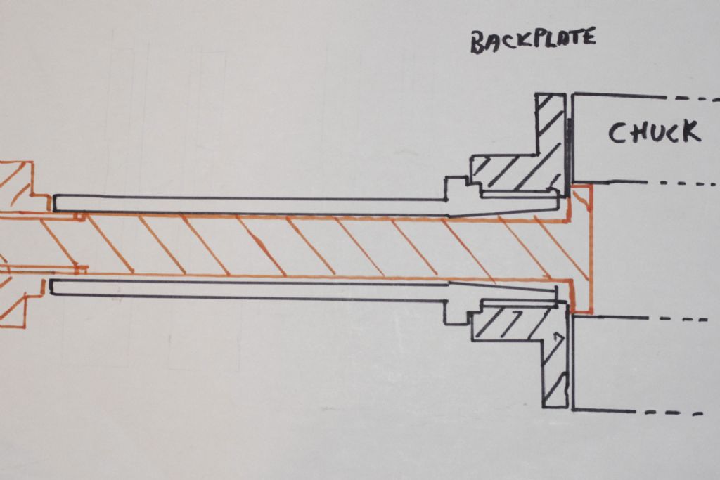

                                  I found a sketch of the Atlas reverse modification using a drawbar. I had posted it on another forum last year.
                                  Edited By old mart on 14/02/2021 15:38:49
