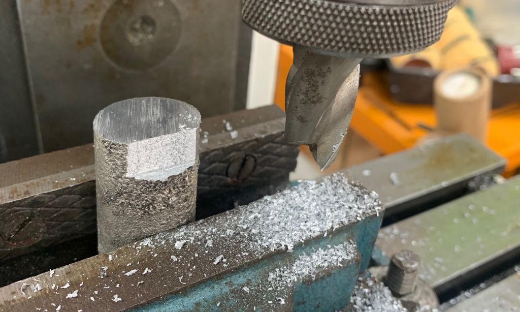

      The phot below shows the poor finish I'm achieving when milling a piece of aluminium. Its not just cosmetic either, it feels rough to the touch. The setup I've tried is as follows:
      Milling Machine: Centec 2A fitted with a Clarkson Autolock. No discernible movement in the cutter or the work.
      Cutters: various 5/8" 2 and 3 flute cutters, which may not be as sharp as they could be as they're my fathers old ones and I don't have the means (knowledge) to sharpen them.
      Cutter RPM: I've tried 400rpm and 600rpm with a slow feed rate, cutting depth of about 15-20 thou,
      I suspect the problem is blunt cutters, but want to be sure before buying new ones.
      If I have to buy new ones what would be recommended – I'd like to keep the clarkson autolock, but don't know whether the thread would be the same on new cutters.
      Any advice gratefully received.

          Do you know what Aluminium alloy it is? Looks pretty manky on the outside, which may not signify, but it may not be a machinable grade. Also a possible combination problem: blunt cutters, poor material, and no cutting fluid. First thing to try is wetting the cutter and rod with paraffin or WD40 with a brush. I'd also try faster rpm and feed rate.
          Also, holding round sticky out rod in a vice like the photo is highly likely to vibrate and move. Try inverting the rod so the vice grips the flat you've already cut: the flat is much less likely to move. (I'd hold a round object in that configuration in a V-Block)
          Few of us can sharpen milling cutters, so no shame in replacing them. Buy a new one to compare known good with what you have before assuming they're all past it, but if they belonged to your dad…

            Well the cutter certainly looks old and well used in the photo. The white/silver line at the cutting edge would tend to suggest bluntness, there should be no reflection from the edge. The material may also be suspect as it looks home cast and may be soft and sticky. Most purchased alloys have had some form of heat treatment which improves machinability.
            New cutter threads will still fit you Clarkson chuck.

              Looks like an odd bit of cast Aluminium so could be just about anything thrown into the mix and if not heat treated can be less than ideal to machine, you could try eliminating the unknown buy practicing on an known alloy such as 6082.
              Any metal won't like dull or blunt cutters particularly non ferrous so investing in some new ones if changing alloy does not cure the problem will help. using the now outdated Clarkson which requires threaded cutters will limit your choice these days but HSS 2 flue would be your best bet for aluminium.

                Its a scrap bit of casting which is why it looks manky. Foundry & Fabrication at Totnes have cast the baseplate (aluminium) for my hot air engine and its Flyweheel (ali-bronze). Its the same material as they use for casting gearboxes for cranes and having seen the quality of their finished product this is a very machinable alloy. (I collected them yesterday and their Production Manager was kind enough to show me the foundry and workshop – its such a pleasure to talk with a knowledgeable and enthusiastic professional).
                I confess I didn't detect any vibration, but I'll try holding it differently – I've nothing to loose and lots and lots to learn.
                You make a good point about buying a new and comparing – I thought they would be expensive, but just seen one for about £6.00 which is not extravagant.

                  This is the sort of finish you can get with reasonably priced import cutters, not the swarf is the full length of the cut not crumbs, unfortunately the ARC ali specific ones don't come with screwed shank.
                  Also up your speed, 5/8 HSS can be run at about 2000rpm on Ali if the old Centec is upto it.

                    thats more like the finish I want to achieve! I don't think it can achieve 2000rpm, but it can do considerably more than I've been using – I looked for advice on figures in book I have. I'll give it a go.
                    I'll also investigate getting new cutters – do you think they need to be threaded on could plain shank be held effectively just by the collett?

                      You need threaded ones in the Clarkson otherwise they will pull or wander out, that is why I said your choice will be limited.
                      I think there are adaptors available or could even be made that would let you hold a "weladon" shank cutter (parallel with a flat for grub screw) of a smaller diameter which will open up the choices of available modern cutters. Hopefully a Clarkson user will show you what they are like.

                          As already mentioned, that cutter looks blunt. New threaded shank cutters are easy to get hold of, but beware, metric sizes need metric collets and inch sizes need inch collets. Keep the new sharp ones exclusively for non ferrous metals.

                            Use coolant. It will make a big difference. I agree with other comments regarding the material itself, it looks pretty rough stuff.

                                  One piece of advice missing? When cutting aluminium the cutter should rotate "climb milling" – as shown in the more recent picture, the rotary table should be rotating Anti-clockwise, or as shown – cut completed.

                                    As above regarding sharp cutters. Also I would like to see that workpiece held in a more rigid fashion such as in the V of a Vee block and then held in the milling vice which gives three lines of contact with the workpiece. I don't recognise that milling vice either so cannot comment on the rigidity of that either. Cutters should cut not rub especially on aluminium.
                                    All that said, try it with some WD40 as a lubricant.

                                            I should say that finish I showed was done with conventional cutting not climb cutting. I would also suggest OP sticks with conventional until he gets a feel for the machine which could have a lot of backlash due to it's age. If you do want to climb then start by just using it for a final light finish pass.
                                            As I said at the start sticking with the Clarkson will limit your options for cutters as most suppliers just do basic 2 & 4 flute and 2-flute ball nose in screwed shank so you will be stuck with old technology and not be able to take advantage in advances in cutter design such as high helix, ctr cutting on all flute counts, material specific cutters, carbide and so on.

                                              Look at the size of Jason's chips and then at yours. Jason is feeding fast enough to be cutting, I think you are feeding too slowly and probably rubbing as much as you are cutting. Plus the other points regarding sharp tools and fluid to help. Find a speed and feed calculator on line and learn how fast to turn the handwheel for the suggested feeds. For a 3 flute cutter Ø5/8" with rpm at 600 you need to be feeding in at about 3.5" (90mm) per minute as a starting point then adjust feed up or down to suit the actual conditions. For a 2 flute cutter the feed would be 2/3 of that required for a 3 flute cutter, 60mm/minute.
                                              Rubbing produces heat that can cause the aluminium to become tacky and help it stick to the cutter which adds to poor finishes.
                                              Rigidity of workpiece holding is also very important. Looking at your picture the vice has serrated jaws. To me this makes it look like a drilling vice and not a milling vice which usually have smooth jaw faces. if it is not a milling vice that may also contribute to a poor finish.

                                                I too was concerned having see the vice jaws, they don't look beefy enough for side loads either. You need an 80mm Kurt clone which I use on my 2A (with the back drip rail cut off.)
                                                I've bought a job lot of cutters twice now off ebay and have found around 70% are sharp so 'named' Clarkson style cutters are still out there.

                                                    I think some of the problem is in the OP's second post:-
                                                    This indicates to me the piece in question is probably a runner or riser and as such has not been through the HT process which you would expect given the last highlighted part of the comment above.

                                                      Hi, I checked with the foundry today and the material is LM25 and as you suggest it was a piece of scrap riser.
                                                      I found today that a higher feedrate and lubrication with WD40 helped improve the finish immeasurably, I suspect I shall see another improvement when I get the new cutter.
                                                      I also tried climb milling, but the machine doesn't seem to feed the work evenly and I didn't detect any improvement in finish.
                                                      After all that, I think I've still got some work to do to try different combinations and I'm learning a lot!
