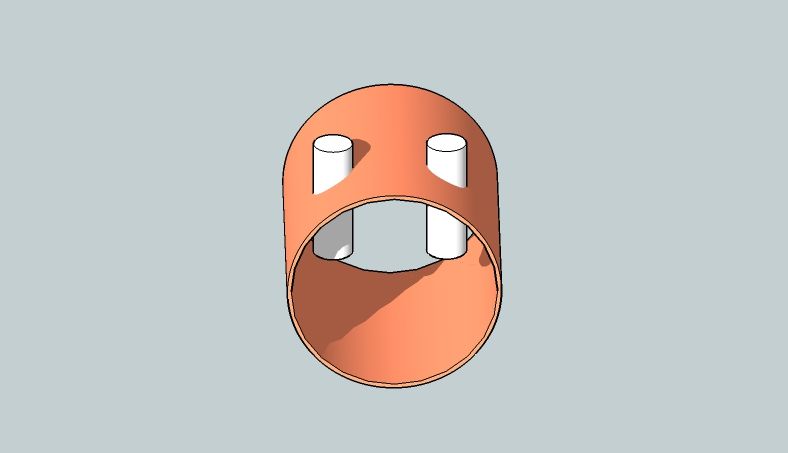

      Asked my local engineers to drill me two accurate holes 5/8 dia in the vertical plane, parallel to each other.
      They said they could set up on a mill and ream for accuracy.
      Picked up a piece of tube with both at least 3/4 inch diameter by 11/16 inch.  Looked as if chewed out and certainly not round.
      Was I expecting too much ?

                    I think I understand what you wanted and as such each hole in the tube would be slightly elliptical to accommodate the pipes needing to be parallel to each other and both off center from the tube axis by 1 inch.
                    While in no way excusing the work done it can be difficult to secure a thin walled tube for drilling, you can't lock it up in a vice unless you make a mandrel, and it tends to grab as the drill cuts through; copper only makes this worse. My guess is that the tube wasn't held properly and the work grabbed the bit resulting in the mess that's been returned to you!!
                    I will bow to the more experienced here but I don't know if it is accepted practice to ream thin wall sections especially material like copper.

                      Not excusing the job delivered in any way.
                      Two holes parallel. .?
                      Do you mean ( looking at end of tube) at 12 o’clock and another at 12 o’clock but further down length of tube..
                      Or one at 12 and one at 6 AT NINETY DEGREES BUT NOT PARALLEL. ..or do you mean
                      One at 12
                      and on at say 2:30 but both parallel ( assume one at 2:30 is not perpendicular to tube)
                      I don’t mean to harangue but you can see that from just the words the position of the holes is not well defined (at least to me)
                      Walk in jobs “oh could you just” are often a night mare because of the sketchy nature of the requirements..
                      Btw if I were to suggest a way of that part. I would suggest a plug to drill into ( copper can be a sod )

                          Btw to fit a circular pipe/rod into a curved surface will not produce a “round” hole …your hole will (might) measure 5/8 one way and some what more the other. ..

                            Jason you are right , it is an elliptical hole. I have a drawing that I have added to my album.

                                Yes MichaelG..not certain if the development of the hole would be a conic section but yes .. projected parallel to the axis of a circular hole , the hole will in deed be circular… (circular argument )
                                #132676
                                Tony Pratt 1
                                  @tonypratt1
                                  This job is not at all difficult if you go about it the right way and have the equipment. A drill press won't be up to the job. I would use a mill and slot drills to start the job, stepping up to 5/8" diameter to finish or possibly a boring head to achieve final size.

                                        bit like this?   see album "pipe"

                                          Plug it with a good fit hardwood or plastic and use a good endmill
                                          Setting it up right is 95% of the job in this case

                                            Posted by jason udall on 15/10/2013 00:44:12:
                                            That is exactly it Jason.

                                              Slot drill followed by a boring head, not a problem. If the tube is a little mobile then wooden plugs turned to size would stabilise it. See first photo in My Album for similar job.

                                                  If the vertical pipes are to be silver soldered in, then too-good a fit is not wanted. As long as the holes are the right shape and a close enough (but not tight) fit will do the job fine regardless of surface finish. The original might be salvageable if the holes are trued up with a boring head. (radial holes shouldn't go outside the required shape for vertical ones).
