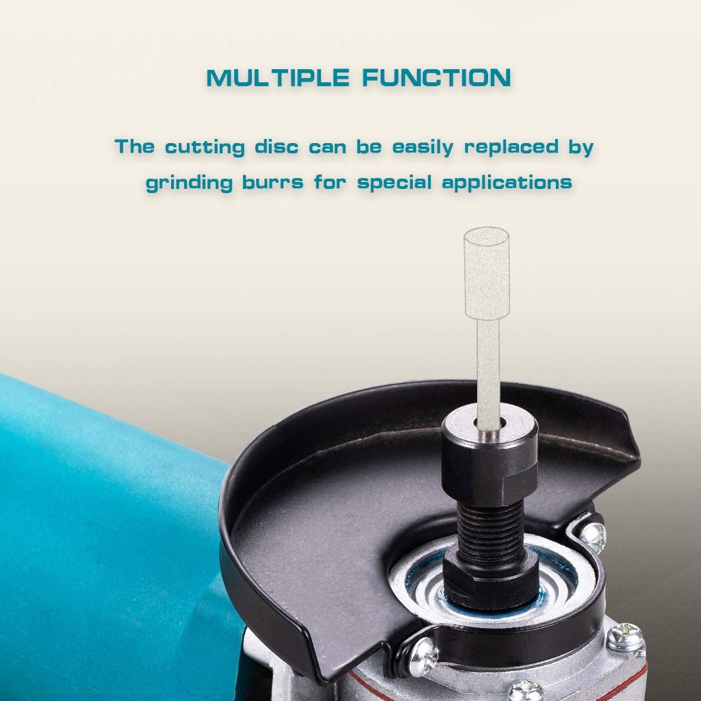

      Hi All,
      I have just bought this small KATSU angle grinder from Amazon as it is easier on my wrists and a lot quieter than the 115mm one that I have at the moment.
      I want to use it for cleaning up material before welding etc. I have also got a lot of small ROLOC 75mm flap discs and the normal drill adapter with 1/4" shaft.
      The grinder will take small Dremel type cutters etc as shown.
      I would like some advice on a SAFE way to make some sort of adapter to take the 1/4" ROLOC shaft so that I can use the discs. Using them in a drill soon gets uncomfortable and I have a fair bit of material to prepare for welding of the linisher base.
      All thoughts welcome!
      Cheers, Martin

          The first review on this Amazon page mentions an adapter: **LINK**
          #572039
            3M make the backing pads with several internal threads, unfortunately not M10 x 1 which would just screw straight on but you could make an adaptor with M10 x 1 female to go onto the grinder and M10 x 1.5 to fit one of the backing pads with that thread.

              Michael, I had noticed the adapter in the review, have just ordered one and will see how it goes.
              Looks to be 3D printed and if no good I will make one in steel as per Jason’s reply.
              thanks everyone!
