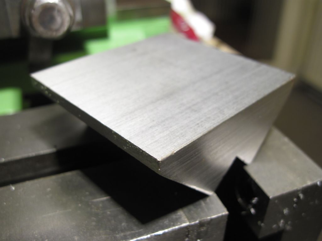

      Raining hard here tonight, so I didn't really feel like a trip down to the Shed. Been meaning to do this job on the Acorn 7" but (given the interest in hand-shaping) decided to try the Adept instead. It's a 'V' rest – used to hold stuff on the cross-slide a bit higher than the T-slots but not as high as an ordinary 'V' block. It's had a hard life and is not a precision tool – just a work holding device…
      Battered V Rest
      ​Just over two hours later, half way there – bottom, end and side edges machined – leaving the top angled surfaces to do. Could have done it faster on the mill but they are down the Shed too! Listening to the radio (mind in neutral mostly) it's better than just watching Poldark (which is what the wife did tonight). Hard to explain hand shapers rationally – don't normally do anything too large with mine but this lump turned out to be very free-cutting, so it wasn't hard work…
      V rest - half way
      I've put a few more photos of this job in progress in my 'Adept' album if anyone is interested.
      Time for bed!

                            I would have finished the 'V' block tonight but realised I'd made a daft mistake when setting the edges up, so they are parallel but slightly out from 90degrees to the ends. Of course, tonight I used one of the edges as a datum to cut the 'V' – so it too was at a slight angle to the ends. Not the end of the world and I was tempted to just let it go but I know it will just sit there and really annoy me (or come back and bite me again some day when I'm in a hurry and don't remember it).
                            So I've re-machined the edges true and started to redo the 'V' to get it aligned correctly. Fortunately it's recoverable as none of the dimensions involved are that critical. As usual – not the machines fault – just the dumb operator.

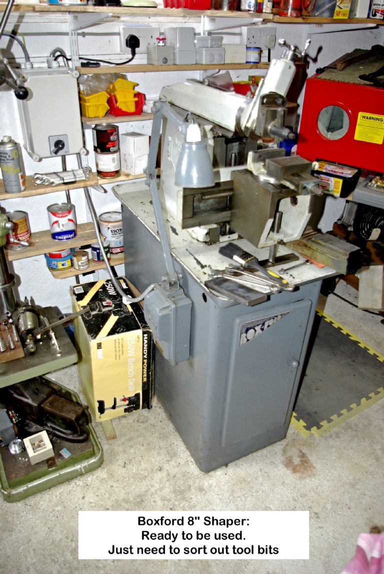

                                    OuBallie
                                      @ouballie
                                      Don't use it anywhere near often enough for my liking!
                                      Boxford 8 Shaper
                                      Tool bits sorted long ago as this is an old photo.
                                      That sandblasting cabinet now resides in the Carport doing stirling work.
                                      Geoff – Another week to fortnight before left foot has repaired itself, meaning frustration is at the 100% level.
