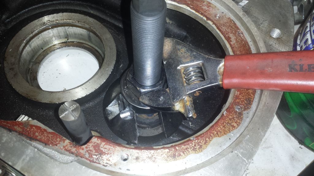

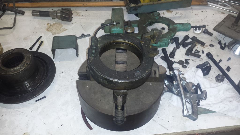

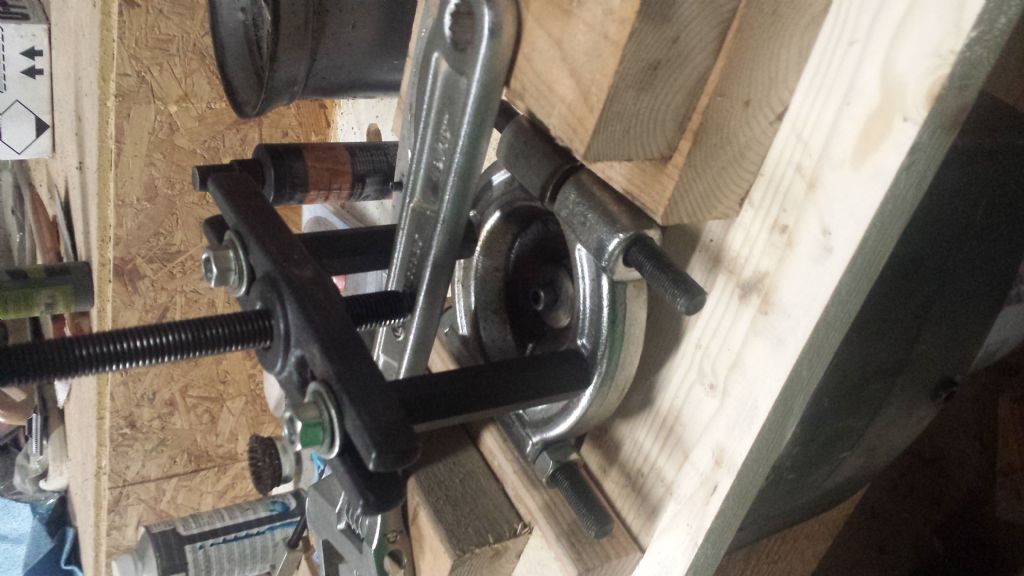

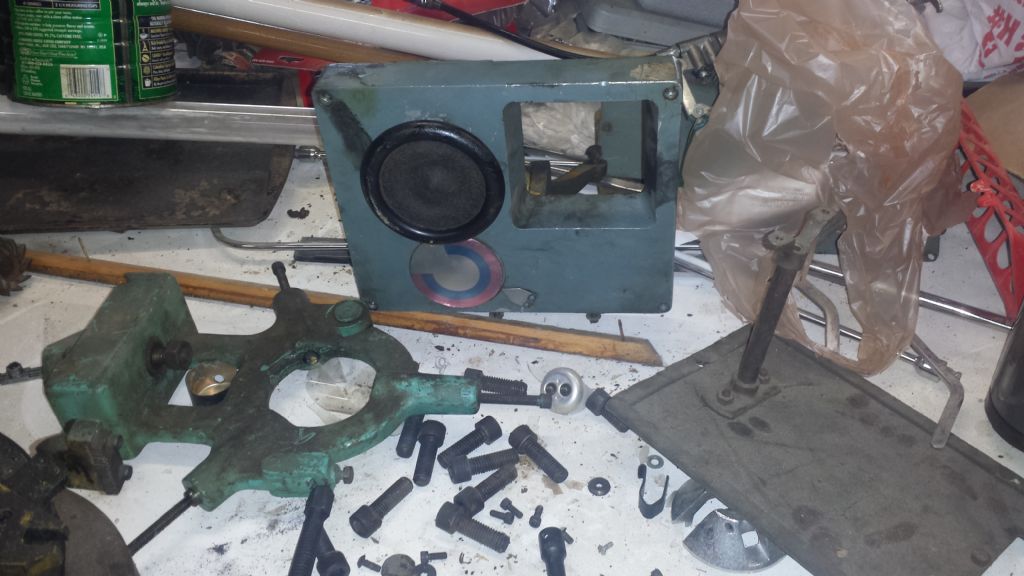

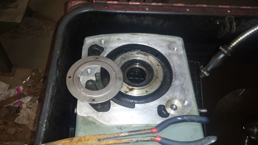

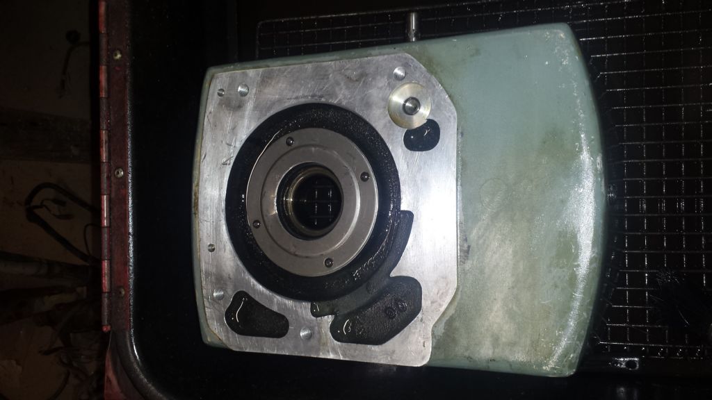

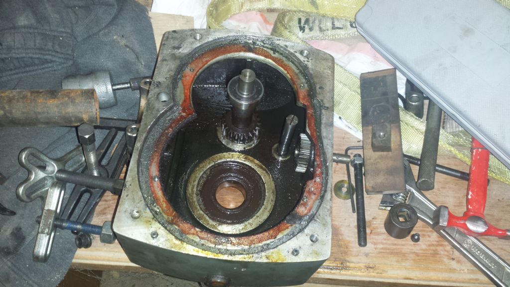

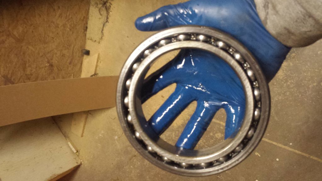

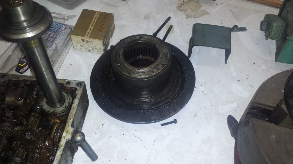

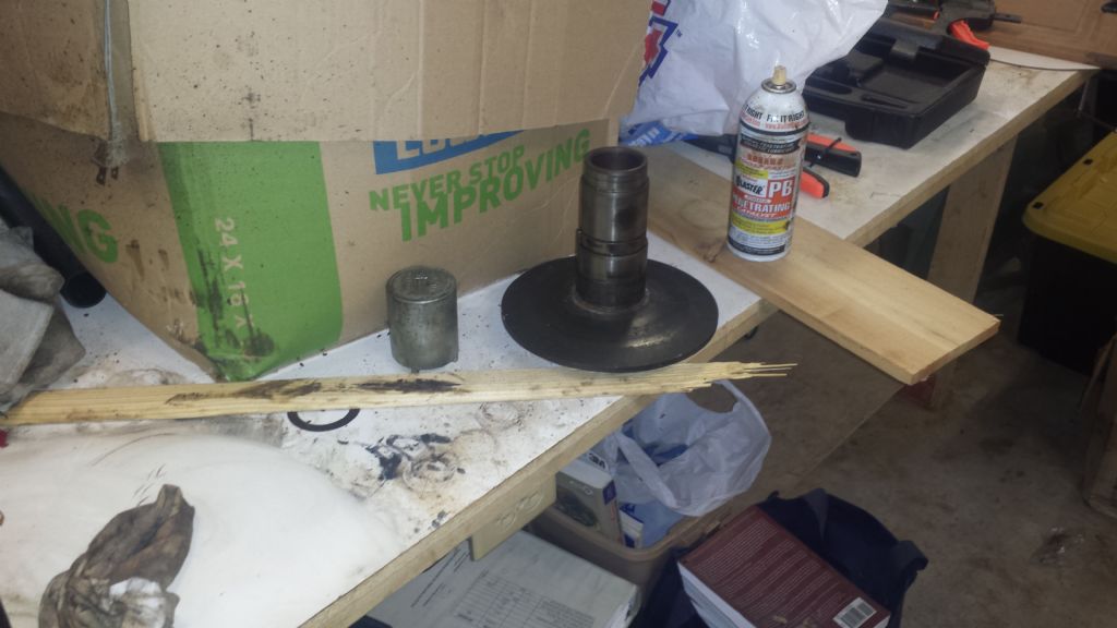

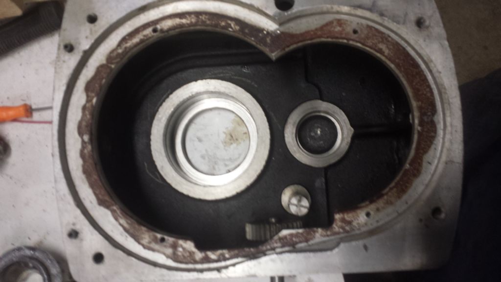

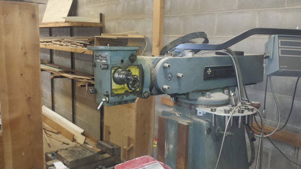

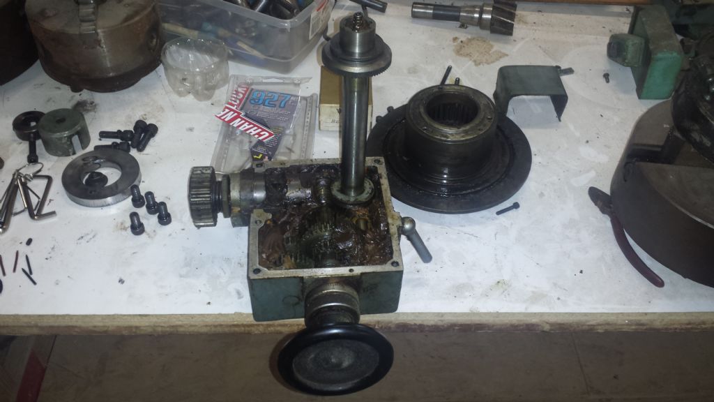

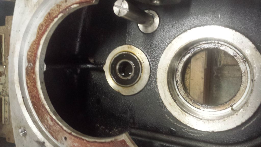

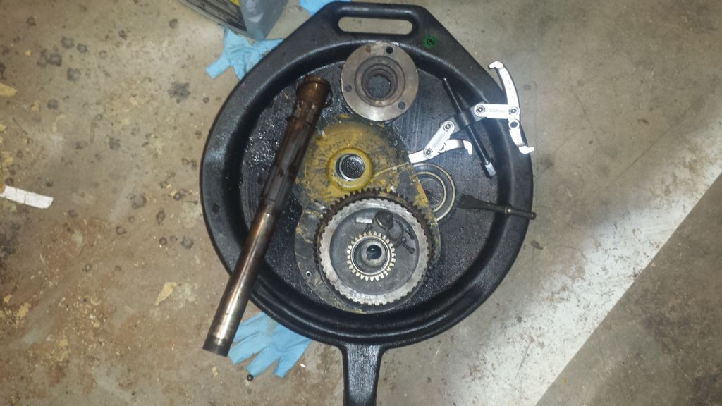

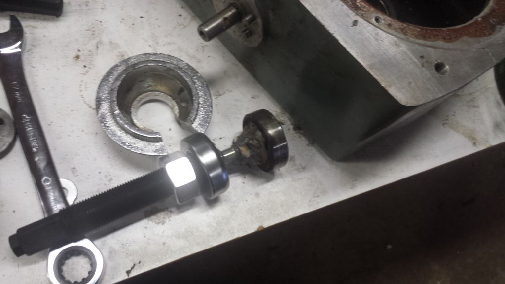

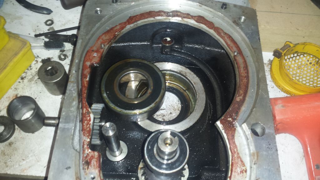

          I'm currently having to rebuild the head on mine as the previous owner disintegrated a bearing on it causing the lower pulley to drop down onto the timing gear for the backgear. It made for an interesting disassembly to say the least…
          All the documentation i found said basically pull apart the assembly and simply replace the belt, no biggie.
          Three days later and lots of penetrating oil I was able to get it apart enough to cut the bearing off the shaft.

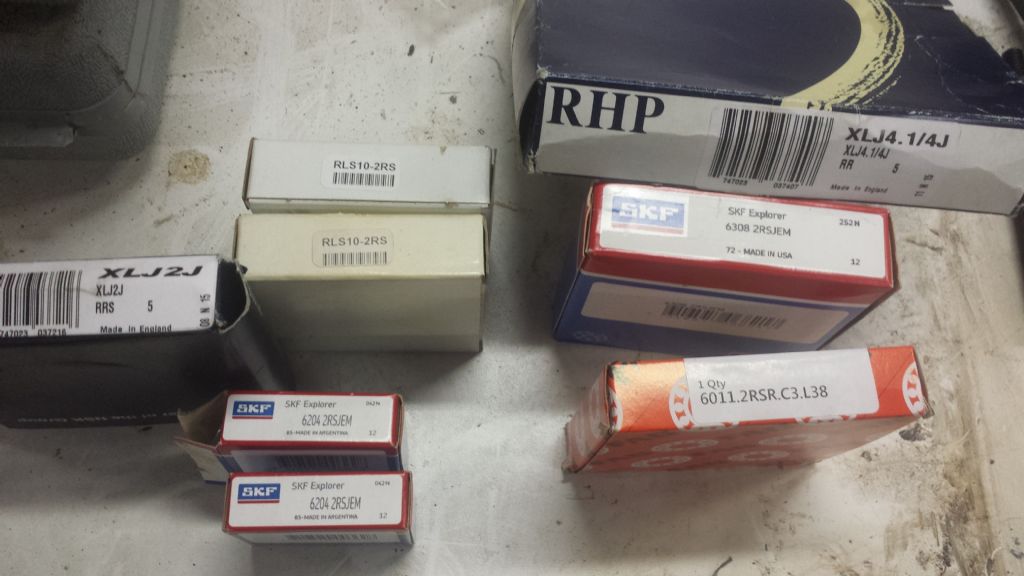

          Mine is a VBRP model as well and since i'm currently compiling a list of bearings needed for the rebuild I'll be sure to post pictures and bearing numbers when I'm done to help out other folks in the same situation.
          A lot of these bearings can be cross referenced to things found over here in the U.S. However I've found two bearings that I cant seem to find anywhere else than in the UK.
          RHP- XLJ4 1/4E (SIZE-ID 4 1/4"xOD 6" X W7/8&quot *
          RHP XLJ2 (SIZE-ID 2"XOD3 5/16"X W5/8&quot *
          Gaco oil Seal # 2 x 200 275 1/4
          All of the cross referencing I've done led me to these and they are available from various manufactures here in the US. Can anyone tell me the difference in precision between RHP or Hoffmann and things available here like AMPEC, or SKF?
          RHP 6011-2RS (SIZE ID55MMXOD90MMXW18) (QTY 1)
          RHP 6308-2RS (SIZE ID 40MMX90MMX23MM) (QTY 1)
          HOFFMANN 120RSS V3 (SIZE 20MMX47MMX14) 6204RS ALTERNATE # (QTY 2)
          HOFFMANN LS12RSS V3 (SIZE ID 1 1/4"XOD2 3/4"XW5/8) RLS10-2RS ALTERNATE # (QTY 2)
          I havent found anything for the two brass bushings in the VBRP pulley drive but I dont think I'm going to be replacing those at this time anyways.
          The drive belt for the Back Gear is
          210L200 and is available from Mcmaster-carr #6484K347
          the VBRP pulley belt is another one I'm sourcing from Mcmaster and I just did some measurements and im ordering one thats 'close enough' for me to use I'm hoping. I'll update in the future as to if it doesn't fit.
          1922V386
          Mcmaster #7885K19

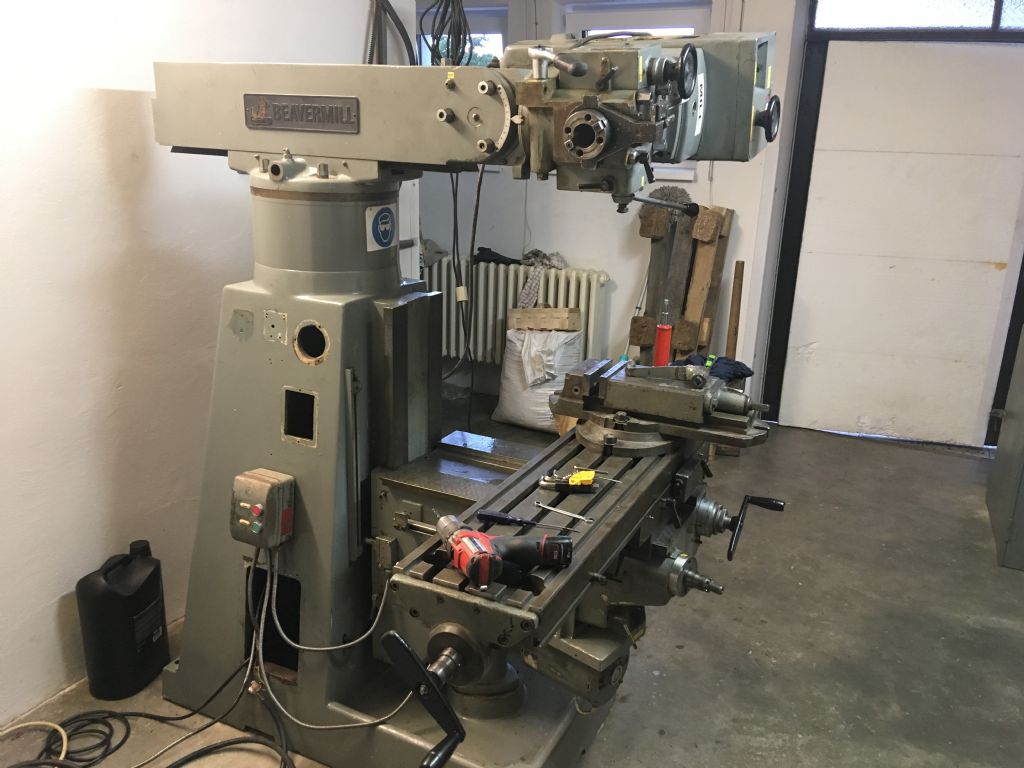

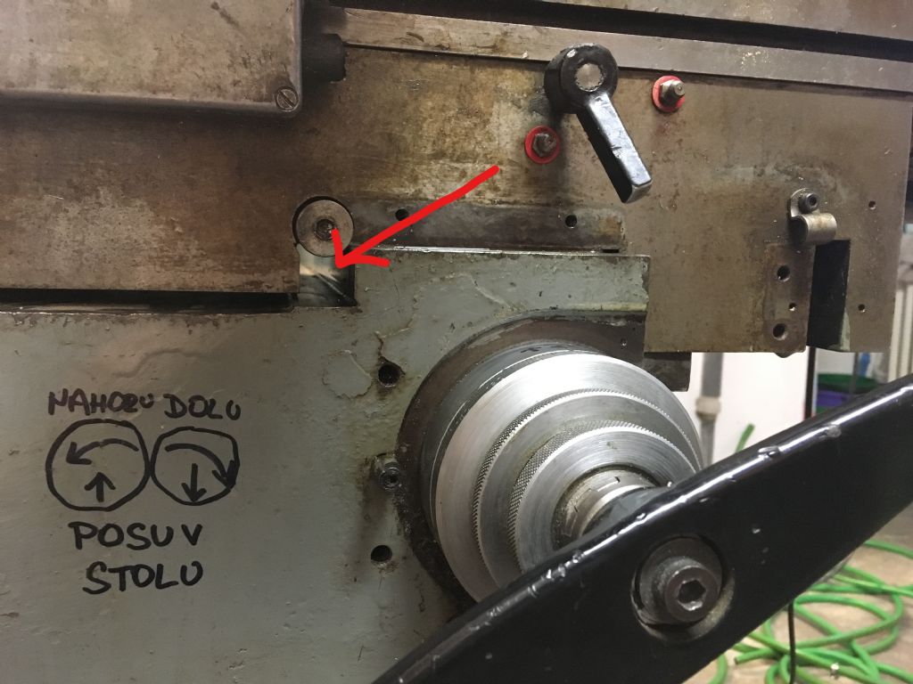

                                                3.jpgHello all,
                                                I just bought Beaver VBRP MK2. I am from Czech republic so this milling machine is not usual here. I just found out that gib key is missing. See the pictures please. I assume that I am only one owner this machine in the Czech Republic.
                                                Could you please measure yours and write the dimensions to me? Some basic drawing will be the best. It would be really helpful.
                                                Thank you

                                                  I'm afraid that I cannot help with dimensions for the gib. My machine is a VBRP MK1. All of the drawings I have are for the MK1 as well. Are there any adjusting screws on the left hand side of the saddle? If there are, the gib is parallel and you can measure the dimensions from one end and make a gib that will fit.
                                                  If there aren't, then it is a tapered gib and you will need to measure the width of the gap at both ends and make the gib to those dimensions.
                                                  If it is a parallel gib, you can make it to nearly the right size and adjust it with the screws. If it is a tapered gib, you really need to make it to the right taper, then scrape it to fit the ways.
                                                  If you can, make the gib from cast iron instead of steel. It causes less wear on the other parts of the machine (the original gibs were all cast iron)

                                                    There are not udjusting screws on the left side of saddle. There are only lock screws.
                                                    Yes, it is tapered gib. It seems that I will have to measure angle with sinus ruler, but I have to take down the saddle. Cast iron seems the best for it.
                                                    Do you know anyone who has drawings for MK2? I have original literature, but there are only basic information how to lubricate and etc…
                                                    I assume that Beaver factory doesn’t produce milling machine anymore. Right?

                                                      I am almost certain that I got a pair of spare table gibs when I first had my VBRP Mk2. They are complex double tapered, odd looking things. A thread rod emerges from one end, and this locked with a pair of nuts either side of a fixed part, so they are positively held in both directions after adjustement. I also think they are a right and left handed pair.
                                                      I could try to take some dimensions from it if you want, and maybe photograph it. Best would be if sommeone could put it on CAD.
                                                      Later…
                                                      I have found them, they are a matching pair. Cross section is parallelogram with angles 35/55 degrees. The section is constant height, but tapered width.
                                                      They are 10 ins long (254mm)
                                                      At the fat end, the parallellogram is 0.6317 ins (16.045mm) by 0.7351 ins (18.671mm)
                                                      At the thin end it is 0.4911 ins (12.474mm) by 0.7351 ins (18.671mm)
                                                      The fat end has a slot 7.4mm wide by 8.81mm deep, 8.34mm from the end. It is the slot that is used to lock the adjustment. The threaded stud I mentioned must be the stationary part. There is a blind hole about 6mm diameter 77.5mm in from the fat end in one face.
                                                      The part seems to be made of carbon steel and hardened after machining all over. One side looks to be ground then hand scraped flat. There is a witness mark on one face where the table locking screw has pinched on it.
