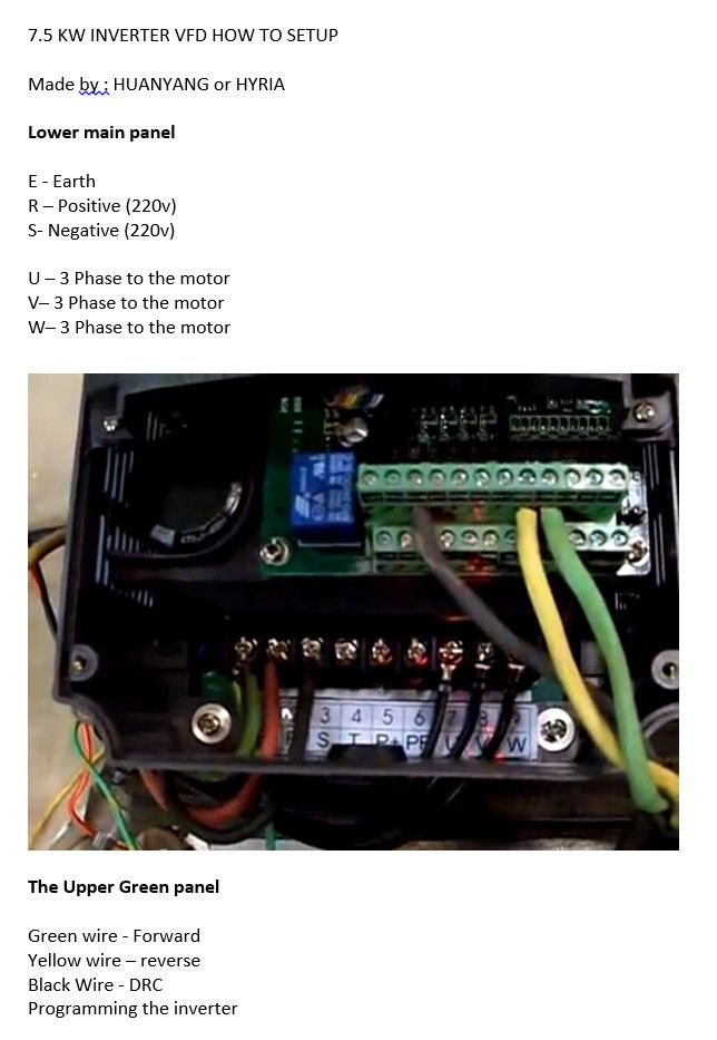

                          I am using the power converter but NOT the frequency controller. The output of the controller is three phase and as I’m not playing with the frequency controller it outputs 50Hz which is the mains power frequency.
                          I then plug this into the back of the machine as the manufacturer intended (plus or minus the magnetic contactor) which then goes into the distribution box to supply all the motors.
                          I have left magnetic contactors in some machines as they have been used as distribution boxes and to unpick that is time consuming and will mean more cash spent on a solution rather than having fun making something.
                          The machine has Mechanical Variable speed through belt and pulley gearing and reverse through an electro-mechanical switch which reverses the polarity of two phases to the main spindle which I’m more than happy with.
                          Be warned that there are situations that can cause issues. I have a MidSaw that has a transformer in it for blade welding. Although the motor was converted for 220v and will run happily on the inverter the transformer relies on 415v to run the blade welder so the solution was to put an additional transformer which takes the 220v three phase and out puts 415v three phase.. had to sell a kidney for that.
                          Dan

                            Ah, just realised why you are thinking that I am using the frequency controller… the picture above came from a tutorial guide I have on the inverter… If you are interested I have the complete guide which shows you how to program it…..

                                  Posted by Daniel Robinson on 13/11/2016 13:21:16:
                                  I was a little lost at your pitcher, but thought it maybe from a book,,, can you take a photo of your wiring set up please Dan👍
