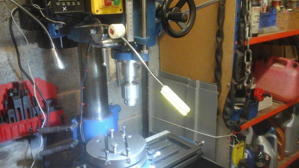

                                  Here's the sewing machine lamp I mentioned above. Two for about £15.

                                      I have one of those it is good. Was in my stocking a couple of Xmas' ago so not sure where it came from.

                                        I have a couple of these.
                                        The first was under a fiver but the second a little more expensive.
                                        The warning label is in Chinglish and it took a long time to decipher though!

                                              I bought 2 of those, direct from China. Electrocution waiting to happen. Inside that metal swan neck are 2 very thin wires with very thin insulation, one is potentially at mains voltage depending on which way the plug is wired. No earth of course. I spent far too much time altering them to run on much lower voltage

                                                What about electrically connecting the metal swan neck to your machine? Your machine is certainly earthed and so the swan neck. It gives a better protection and it will not harm.

                                                  Duncan's point is well made, though I hardly have need to move the flexible arm much. I've added an earth to the arm of my lamps.

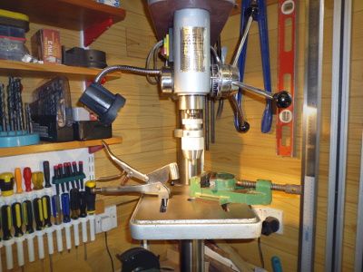

                                                    These are some I made earlier! From a pond light from B&Q and a microphone gooseneck from the long gone Maplins. The gooseneck and mount are available from CPC not sure where an equivalent lamp housing might be found, a garden centre possibly.
                                                    On the lathe
                                                    On the bench drill.
                                                    I did a write up on making them available from Journeyman's Workshop might help if you want to go the DIY route. The lamps are fitted with MR16 (12v) LED bulbs and give good local illumination. They are also cool to touch unlike the original halogen bulbs which the LEDs replaced.
