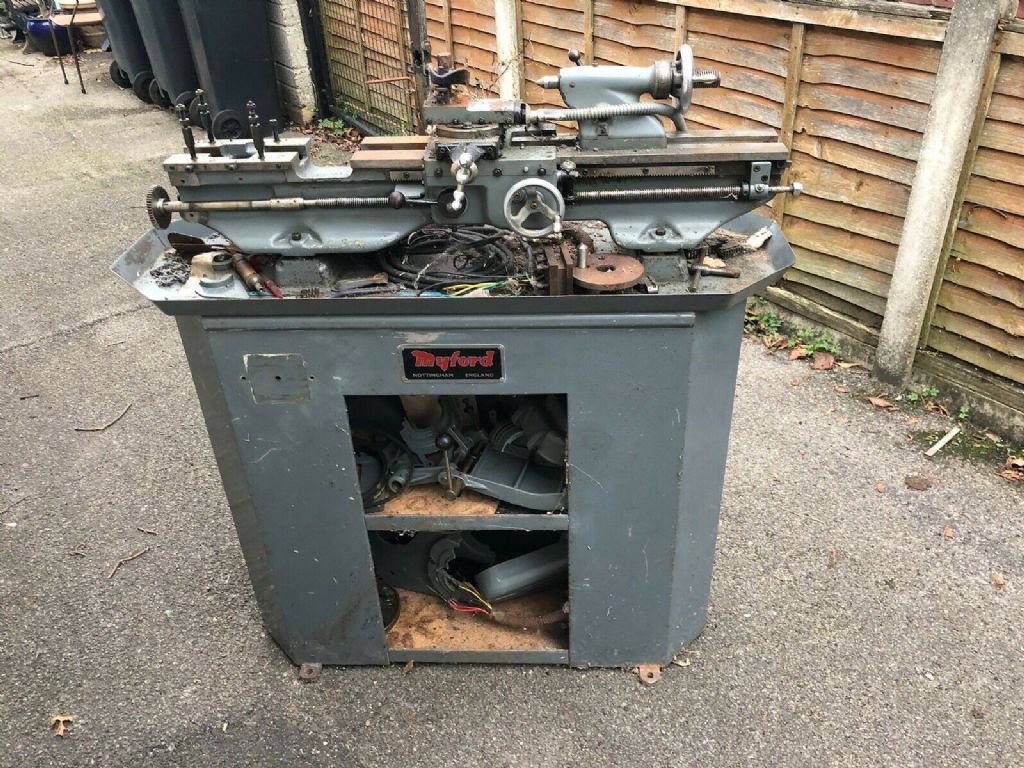

                                          I don't know why everyone is always quick to recommend new stuff. For small parts a Myford ML10 would be ideal and it will be higher quality than the Chinese stuff.
                                          A £1000 will get you a minter. The spare £1000 will buy you all the accessories you will ever need.
                                          #439520
                                            Further to my comment above Axminster do class the SC4 as Trade/Engineer so you will probably get the 3 yrs gaurantee, I thought it started at the SC6 with the SC4 in the hobby range.
                                            One think to watch with any old machines in a business enviroment is that they may not have the current safety features like chuck guards and leadscrew covers etc.
                                            #439530
                                              Posted by Hollowpoint on 30/11/2019 13:11:12:
                                              Just had a quick look on ebay. Admittedly not an ML10, but this Myford has reached £410 after 12 bids and the auction has 2 days to run.
                                              Had a good look at an ML10 when I was looking to move up from a Mini-lathe and wasn't impressed. Decent enough machine but not in the same class as an ML7 or a Super 7.
                                              Even worse, chaps seem keen to pay for the Myford name despite obvious wear and tear. In consequence I feel Myford lathes are generally over-priced for what they are, especially compared with the likes of Boxford. Although ML10 prices used to be more realistic, they've crept up.
                                              One major advantage of buying new is it can be bought now. It's not necessary to find an ML10 for sale, or to confirm it's in good nick, or make an offer. And, in the event the machine is found to be a dud, it's easier to sort out the financial consequences when buying new.
                                              Second-hand Myfords aren't top of my list. Not because I think they're rubbish, it's because they're too popular!
                                              #439602
                                              Hollowpoint
                                                @hollowpoint
                                                The ML7 and super 7 are massively overrated and overpriced. Your photo proves that even rough ones can fetch a good price.
                                                The ML10 on the other hand is much less popular and represents good value for money, they can be had for less than £500 which is about the price of a mini lathe. I don't know what you went to look at but I don't know how you can be unimpressed? Almost every ml10 I've ever seen has been in at least good condition. They where typically used by model engineers rather than industry so most have seen little use. In comparison to a mini lathe its like a Rolls Royce. No plastic covers, no plastic gears, no plastic handwheels a properly ground bed, proper motor and proper chuck. What's not to like? IMO they are actually a bit of a bargain.
                                                I do agree that Boxford lathes beat them all hands down, it just doesn't fit with OP's requirements.
