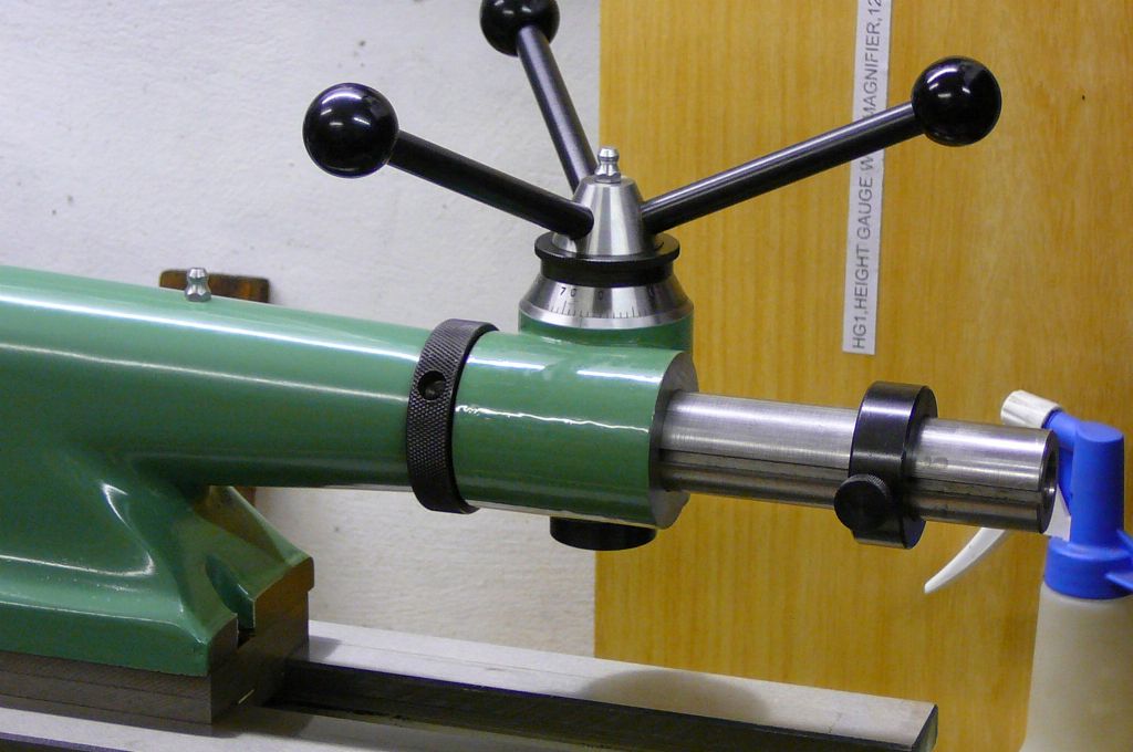

      Fed up with twiddling handle so have fancied one of these for some time:
      **LINK**
      Any disadvantages e.g. lack of self eject?
      Possibility of mounting some sort of depth indicator?

          Peter, my ML7 has the Cowells rack-feed tailstock (already fitted when bought in 1973) and find it very useful. When drilling from tailstock it is easy to take 'pecks' and pull back to clear chips without twiddling handwheel and force applied is better sensed than with a wheel and possibly reduces drill breakages. With benefit of having used it, if starting from scratch today would (gulp – how much) still feel it was well worthwhile. From pics I've seen believe CornishJack/Bill has the same unit. Can't see if the Myford unit has graduated collar, mine has a resettable collar to show advance of quill in 1/8in increments. When ejecting 2MT inserts, just lock tailstock and quill and use a length of 1/4ins rod with a ball on the end and so far have not needed to resort to a hammer.

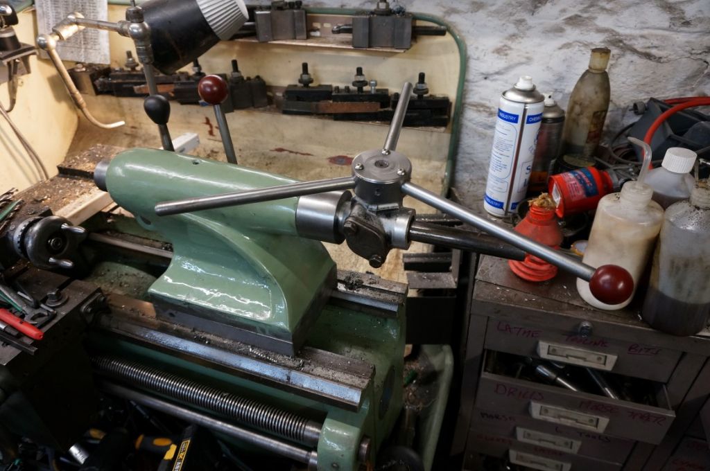

            Ian Parkin
              @ianparkin39383
              dsc00689 (medium).jpgHere is one I made for a Colchester student out of a mini steering rack

                I've had one for a few years now (bought from the 'old' Myford) and prefer it to the handwheel. Mine has a friction collar graduated in MM and sliding stop at the rear with a locking screw. It's a bit of a pain having to use a knocking bar to eject tooling, especially as I'm short of room to the right of the lathe, but I've been meaning to make up a combined drawbar/ejector to get over this (the bits for this are sitting on my bench, have been for four years blush  )

                                    I have one these ( same as HasBeans, except mine has 1/16" graduations) and I prefer it to the handwheel. I can estimate a depth to about 1/64" which seems accurate enough for drilling holes. The standard Myford handwheel tailstock has no graduations on the handwheel and the depth has to be estimated from the 1/8" graduations on the barrel itself. The other advantages are that the taper in the barrel is very easy to clean out and one can use a drawbar to secure collets and turrets in the tailstock. I have made a "bumper out" from a length of 1/2" steel bar with a brass tip on one end and a simple, but weighty, steel handle on the other. I keep this loose in the tailstock barrel and I don't miss the self-eject facility. The same bumper out is also useful in the headstock.
