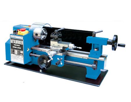

      HI, All.
      My minilathe has a standard toolpost and I keep each tool with some shims that pack it up to centre height. Changing tools is a bit of a chore but it's not terrible.
      Simon of SPG Tools from whom I bought the lathe was against quick change tool posts because of the reduction in rigidity.
      What actually bothers me about the setup I have now is as much getting the tool at the correct angle to the work piece as the time it takes to set it up.
      So I'm thinking about a QCTP (as I believe we acolytes of the mysteries are to call it).
      Firstly, do you agree with Simon – is rigidity an issue. Secondly, do I go for the eBay type (30 quid) or the UK Provided type (£60)?
      The eBay ones seem to offer two mounting points and a cam based locking mechanism (where the tool is pushed out against the dovetail). It also appears from the photos that the toolpost proper is made of aluminium rather than steel which, frankly, concerns me (mass and flexibility).
      The ones by our beloved professional UK suppliers (yes, you know who you are!) are all steel, have one mounting point and use a mechanism which draws the tool in, possibly being more rigid accordingly.
      Will I get cross with my £30 purchase and need to go out one at twice the price almost straight away?
      Thanks all!

                        Considering said mini lathe assume its this type
                        If so I would strongly recommend not to buy something else.
                        Rigidity non existent even worse the height adjuster being non repeatable the casting and screws flex.
                        In general all the other types massively superior and not from monkey metal.

                                That's not the only problem. This is a very expensive "mini lathe"
                                All really to save making the headstock circa 19mm higher for the same swing over the saddle but in real terms the swing over the saddle is too big for the size of the lathe – makes the numbers look better and @@## the practicalities. The design results in the way the compound is mounted as well. Myford get away with similar thicknesses but make a better job of mounting the compound.

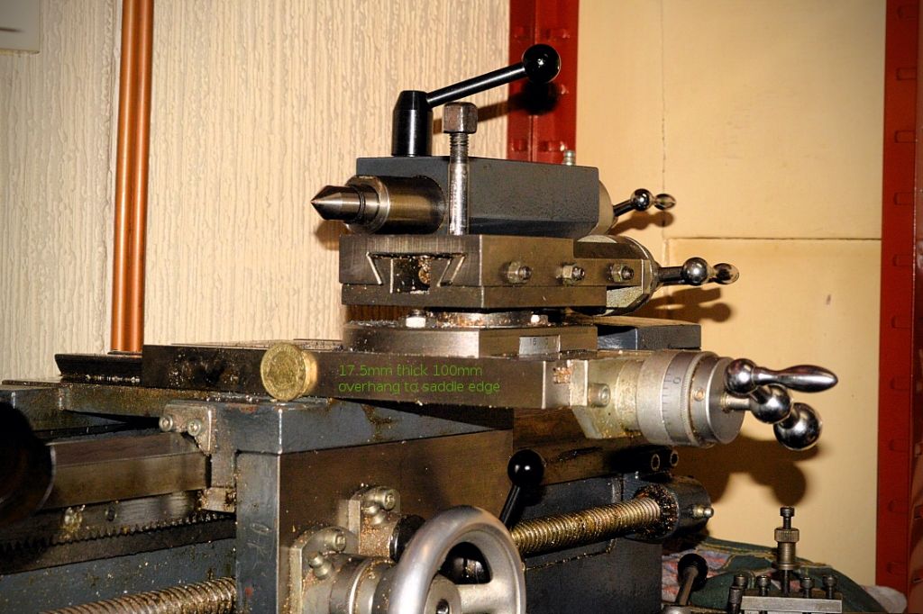

                                                    Out of interest I checked the price of a small industrial tool post of the same better type that arc do. £200 + a bit plus vat and that is discounted. These are a standard type made by several companies and do pull the holder in.
                                                    #228635
                                                    Vic
                                                      @vic
                                                      Posted by Ajohnw on 06/03/2016 17:40:58:
                                                      The compound slide on a Boxford is well supported. The slide itself is also very thick.
