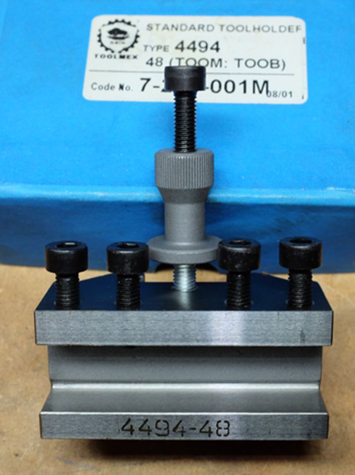

      Here's a picture of a Swiss-made SPI holder of similar type. You can see the machining marks on the bottom surface of the tool slot. Looks like it was ground in this case, (or perhaps face milled?), with the face of a dish wheel or similar. With half-round grooves provided to clearance the edge of the wheel (or cutter?) It still looks to me like the one in the OP was made in a cheap copy of this technique where a dovetail cutter was run down the length of the slot. Cheap and cheerful.

      Michael Briggs
        @michaelbriggs82422
        For reference here are a couple of photographs of a recently manufactured Bison tool holder, my older ones have different colour screws and the top and bottom external faces are not ground.

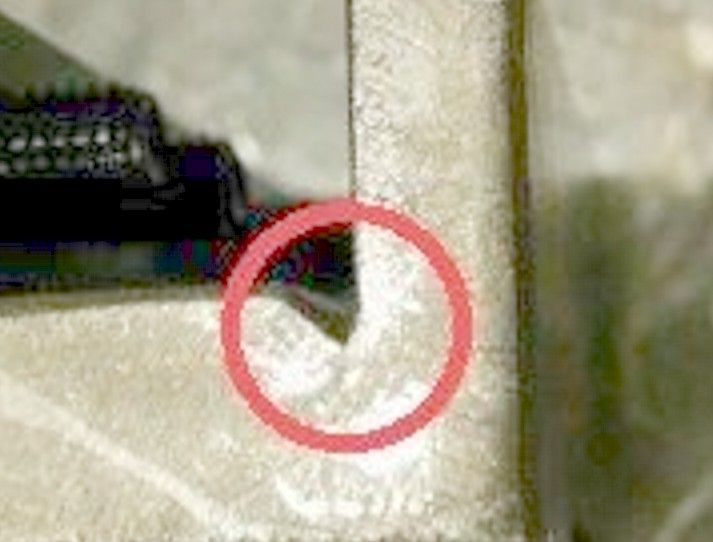

              #267328
                Hate to rain on the parade, but a bit of image enhancement and it's clear the OP's holder has a radiused corner just like Michael Briggs's.

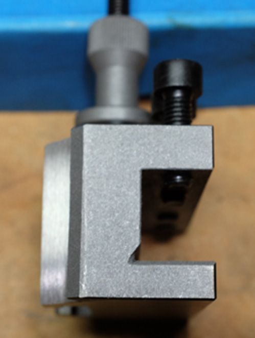

                    #267442
                    mrbuilder
                      @mrbuilder
                      Sorry everyone, was away from my computer until now… Yes being the owner of the original photo, I can confirm that it has a radius on the inside (as Neil has blown up). So mine look like the version Michael Briggs posted but his have a nicer finish on the faces.
                      Funny how sometimes you're talking about the same thing from a different perspective! Sorry it's blown out of proportion.
                      Yes Hopper just the chamfer, so I'm guess whatever tool they use to clean up the edge created that.
                      For me my question still stands on why it is there to begin with (i.e. the undercut with a smooth radius) particularly on the vee holders, I've contact Bison to find out. I have some genuine Dickson's coming and from what I can see from the photos they don't have this 'feature' at all.
                      #267886
                      mrbuilder
                        @mrbuilder
                        Thought it might be helpful to close this out smiley
                        Posted by Paul Lousick on 17/11/2016 04:21:25:
                        Probably an undercut to remove any radius corner made by the cutter and to allow the lathe tool to seat against the bottom and side faces.
                        Paul is correct, according to Bison this is their reason.
                        Posted by mrbuilder on 18/11/2016 21:04:10:
                        Or if perhaps if guys use vee holders to hold square tools as well (which I have seen occasionally)…
                        As is this, for why they have the same feature on their vee holders.
