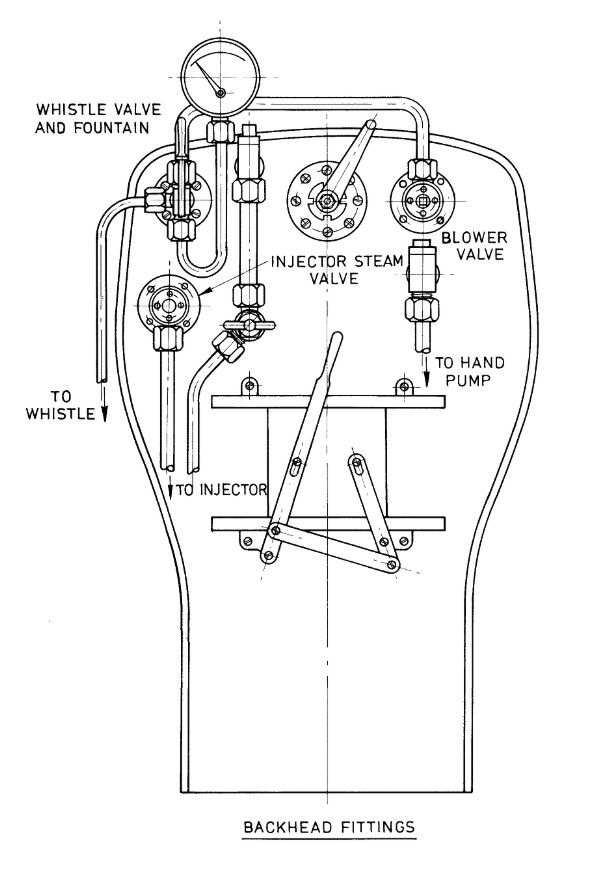

      I live in Vietnam and have just received the thread named steam engine from UK I would appreciate if any member ( who has knowledge on this model) could kindly explain the function of each control in the cab many thanks Stewart

          Hello Stewart,
          Welcome to the forum. The picture below is the 'standard backhead' as per the original plans, but be aware that many builders have their own ideas and your might be different.
          Also, if you are unfamiliar with operating a live steam loco, it's probably agood idea to get some advice on how teh various controls work, as well as firing etc.
          At the very least, give this article on managing small locomotives a very good read.
          Good luck!
          <edit>
          The valve at the bottom of the sight glass is  a blowdown valve for clearing it of limescale and general crud. The big unlabelled lever at top centre is the regulator (i.e. control for steam to the cylinders).

            Hi Neil
            Firstly many thanks for your reply and info given – and I will adhere to your recommendations.
            I have read through the given attachment written by Steve -which answered quite a few questions I have been juggling around in my mind –
            Yes this is a new hobby for me- although I have planned to do it for many years ! I will show my age now by saying that I reached the dizzy heights of a Past Cleaner at 55G in the early 60s and as such performed fireman's duties on a regular basis – having said this I know very well that am still a "green Horn"
            Back to my "Pansy" Neil, my model seems to have a few more valves than what is shown on the drawing you kindly sent – would it be acceptable for me to send a photo of same for you to have a look at-

              Hi stewart. I am working on a pansy at the moment. What you may have is the following. Looking at the locomotive backhead. Lower right hand side, water valve for injector. Middle right hand side blower valve.upper right hand side injector steam valve. On the left hand side you will have the water gauge blow down valve. Michael

                    Hi Stewart
                    it is very unusual for the cab layout of Pansy , or indeed any loco, to be built exactly to plan.
                    some Pansys have steam manifolds on top of the boilers with controls taken from there. I believe the Winsons/Model works boilers had this
                    If you could post a photo I am sure the forum will point you in the right direction

                          Do you have a hand pump for pumping water into the boiler? The original design was to put one in one of the pannier tanks but sometimes they are in the coal bunker.
                          Is there any pipework associated with this? It could have been an attempt to put in a second hand pump that proved difficult to use. It could also have something to do with feeding water from a spare tank in the driving trolley.

                                  Hi Stewart,
                                  What you are describing as a 3 way valve is the actual injector itself that puts the water into the boiler. It will no doubt be a commercially bought one (although some of us do make our own – not easy!)

                                          Stewart,
                                          It will definately help to have some picdtures so look around this site for instructions which have been posted a few times. You might be able to put some on a picture share site but those tend to be a problem with us having to be members of the site too. Have you worked out the 'private message' (PM) system on this site? I will send you a PM.
                                          You mentioned two brass bits with holes by the coal shute. If one goes to the T-piece what abut the other?
                                          The injector will not work well with warm water – don't rely on it. The hanging down pipe is an overflow. Water will come out of that when you turn on the water supply. You only then turn on the steam supply and look for the overflow to stop which means the water is going into the boiler instead. Then you stop the steam and see the water overflow again. Injectors are very sensitive to temperature and pressure, easily clogged by dirt, and like they say in car manual "not user serviceable" (until you are a lot more skilled).
                                          Not clear what you mean about the safety valve – they can weep a lot if not well made and also may need slight adjustment. Sometimes you have to push down on the pin in the middle with a screwdriver to let the steam blow off any scale on the valve seat and re-position itself.
                                          You may find the regulator tight or jammed when cold. Don't force it. It will relax when hot.
                                          The slide valvse for the pistons are under the cylinder block and hang down from the valve face when stopped. When you start it takes a bit of extra steam to push the valve up into contact with the face so steam leaks straight up the chimney initially and Pansy does not make a slow gentle start. This is normal. You may also have a drain valve (hopefully) under the cylinder block connected to a lever somehow in the cab. You open this before starting and close it after a few yards. It will leak steam and water when open and reduce power but is meant to.
