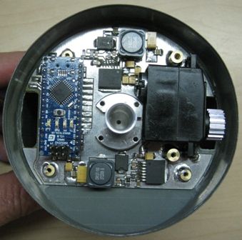

      Here are a few more pics of our Unmanned aircraft designs and activities – we have 7 different type, ranging from 3kg up to 47kg, but instead of all the aircraft here are some photos, more engineering oriented, of the Day/Night Gimbal I designed for one of our aircraft. The gimbal weighs 260grams, fits in the nose, is gyro stabilised and steerable by the ground operator/observer – and some photos of the plane that carries this gimbal.

      The controller electronics in the gimbals
