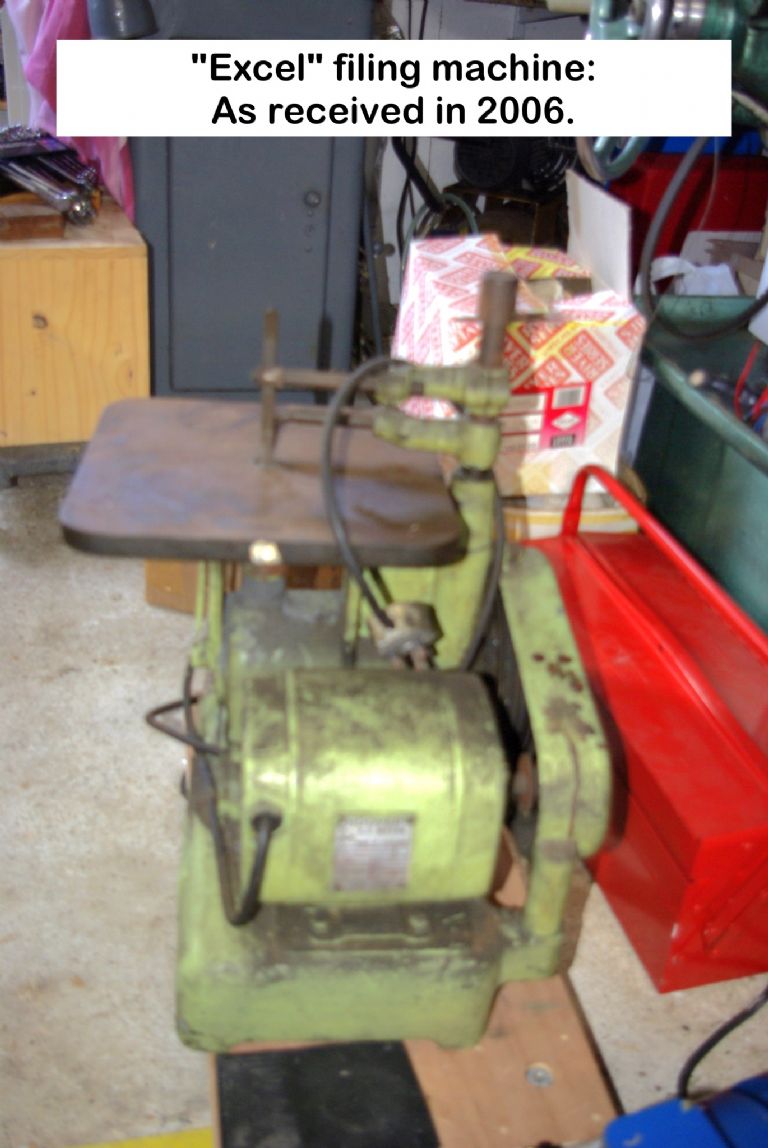

                                    #295822
                                    OuBallie
                                      @ouballie
                                      This beauty made the square handles for the Boxford shaper.
                                      A dream to use.
                                      Excel Filing Machine
                                      Geoff – Took me ages to find one.
                                      #295850
                                      Mike E.
                                        @mikee-85511
                                        I can relate to it……. "Took me ages to find one". Your Excel looks like a nice compact machine. It would be interesting to see a close up of how the upper end of the file is supported by the extended arm ?
