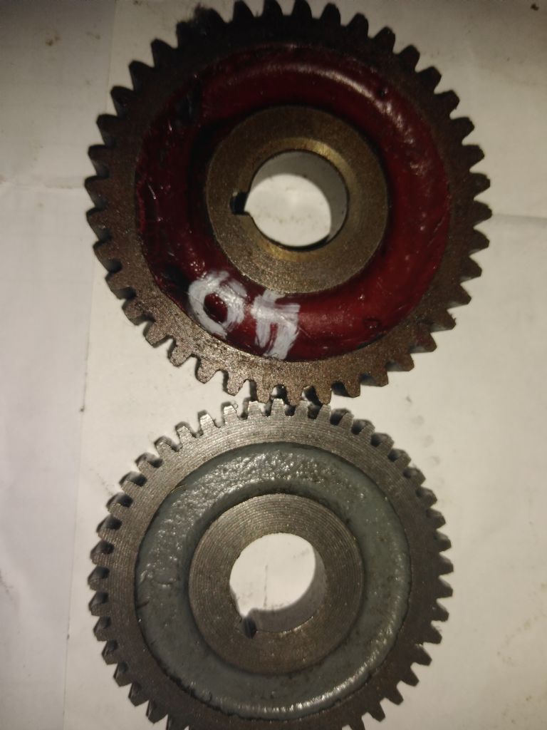

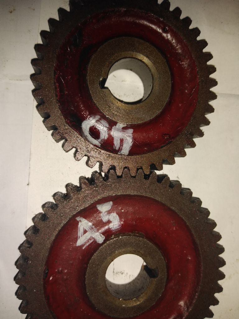

                    The change wheels are actually 16DP, not 20DP like a Myford. I have a collection of both as shown below. They don't mesh!
                    Here are some Portass change wheels

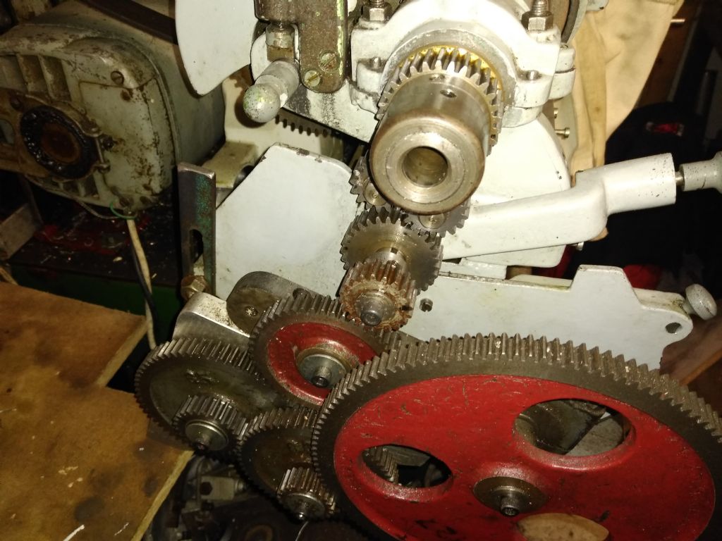

                          As you say the Portass ones could be hard to track down as a complete set. Myford gears are easier to obtain, but at 20DP are smaller. This could be a problem since the mandrel diameter on the Dreadnought is probably bigger than the Myford and has a 30T 16DP gear fitted. I am not sure what a Myford has but it is probably too small to fit the Portass mandrel, unless you were to make a stepped adaptor of some type and a home brew set up to mesh the tumbler reverse. It could get a bit clumsy, having said that most things are possible.
                          Here is the Portass arrangement, albeit with a modified change gear bracket to take a couple of extra studs.
