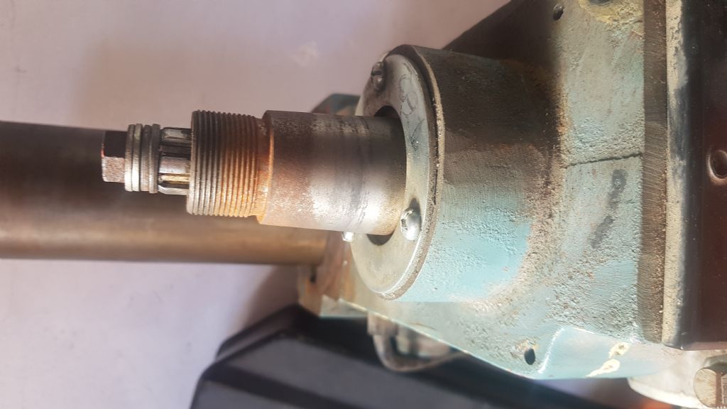

              Wow , thanks gents. So the shaft on my mill is tapered from 38mm
              To 41mm using section A belts and should be 4 step.

                    A tapered bore makes it much less likely anyone will have a suitable pulley. I have have one pulley with a tapered bore but it is undersized and lacks enough meat to be bored out to your required size. In any case, you'd also need to specify the taper dimension.

                      How about turning an adapter (tapered bore onto plain shaft) then using a single groove pulley? It might get you going until something better comes along.

                        Yes i would be willing to to turn the centre out of
                        A pulley. Do you have one suitable ?

                          Guessing that the machine is a RF20. The securing nut for the pulley on the spindle is likely to be Left had.
                          The pulley for the spindle will have 4 grooves.
                          The pulley on the motor will have four grooves as will the intermediate pulley.
                          In this way the machine mwill mhave 12 speeds.

                            https://cdn0.grizzly.com/partslists/g0705_pl.pdfThe picture looks a lot like the museum's drill mill pulley fitting. The thread on that is left hand and there is no key. I downloaded a Grizzley manual pdf for one of their mills and it is very similar.
