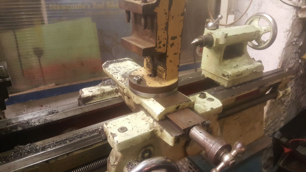

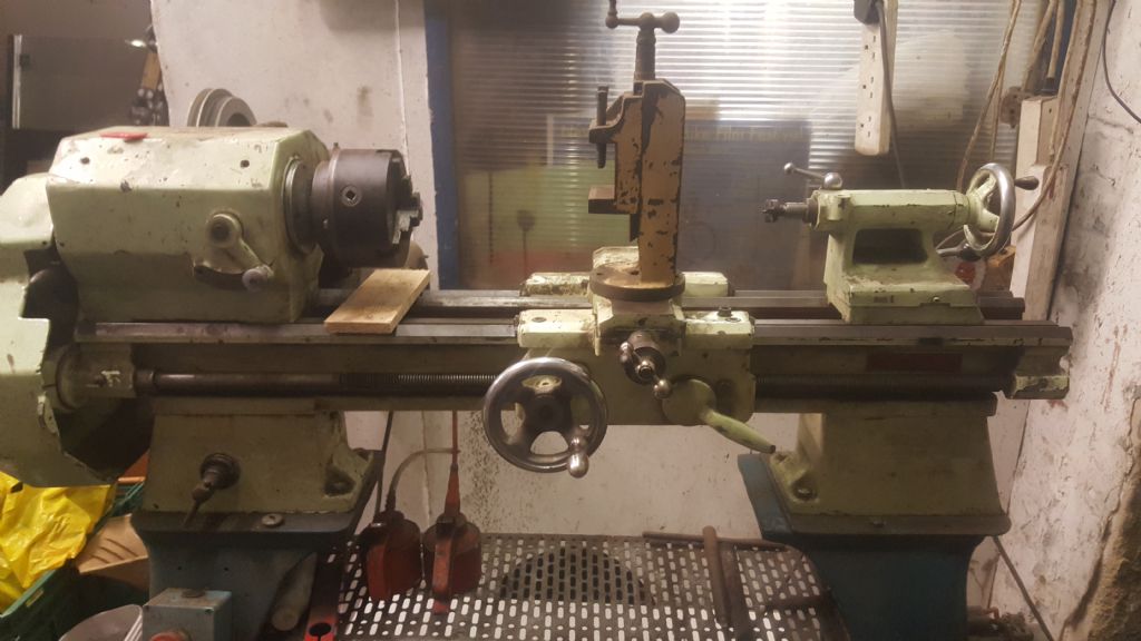

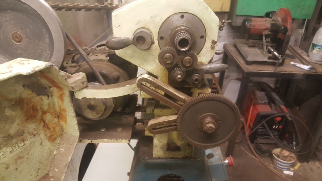

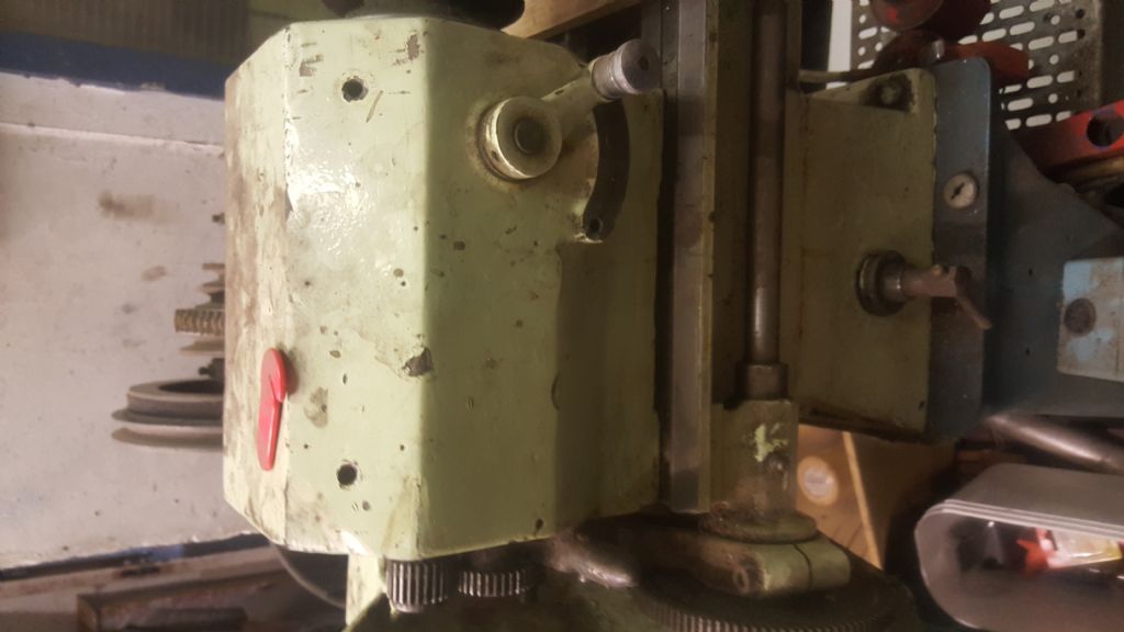

      Hi there I was wondering if anyone would be willing to help me identify an old Boxford lathe. My Dad swapped it for a van over 20 years ago and it has sat in the workshop ever since, it has been used for a few small projects but basically has been gathering dust. Unfortunately we have lost contact with the old owner and I therefore have no one to ask questions about it.

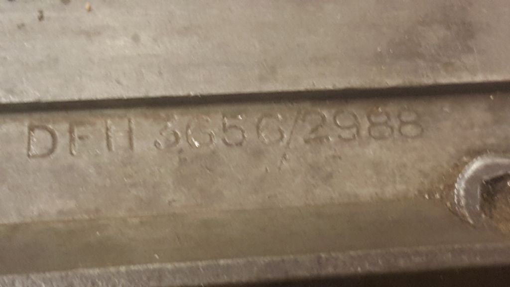

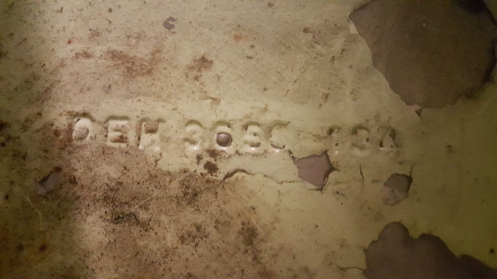

      I have been looking through the Boxford section on lathes.co.uk and from the serial number I believe it to be from the early fifties but It doesn't look quite like any thing else on there to my uneducated eye. It would be great to find out what it is and finally give it the attention it deserves.
      It doesn't seem to cut too well sometimes and I'm unsure as to wether this is down to newbie tool grinding/incorrect speed or just the wear and tear that must be present on such an old machine. It does have alot of backlash on the compound slide. Apparently the bearings in the headstock were replaced before we got it but I don't know if this is true

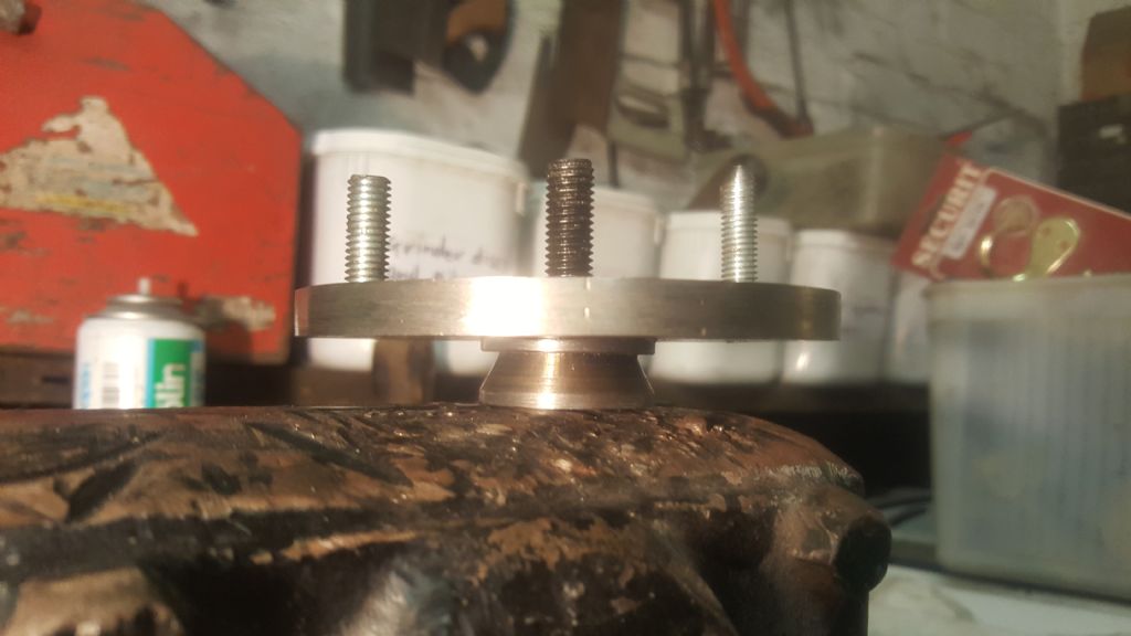

      I did manage to make an adapter for a milling attachement but I've pretty much decided to leave it be until I am more knowledgable, so as not to cause damage. I'm reading and youtubing like crazy
      So my other question apart from identification is this, If you owned this lathe and had pretty much no money to spend on it for the time being, what would you do with it in terms of restoration/care?
      I have taken some pictures of the lathe and its two serial numbers (I believe the one on the bed is the correct one?)
      I would greatly appreciate any help with this.
      Many thanks, Charlie20160809_164226.jpg20160809_164453.jpg20160809_164259.jpg20160809_164243.jpg20160809_164550.jpg20160809_164605.jpg20160812_133833.jpg20160812_133211.jpg

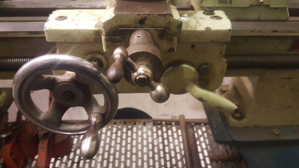

          Looks like a model C as it doesnt appear to have powered crossfeed .
          #250724
          Bazyle
            @bazyle
            It is the early bench mounted rear drive model C. ( screwcutting gearbox would be a model A, power cross feed is a B) The version before the more compact rear drive and before the under drive versions popular in schools. So yes it is from the fifties.
            It has a vertical slide on the cross slide for milling instead of the normal topslide. Do you have that aswell? There is one on ebay at the moment. The motor plate makes it sit rather well away from the wall but acts as a sort of clutch isf you fit a handle to the cam actuation rod that comes through to the front. Do you have a second set of jaws for the chuck?
            The legs are from something else.
            Nice lathe and worth sorting out.

              The vertical slide came with the lathe and I made the attachment, a milling machine even if only for small parts is sorely needed in the workshop.

              The thing that worries me most id the missing grease nipples from the headstock, is it possible that if the bearings were replaced, sealed ones were put in meaning no grease is needed? wishfull thinking?

                  Model C from 1950/51/52 (confused numbering during that period).
                  More information available on the Boxford Lathe group on Yahoo,
                  e.g. Parts list, manual, images of things like the missing speed
                  setting plate on the headstock.
                  If your “faceplate” has one open ended slot then it is probably a catch plate
                  for driving work between centres. The face plate has 6 or 8 closed end slots.
                  Regarding the grease points. If “lubricated for life” bearings were fitted then yes, no grease would be needed, however if there are broken remains in the holes then they need to be extracted and new grease points fitted.
                  Be wary of using the belt tensioner as a clutch (we all do it) as the belt can occaisionally catch and spin the chuck just when you don’t expect it (guess how I know .

                      The holes are clear and I found one of the nipples in the box of bits, I also found a set of bearings near there which I suspect may be the new ones, I'm away from the workshop just now but I intend to see if there is a part number stamped on them, they may have nothing to do with the lathe.

                      Do you know what kind of depth of cut/speed this thing should be capable of? I had it cutting nicely but slowly on the smaller piece of that milling adapter but the bigger lump was difficult, it seemed to be pulling the tool in ever so slightly and the chips were much shorter and blue. Could well be the speed..

                            Before you put any grease in the grease nipples make sure they are not oil nipples.

                                Looks like a CSB. These were basic lathes made for the education market, mostly secondary schools. I have one of these as well as a later BUD (UD – Under Drive). I must admit that I prefer the Bench mounting of the CSB (and other B and A models intended for bench mounting).
                                These are sound, capable lathes and if from a school may have dints on the bed etc but will probably have little wear as they had only limited use generally and with care the dints can be stoned out. Collets and draw bar generally sell for a good price especially if you have the collet adapter for the spindle and spindle nose protector which screws onto the the spindle nose thread. I use a different collet system i.e. the ER 32 system. Do You have a compound slide and toolholder?
                                If there is no play in the head bearings, I suggest you leave well alone they have taper roller bearings back and front. There are instructions on how to set the bearing pre load in the parts lists for these lathes, available for members in the files section on the BoxfordLathe_UserGroup on Yahoo. The excellent 'Know Your Lathe' Book is also available there.
                                I would personally not use the rear drive belt as a clutch – and I still have all of my fingers. As a lathe user for over 50 years I have seen all sorts of mods which have been made to these machines – most of them dangerous, if the manufacturers had thought it a good idea they would have done it believe me.
                                Do You have any gears to drive the leadscrew? If not I may have some duplicates I could let you have at a good price, message me and I'll have a look see. Otherwise they are again usually available on eBay. Don't buy a whole set, just the ones you need as you get a bit more experience.

                                  Boxford have been a bit mixed on greasing spindle bearings. Sounds like you need to remove the covers if you want to do it. It's possible to poke a bit of what is in out and put some fresh in. In some ways you will be lucky if it's not been done before as the bearings shouldn't have much grease in them. They usually have loads though. Not something to worry about.
                                  The back gear bearing is likely to need lubricating as well. This is probably under a grub screw in the spindle pulley. There are parts diagrams on the yahoo group. If no model C I believe that the general set up is the same as my ME10. The oil holes in the counter shaft are pretty obvious ( shaft driven by the motor)
                                  If you want to make a start at cleaning it up a simple way is wire wool and paraffin or better still one of those green plastic kitchen scouring mats that sometimes come on sponges. It's a good way of getting rid of old gunk but wont usually make much impression on rust. I'd use this on all of the slide ways and gib strips which means dismantling them. Then ideally slide way oil which can be bought off ebay etc. Then adjust the gibs carefully for a tiny bit of friction at the handles. They don't want to be too loose. When you wind the cross slide right out you may find it stiffens..It's usually the first thing to wear on any lathe. If so it's possible to reduce the stiffening a bit by messing with the outer screws. It's not unusual to have to adjust the gibs several times as the lathe is used and things settle down.
                                  The headstock bearings are preloaded and many people have no luck at all with the boxford method shown at the end of the parts manual. It is worth try though. Sound like you have run the lathe so give it a try. If it's low run the lathe at it's highest speed for 15min or so and try it again. If – when you have stopped the lathe – you put your finger in the back under the rear bearing you should be able to feel some heat. Nice and warm but not hot is how I would describe it. In the end this is how I adjusted mine but remember that it will take 15min running or more for the lathe to warm up and the inside of the spindle doesn't want to feel hot. The adjustment nut on the end of the spindle is sometimes rather tight due to the bearing fit they use. It can be tapped round a tiny bit at a time with a drift and hammer. The grub screws that lock it just need loosening. If your remove them you'll probably loose one of the white metal pads under them like I did. Each time you make an adjustment do some heavy turning or drill a big hole. That will tend to make sure the front bearing is home. It's a slow process thanks to that aspect.
