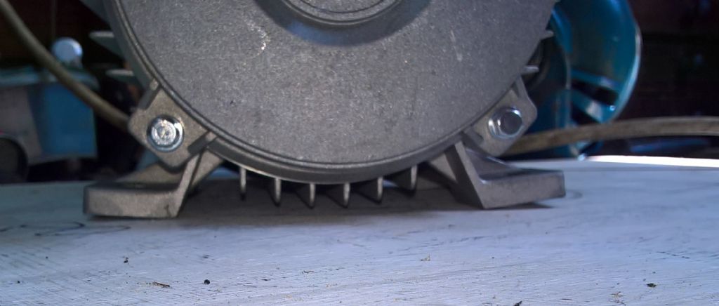

                        I have also noticed the foot of this motor does not stand flat as in the photo.
                        I made a video of it running Youtube of motor noisy or what!  ( enable sound in top corner of video)

                          It looks like it has been dropped at some point. There is possibly some contact between the rotor and the internals of the motor as a result.

                            That's just horrific, they really have sold you a complete lemon. In the video it doesn't appear to be running at full speed, or is that just a trick of the camera?
                            Clarke motors used to be made in Italy, are they still made there? Yours looks like one of the Italian made motors.
                            The misaligned feet are impressively bad, I think they are cast integral with the motor body on these motors. I wonder if someone has dropped it, or dropped something on it, they could be bent rather than actually cast and machined as bad as that.
                            Although I have seen these motors fitted by people to lathes and pillar drills, I do remember many years ago the Machine Mart staff being reluctant to recommend the Clarke motors for fitting to anything other than a compressor, as Dave Wootton as already mentioned.

                              There is no damage on the cardboard box and the motor was sat in styrene blocks, must have been dropped before it was packed. The box is just a standard box, not one with Clarke or it's contents mentioned so probably packed by PowerTools direct themselves
                              The motor is going full speed, 1420 rpm. it clashes with the video frame speed  as does old western films when the wheels appear to go backwards.
                               It was apparently made in Italy according to their website

                                  Hi Vic, with bent feet like that, I would be asking for a replacement or a refund before even attaching any electric wires and trying it out.

                                    Are you certain that the motor really is a new and unused item? Is the keyed shaft unmarked, or is there any sign of marks from nuts, washers or bolt heads around the feet mounting holes which may suggest it has been mounted and used before, resulting in some damage?
                                    It came in a standard box, but Clarke products usually come in a Clarke marked box, however my nearest Machine Mart store does have a habit of always removing the original Clarke packaging and stacking almost all stock items on show in their store. Not sure if Power Tools Direct do the same.
                                    Over the years I have had my fair shair of various shops trying to sell me what they claimed was new, but was clearly used. Items such as a car battery, caravan battery, mobile phone battery, torque wrench, and classic bike engine parts.
                                    So although it's still fairly unlikely, it might be worth a close look for any signs your motor is not quite as new and unused as it should be.
                                    But in any case, you are certainly entitled to a replacement or refund for a motor in that state.

                                      I'm fairly sure the motor was not used before me but can't be certain as there are no marks to indicate otherwise. No evidence in the connection box that it's been wired up etc. I'll see what they say tomorrow re a refund or risk a replacement motor

                                        Although the motor was bought from PowerTools Direct they contacted Clarke headquarters who sent a courier to collect it. I didn't get to see Clarkes response after examining the motor but they didn't offer to send a replacement.
                                        Powertools office were excellent all along and have given me a full refund inc shipping. I've now had the old Brook Crompton motor refurbished and it's running o.k.
