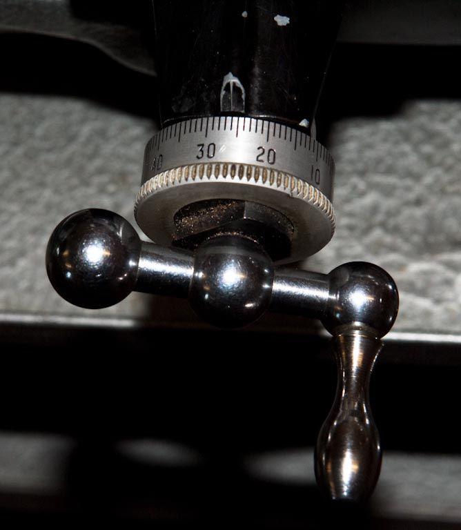

                One very worthwhile job I made was to add a leadscrew clutch. I think this is ( was ?) available as an accessory but pretty easy to make up yourself.  It was particularly useful as the drive train can be disconnected to allow use of the handwheel on the end of the leadscrew to move the carriage. The tumbler reverse I purchased as a kit of parts.
                The re- settable feedscrew dials were also purchased and made life easier.
                CROSS SLIDE DIAL
                The one on the leadscrew I made- but as the dividing head I had access to could only give 124 divisions rather than 125 there was a small error ! ( It was never a problem wink )
                LEADSCREW DIAL
                I hope you enjoy your machine – it is simple but capable ( far more capable than me I'm afraid! )
