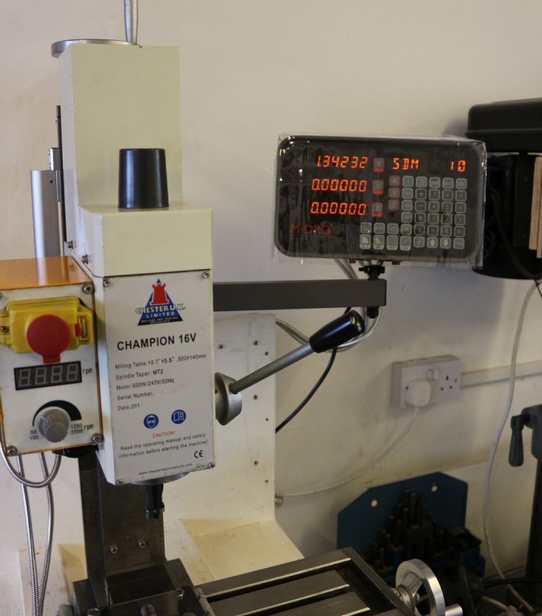

      For every inch movement of my milling machine X axis via the handwheel, the actual movement is short by 0.015". That is fine for some parts but not so clever if I am trying to make parts like locomotive coupling rods. So as it was quite close to my birthday, I splashed out. Look what I have got.

          That does beg the question of how can the feed screw be that far out? Or has the dial a peculiar number of graduations on it?
          #485670
          Martin Connelly
            @martinconnelly55370
            0.0157" is the difference between 1" and 25mm (to 3 sig figs). Is it a metric machine?

                  Martin/ Mark,
                  Your observation certainly makes sense (0.0157&quot but it definitely states 0.001" on all the dials and it was sold as an Imperial machine. However, perhaps all the Imperial machines are in fact metric but with very poorly executed handwheel conversions? If you look closely at the front plate (it is a bit small on the picture) – even the table has inch sizes rather than metric.

                    Quite common for 'imperial' mini-lathes to have metric lead-screws and rely on the close correspondence between 0.001" and 0.025mm ( 0.000984" ) For close up work, the error is insignificant, the error only shows up when the dials are moved a long way. Much more annoying on a Mill though.
                    Don't worry about it. DRO on a mill completely eliminates metric vs imperial issues and there are many other benefits. It's hard to understate the value of fitting a DRO to a milling machine – they really are wonderful.

                            Now that the possibility of a metric leadscrew has been raised I am all curious as to whether it actually is. I think you owe it to us to move the table 2 'inches' according to the dial and say what the DRO reads. While your problem is solved with the new toy there must be many users of this mill still without one who need to be told of the possible error.
                            If it is actually a metric screw I thing the vendor owes it to the owners to write to them and inform them.

                                I tried the measurements and I am still laughing. This is honestly true – I am not proud of this admission but here goes;.
                                If you read the Y axis dial, it goes from 0 to 0.080" in nice even 0.001" increments.
                                If you look really carefully at the X axis dial, it is almost an exact copy – but not quite. Going from 0 to 0.070" is fine but you expect the next 10 divisions to take you to 0.080" No – it doesn't. There are 9 divisions!!!! taking it to 0.079"
                                Using the DRO and comparing – 1" (DRO) = to 0.986 dial (12 revs + 0.040&quot and 2" (DRO) giving 1.971" dial (a further 12 revs + 0.040".
                                If I wake up, open my eyes and do it properly I get X axis 1" (DRO) = 0.9986" dial and 2" (DRO) giving 1.994" dial.
                                Y Axis – DRO 1" = 0.996" dial and DRO 2" = 1.993" dial.
                                So it is operator error but how ridiculous – a 079" dial!!!

                                          2mm pitch leadscrew.
                                          It is a metric machine fitted with imperial dials. Odd ones, but imperial dials.
                                          My mini lathe has a 16 tpi leadscrew. So I made a 64-division dial to approximate 0.001" but only use it over short distances as a 62.5 division would encourage false confidence.
                                          Ironically If I had the 1.5mm metric leadscrew, a 60-division dial would be more accurate..

                                            It really is difficult to complain because it does work – just a bit strange and why does the cross slide (Y axis) work ok?

                                              Just for completeness, there is nothing in the manual about the leadscrews or handwheels. There is an exploded view and parts list and the leadscrews are simply listed as X axis spindle, X axis nut and Y axis spindle and Y axis nut.
