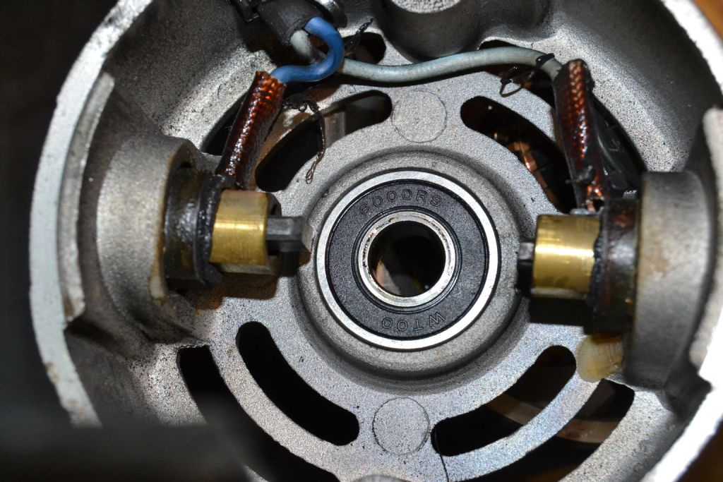

      I hope someone can help, I've only owned my Chester DB8 lathe about 8 weeks but this morning it's started running erratically like car misfiring particularly at low speeds.
      At higher speeds the speed seems more constant but the machine shudders, my initial thoughts were it appeared to be an electrical rather than mechanical fault but I'm not certain.
      It worked fine yesterday and hasn't had any rough treatment today although for the last day or 2 the cuts I make seem to have had a poorer finish
      Thanks
      Peter.

          If its a brush motor check for sticky brushes, well known fault on Chinese gear.
          #198737
            That was my thought two, one brush can stick and the motor runs irratically. Also the sparking softens the spring and melts the copper wire or its solder

              If it helps any more, I've just fired it up again and it wouldn't start turning till I turned the speed potentiometer to about 1000rpm. Once it was turning I could lower the speed but it was very erratic.

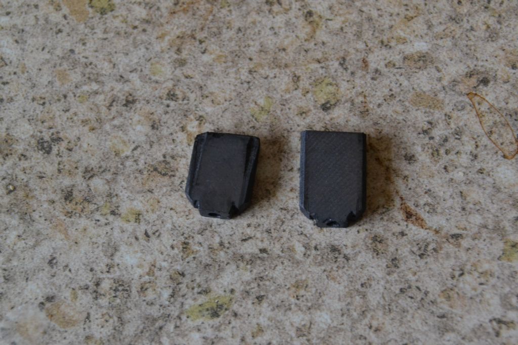

                  Thanks guys, I've solved the problem at least for now and you've made 1 man very happy
                  It was a problem with the brushes as you suggested, one was worn far more than the other and the contact wire that run through the springs were in a poor twisted shape.
                  I've straighted out the contacts, and given things a bit of a clean and it works fine now. I'll order a new set of brushes / springs etc from Chester on Monday but the repair I've done for now should tide me over for a few days.
                  What initially I thought looked like a disaster actually turned out well, it gave me chance to familiarise myself a bit more with the machine and generally check a few things seem to be running ok.
                  Mike, you are right it will be under guarantee but I thought I'd ask here first in case it was a job I could fix myself as was the case. When I speak will Chester I'll see if they send the spares free, if not I'm not going to haggle over a few quid, I'm just happy it works ok.
                  Here's the state of the brushes :-

                                  On such a new lathe the difference in brush length is bad, unless you have used it for 200+ hrs ! Also the shorter brush does not seem to be rectangular. I think the problem is deeper, is the brush holder OK? Also the springs seem excessively "thick" i.e. excessive contact pressure.
                                  You can use any (larger) mains type brush providing you can use or fettle the spring and contact . They "sand" down easily with sandpaper, though a rather messy job to do.

                                    The springs in the first picture aren't from my machine.
                                    Peter.

                                      Hi. Just reading through your post. I will be more than happy to supply you a couple of new sets of brushes, they do come complete and ready to use, it doesn’t happen very often but now and again you can get one imperfect one that crumbles causing it to wear very quickly, I think this might be the case here. Luckily lots of helpful people on here to offer advice. Please send be a pm with your full name and postcode and I will get these sent on Monday.
