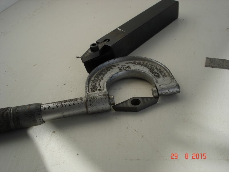

      Neither listing states the insert tip radius and this radius affects the surface finish achievable, although of course other factors have to be taken into account. The last 2 digits (07-04-02) normally state the tip radius so 02 is .20mm rad and then 04 and 08 are .40 and .80 mm rads.
      Ground finish Grade H10, H13 inserts will give the best results on non-ferrous metals and plastics.

        1. There seem to be quite a number of various shapes and sizes when it comes to replacement tips for indexable tools. Which is the most popular shape/size ie. the most readily available ?
        2. I have found a company here in Cairns who will order in a green wheel for touching up carbide tip tools (not indexable tools). What size grit should I order : 60 grit or 100 grit ? The sales person said that the 100 grit is VERY fine and he was not sure if it is suitable. They cost $25 each.

                    The 2nd link types are fine Brian. I use them but on the 10mm / 3/8" holders. You don't want to buy that set though. Look for ones that come with a torx wrench. The tip fixing screws are far to fine for a modern poorly fitting hex key and the keys round over in no time at all. I would suggest 10mm holders too if they can fit your lathe but from the spec you would need to buy a new tool holder. The one that comes with the lathe seems to be aimed at 5/16in tooling but an odd metric equivalent that comes out at 0.309" +0 -0.012".
                    The tips on them are old hat though now. You should find a source of tips like these to replace them with at some point.
                    **LINK**
                    The triangular tips can be used to work up to and finish shoulders – not so the square ones. The rad on the tip is pretty small so the shoulder can be relived by plunging the tool in a little.
                    The same style for stainless finishing works well on all materials too but those are coated and the finish does fall off when the coating wears. I intend to try the micro polished aluminium ones on other materials and don't see what they shouldn't work out. Not done yet as I am in a no more work phase until I have completed a very thorough clear out and tidy up. There is some brass work in my photo album done with the stainless ones and no polishing etc. Also the same tip on silver steel showing micro tearing that would polish out very easily. The marks are only a couple of micron deep. It's pretty junky silver steel. The place I bought it off where getting rid of it.
                    I've found that a 60 grit green wheel is fine for braised tip carbide tools if the tool is moved side to side to finish off. I don't use these much now but did use them a lot. I have green grit on one wheel and a medium grit ordinary wheel on the other for hss and also relieving the tool steel under the brazed tip carbide tools when these were reground.
