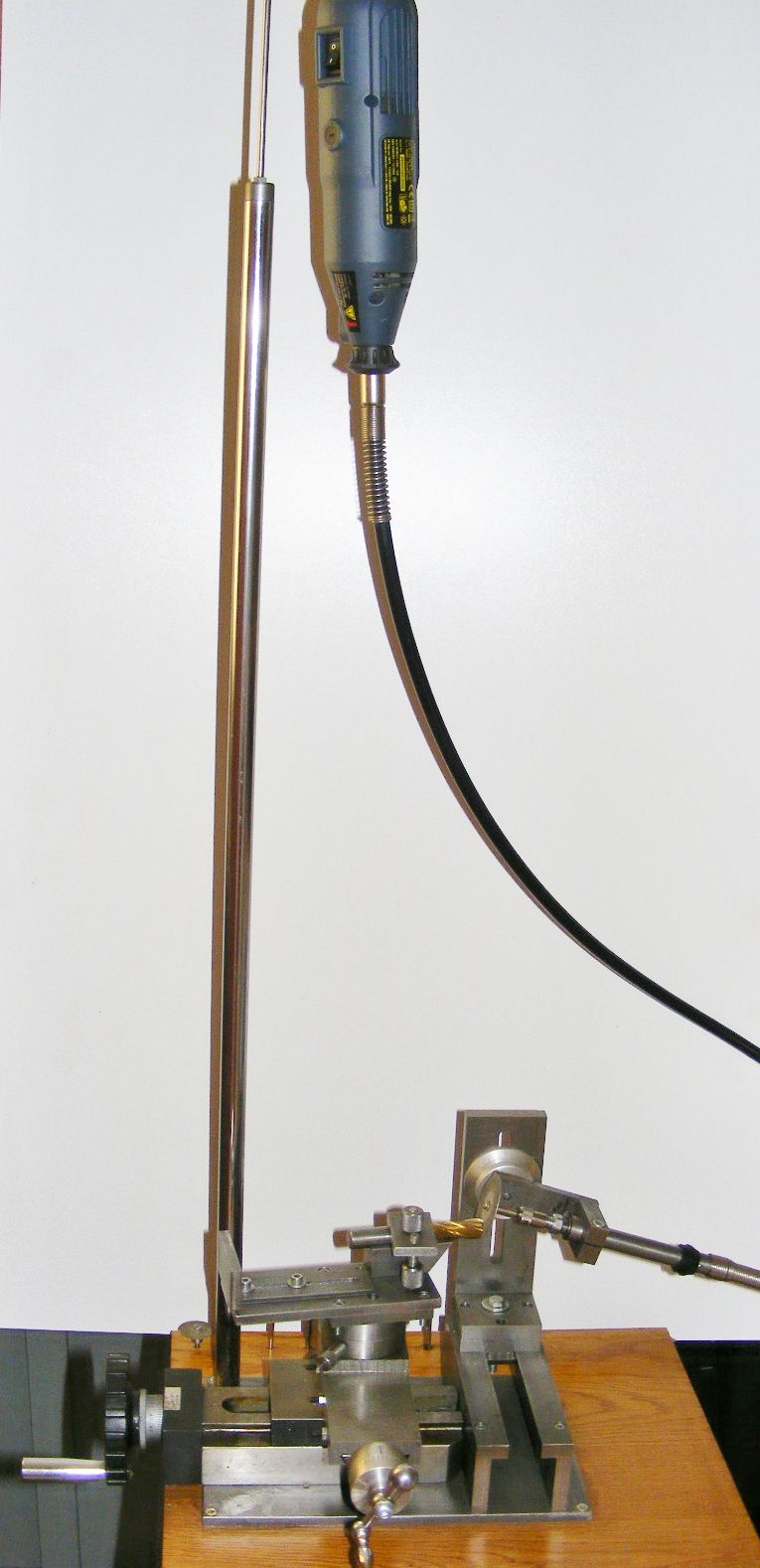

        Michael Cox 1
          @michaelcox1
          My first attempts at milling were carried out on my minilathe using the Seig milling attachment. This is not a very satisfactory milling attachment. A good criticism of it is here:
          http://andysmachines.weebly.com/the-vertical-milling-slide—criticisms.html
          I persevered with it for some time and managed to do some milling but in the process I broke/chipped several milling cutters. These breakages were partly due to the sloppiness of the milling attachment, cross slide and coarseness of feed but mainly due to inexperience. The lessons I learned from this were:
          a. I needed to buy a milling machine
          b. I needed to make a cutter grinder in order to recover broken/chipped milling cutters
          I purchased an X1 milling machine from ArcEurotrade and almost instantly milling became much easier.
          At around the same time there was an article in MEW by Ralph Sparrow (MEW 117 July 2006) entitled "Sharpening with diamond discs". In this he described a jig that held the head of a flexible shaft, attached to a rotary tool, at an angle that could be readily set. This was designed to fit on the bed his Unimat lathe and using this set up and a small diamond disc in the flexible shaft head he was able to sharpen lathe tools, milling cutters and twist drills. These diamond disc are readily available from several suppliers including Arc Eurotrade. This all sounded very good and I went on to build this lathe attachment and various jigs to hold tools, milling cutters and drills. My rotary tool flexible drive was from ALDI and the head had much end and side play. I had to rebuild the head of the flexible drive in order to be able to rotate the diamond disc reliable without wobble or end play.
          I used this arrangement on my lathe for some time and produced some good results sharpening all my broken/chipped milling cutters. It was even possible to sharpen cutters as small as 3 mm diameter because the diamond discs had a very well defined edge. The only thing I did not like about the arrangement was all the dust flying about so close to the lathe.
          I had made a lower base for the topslide of my minlathe and I had the old one spare. I also had the old minilathe milling attacment and I started to think about making a dedicated cutter grinder based on these components together with the Ralph Sparrow attachment. I ordered the the top part of the topslide from Clark (it is a Clark minilathe) . I used the milling attachment to provide the infeed and the topslide to provide the crossfeed and made a small fabricated track for the Ralph Sparrow part.
          The completed cutter grinder is shown here:dscf2320.jpg
          The milling attachment and the topslide are clearly visible. On the topslide is a rotating table that holds the jig that holds the cutter. The rotating table has a an angular scale and it can be locked at any angle by pinch screw. The Ralph Sparrow attachment is on the right hand side carrying the flexible shaft head. This sits on the fabricated track.
          The unit is small with a footprint of about 300 x 300mm.
          I hope this is of interest to others.
          Mike
