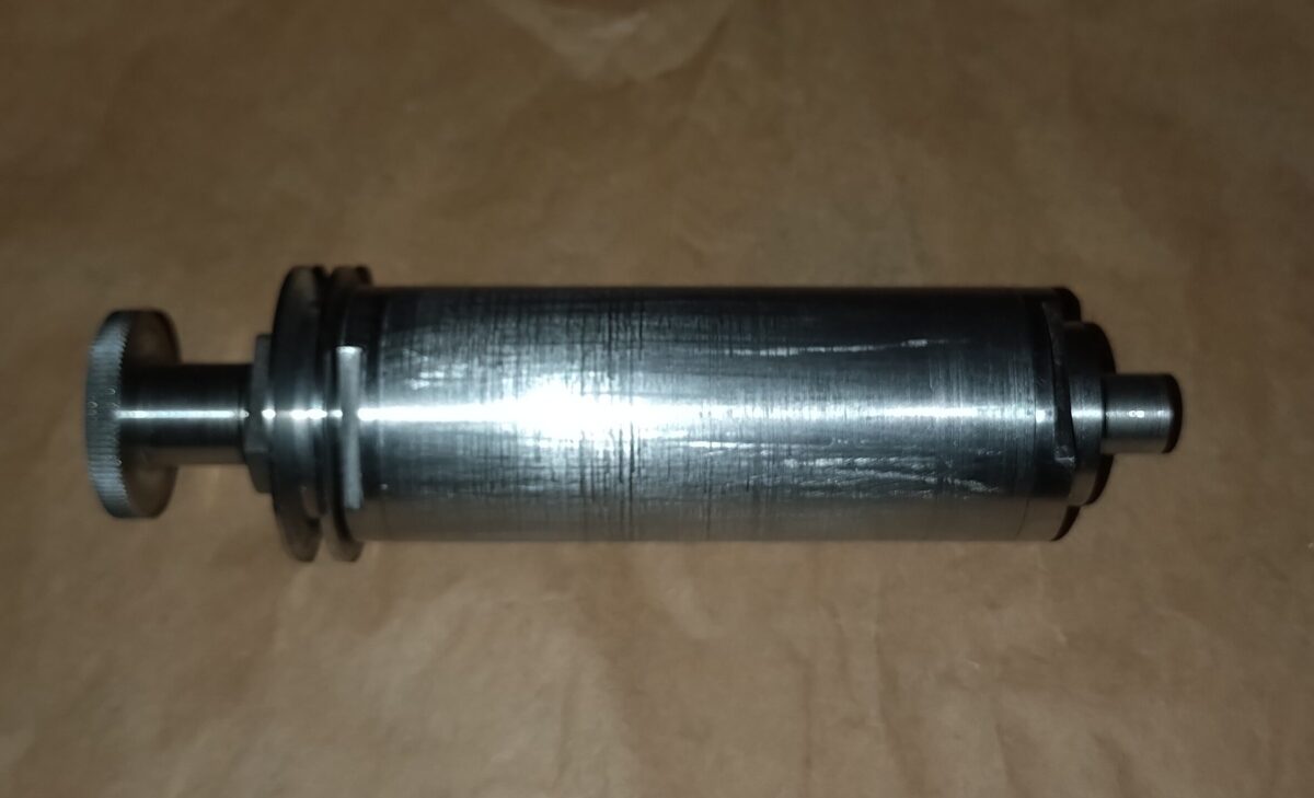

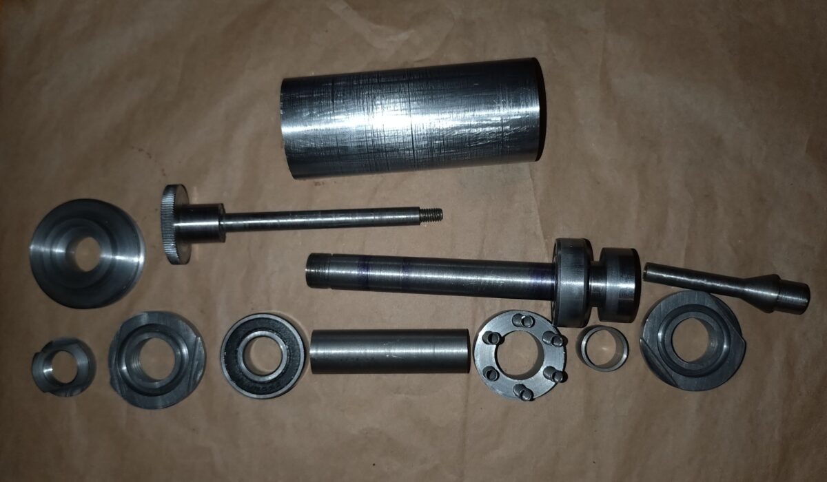

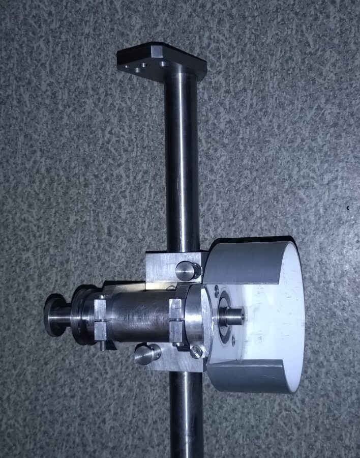

              What, you thought you got rid of me? Fat chance, I just don’t do much machining during the summer.
              Here’s the progress so far:
              20231209_194626~2
              20231209_195210~2
              #698781

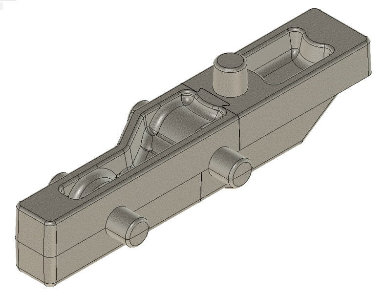

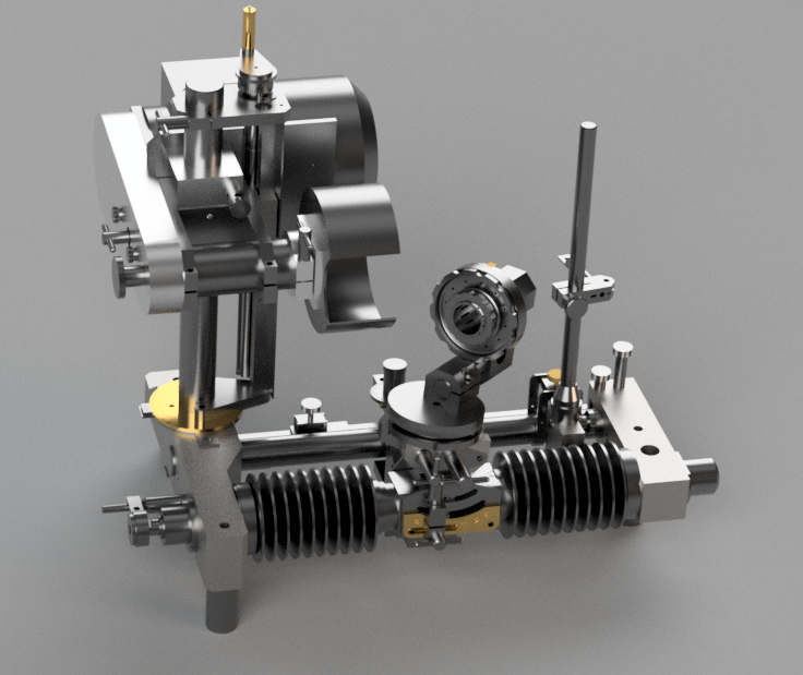

                          #757853
                          Fulmen
                            @fulmen
                            Fall is upon us again. The boat is back on dry land and there isn’t much left of the bike season, so time to crawl into the machine shop again. So far I’ve almost completed the Wheelhead Assembly with the exception of the motor mount.
                            My initial plan was to machine the base from cast steel, I even managed to source a very large chunk of CI before I had a change of heart. There is just so much metal to remove. So I’m slowly gearing up to do some aluminum casting.
                            Here’s the pattern for the main base:
                            I’ve made a few test molds in green sand, and I think I’m starting to get the hang of it. I even managed to cast a few parts in pewter as I haven’t made the furnace yet.
                            I’m more or less finished with the modelling:
                            This project is a beast. I think my last parts count was 136, so I won’t lack anything to machine for the foreseeable future.

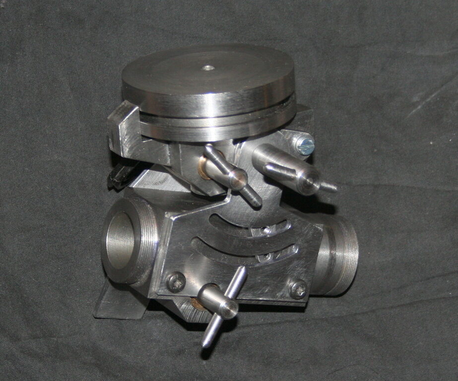

                                              #767539
                                              Fulmen
                                                @fulmen
                                                The work head is almost complete now. Still need to make the front scale and engrave the roating base:
                                                #767589
                                                Wade Beatty
                                                  @wadebeatty78296
                                                  Looks very nice Fulman
                                                  #767638
                                                  Fulmen
                                                    @fulmen
                                                    Thank you, it is immensely satisfying seeing this come together.
