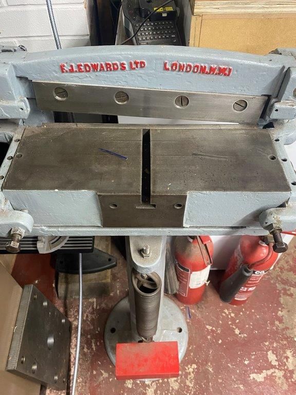

                            Possibly it is worth looking on Ebay for a guillotine similar to that shown below. I accept it is floor mounted but you could possibly move it around.
                            Colin
                            This one really needs bigger pedal but I have not got round to it. You could set depth stop at front and feed in from the rear.
                            Colin

                                    Colin Heseltine
                                      @colinheseltine48622
                                      John,
                                      Yes it is mine.
                                      Up to now I have only used it for brass and steel shim stock. Originally the foot pedal would have been like a brake pedal on a long arm and would give much more leverage that the step type pedal fitted by previous owner.
                                      To be able to try 1mm material I may need to bolt it to floor temporarily. I am a bit stuck for space so cannot put a large plate on the base to stabilise it.
                                      There is a slightly smaller version of it for sale on Ebay at the moment item#125110115176 (£90 or best offer)

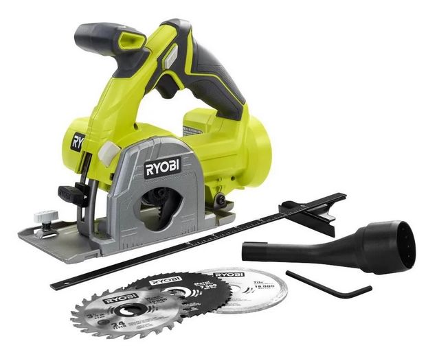

                                              Paul Lousick
                                                @paullousick59116
                                                Ryobi sell a 18V Cordless Multi-Material Plunge Saw which accepts 3 3/8" dia blade blades for cutting wood up to 1" thick, ceramic tiles and thin sheet metal.
                                                I recently used one for cutting 20mm MDF and 3mm plywood and is recommended. Comes with an adjustable width edge guide. Often on sale for the tool only (if you already have a battery) from Aus $79.00. It needs the larger battery for bigger jobs.
