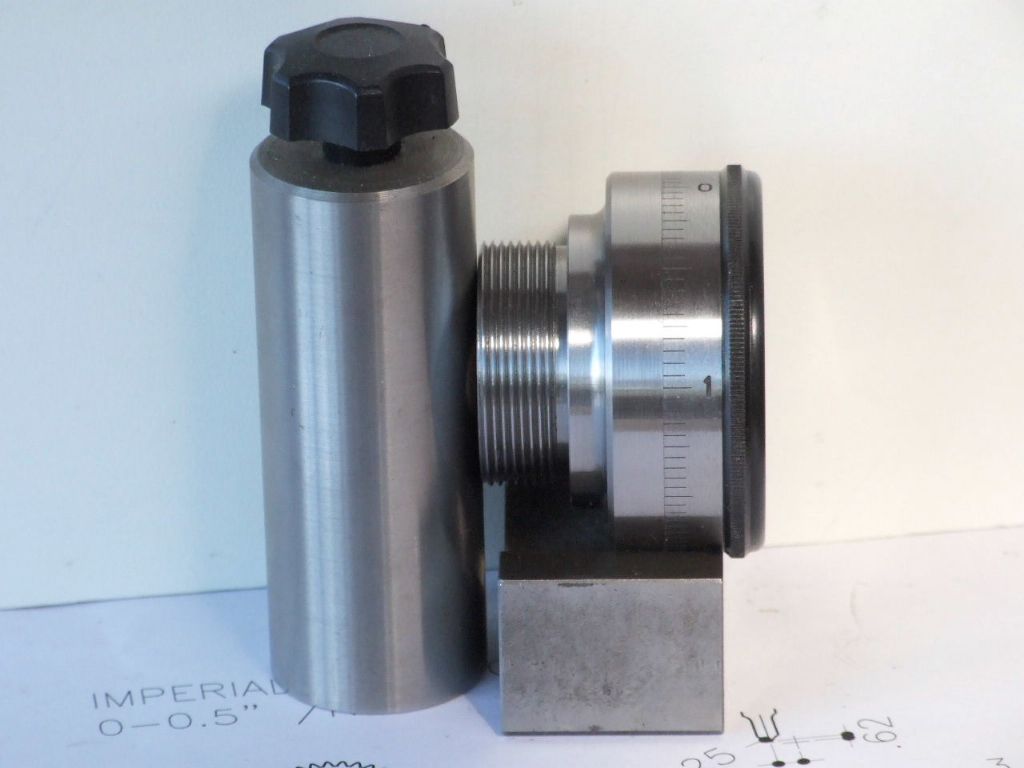

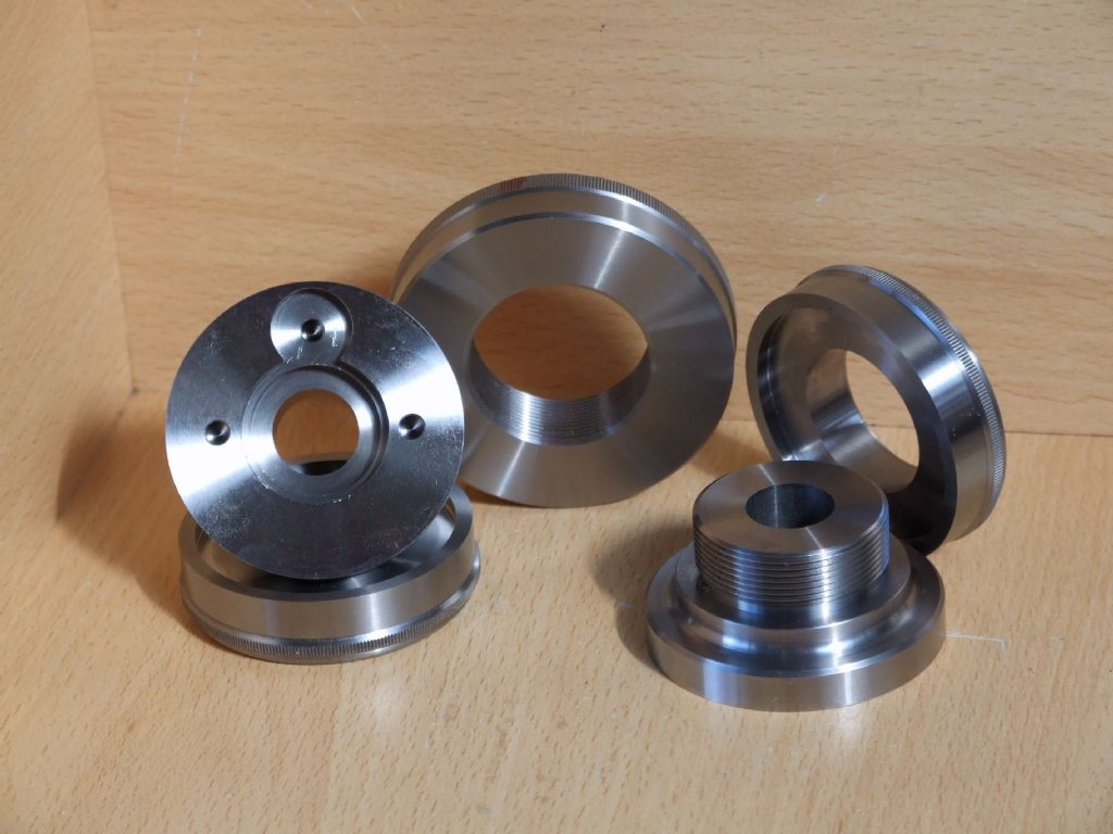

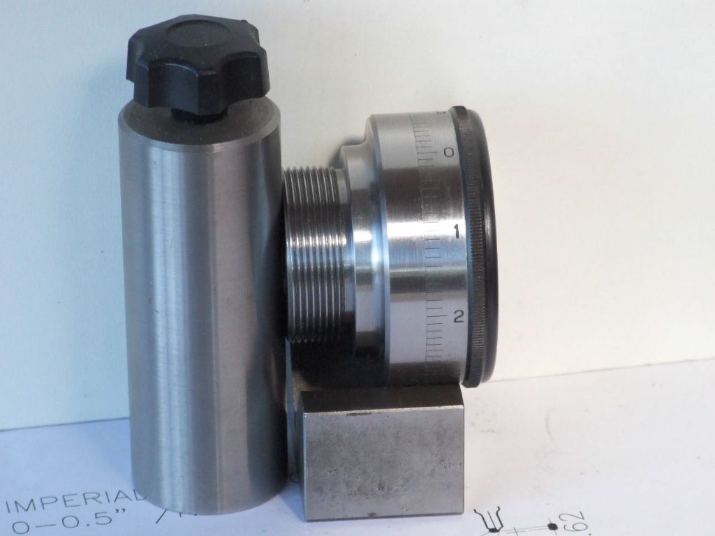

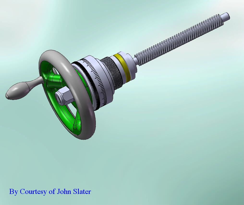

                            #375390
                            Graham Meek
                              @grahammeek88282
                              Just thought I would update the forum on the progress of the Prototypes. I have been lucky in that John Slater has produced some lovely 3D images of the Dial conversion. I could not have done this project without his help, KWIL's, and that of Michael M who initially asked if I had done anything about the S7 Tailstock Dial. Which in turn started me thinking about the problem and this attachment.
                              I have also been told from several sources that the difference between the tailstock Mk's is all down to the position of the Barrel Locking Lever. Horizontal means it is a MK1 and vertical being a MK2.
                              Regards
                              Gray,

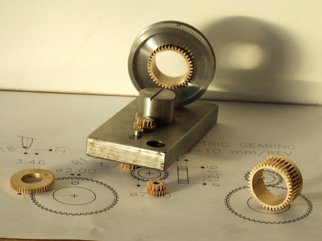

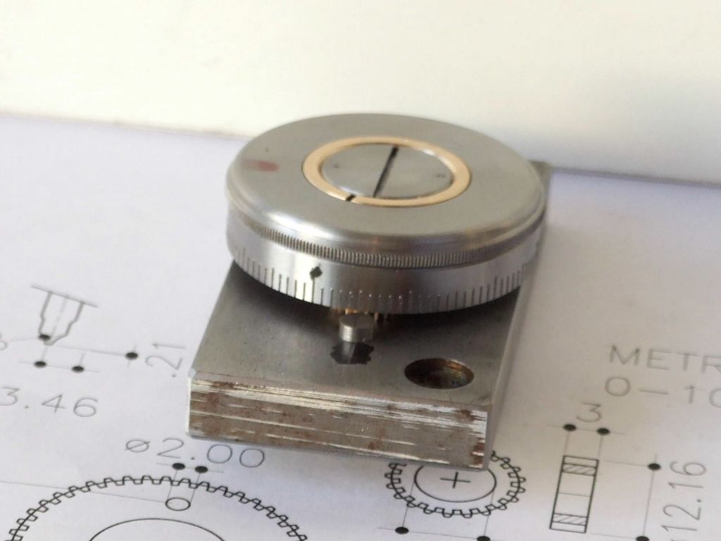

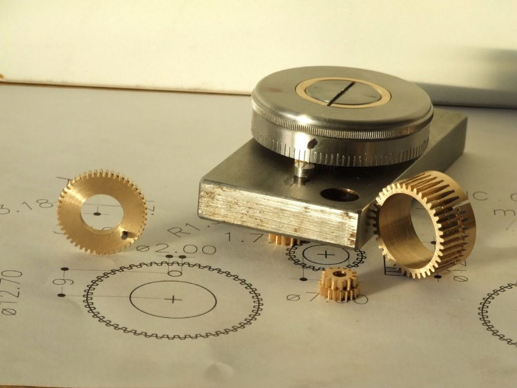

                              #377817
                              Graham Meek
                                @grahammeek88282
                                For those following the progress on this attachment. This week I have managed to cut all the gears for both versions of the dial. Today the dials were graduated, there are still 4 operations to complete them
                                The Imperial dial is shown after 5 turns and shows Zero, Although the photograph does not do it justice. The screw driver slot and the slit in the brass sleeve gear are in-line as they were before I started.
                                The Metric dial reads,30.50 after 4 complete turns, it should read 30.48, and it should read plus anyway because of the gear train.
                                Regards
                                Gray

                                      #378132

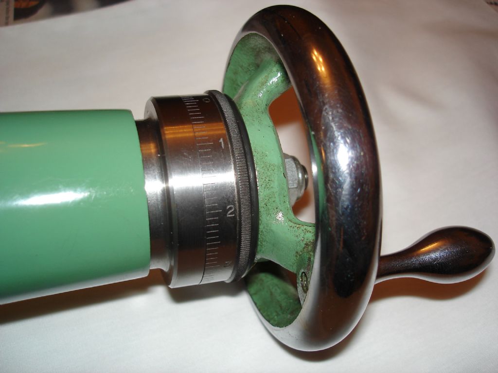

                                              #379399
                                              Graham Meek
                                                @grahammeek88282
                                                Thanks to Steve I am able to share with you a photograph of the Metric dial assembled onto the Tailstock. Looks as though it has always been there.
                                                Regards
                                                Gray,

                                                #379402
                                                Mike Crossfield
                                                  @mikecrossfield92481
                                                  Gray
                                                  Just a small aesthetic point. Was there a good reason for not matching the reduced diameter of the base to the diameter of the tailstock casting?
                                                  Mike

                                                    Graham Meek
                                                      @grahammeek88282
                                                      Posted by Mike Crossfield on 06/11/2018 10:28:19:
                                                      Gray
                                                      Mike
                                                      Hi Mike,
                                                      I and my helpers have deliberated over this very point. One problem which exists is the eccentricity of the tailstock casting. On some tailstock bodies the eccentricity is very pronounce and this would show up even more if the abutment face was larger in diameter. Trying to match the two would be impossible and would always leave a step somewhere around the diameter. To make the backplate just a plain diameter would I feel detract from the current set-up and make the assembly look bulky. Of course there is no reason why anyone making the attachment cannot add their own flair in this region.
                                                      Nothing is carved in stone with my designs.
                                                      Another point in favour of the reduced diameter comes when fitting this attachment to the 254 lathe. It appears from the photographs I have seen that Myford have "spot faced" the tailstock in this region to take the same part as is fitted to the S7, so a larger diameter here would be a problem.
                                                      This then was some of the rational behind why I have done what I have.
