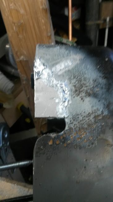

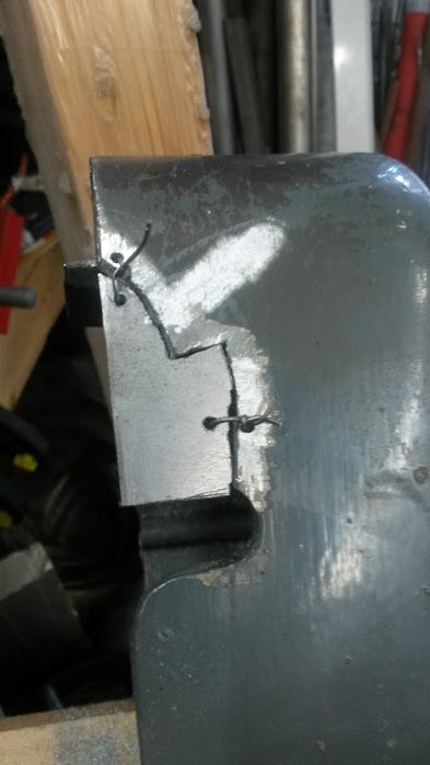

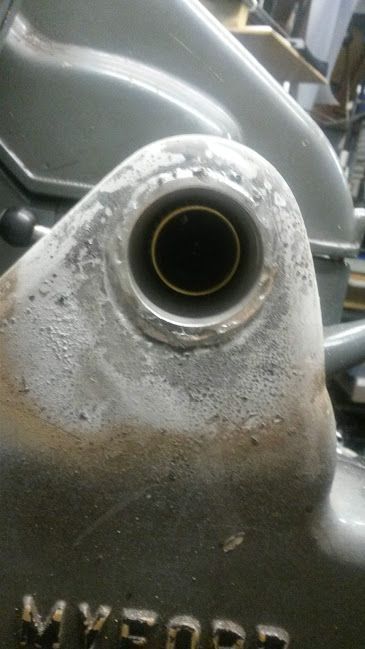

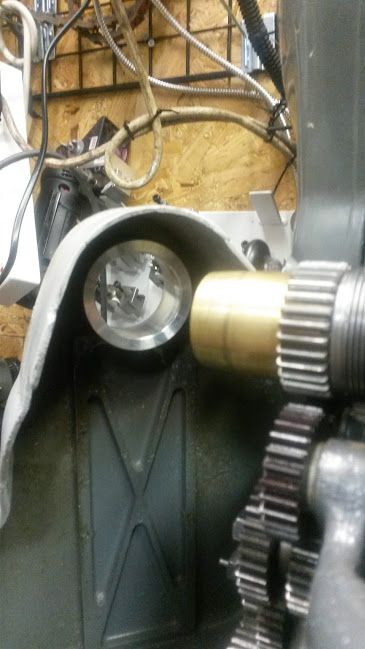

                  I repaired and modified my Super 7 change gear cover using the stuff the Scandiwegian chap sells at the ME shows. I welded the hinge section back on and replaced some bits I couldn't find
                  Above is a bit of Aluminium plate cut to fill in for a missing section, below is it welded in place.
                  I also cut out the standard tubular section and welded in a section of turned Aluminium tube to allow a suitable big bore rear extension to clear the cover when opening & closing
                  The welds are very strong, I bought another 6m of the wire at the show after I did this repair.

                    Like Nick above I have repaired a Myford cover using "Alutight" (the stuff the Scandi chap sells at shows). Very satisfactory and easy to use. However I found that the cover material is very easy to melt if you get a bit heavy handed with the torch. Then you have to build up the hole with more Alutight sad

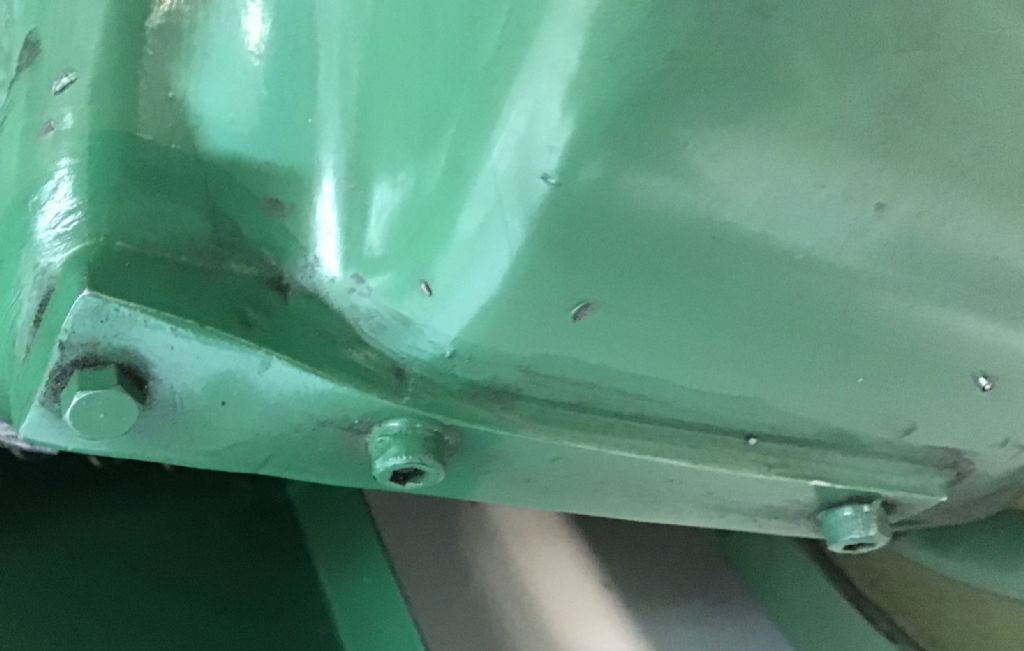

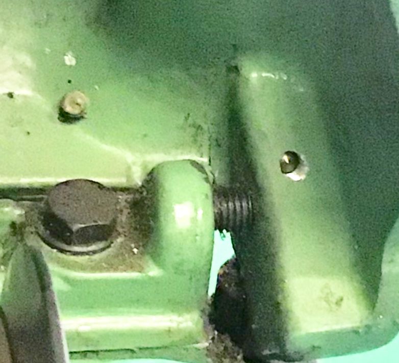

                          Hi. I repaired mine 15 years ago. A piece of 1/2 x 3 strip was bent approximately to shape (hot) , drilled and the cover was tapped M5 for screws The strip was bonded down with Araldite. No need to get it hot by soldering messes up the paint! It has been completely successful.
                          for some reason the photo is upside down despite rotating it and reloading
                          From the inside the crack can still be seen
