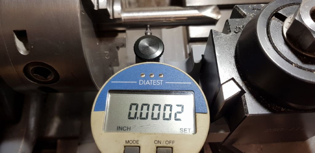

                                    If you can get hold of a used 100mm griptru 3 jaw it has a very accurate adjustability. I got one on the myford ,when purchased along with a 125mm 4 jaw independent. I say used because it looks like they are around £500 new.
                                    Mine was running out nearly 9 thou & i just thought it was how a 3 jaw was. Until i saw a thread on here about them being adjustable. This is how accurate i got mine at the moment. Other makes i cannot comment on as this is all i have.
                                    Steve.

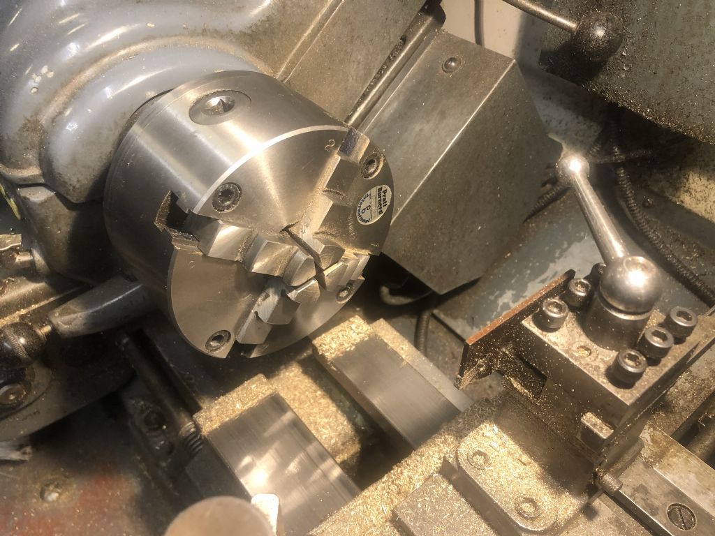

                                      #507132
                                      Peter Spink
                                        @peterspink21088
                                        Was lucky to find this a couple of years ago – brand new and unused for £100.
                                        A 125mm Pratt Burnerd self centring 4 jaw which I've been using on my S7 with no problems at all.
                                        It's a 'nice to have but not essential' bit of kit but I wouldn't be without it now.
                                        Only slight drawback is the chuck and backplate are quite heavy to manhandle but those with bigger lathes are probably quite used to that!

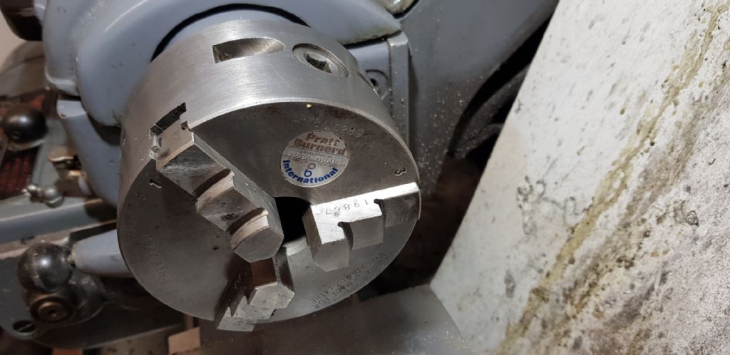

                                                Howard, the split screw doesn't affect the chuck – just looks bad. I can still tighten it up fine.

                                                  You are in business then! Even if it looks unsightly.
                                                  Probably driving on the bottom part of the square. Pity that someone, in the past, has brutalised the chuck so much.
                                                  It was a good chuck, but even so, it may still function satisfactorily, despite its appearance..
                                                  The reason for warnings about fitting big chucks is the concern that the weight of the chuck will so great as to cause premature wear of the plain white metal bearings in the Headstock.
