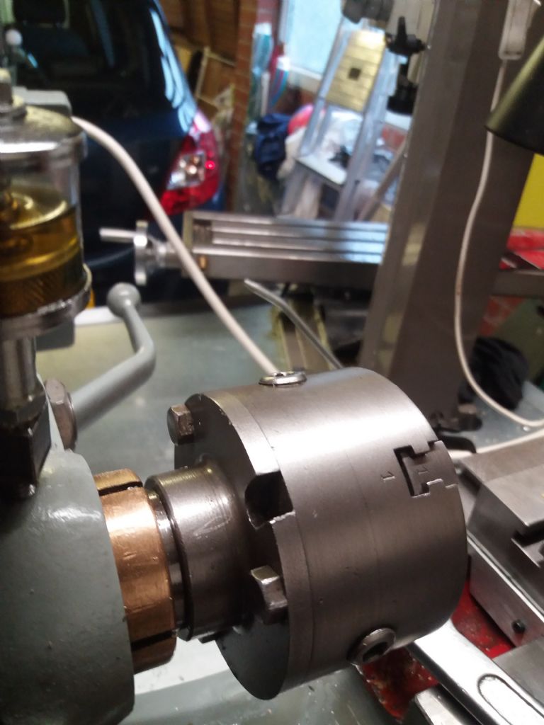

      I'm in the process of fettling my ML7, and it seems like the old 3-jaw chuck I got with it is a knackered as it looks:
      There are different versions available from RDG, ARC, and Myford etc, but which would people recommend? Myford do a "precision" version, but I'm assuming for critical work I'd stick with the 4-jaw?
      The Myford ones seem to need a backplate. Is this where you have to machine the backplate to match the chuck or something? I've never replaced a chuck before so don't know the ins and outs of it.
      Also, is it possible to buy new jaws and screws for the 4-Jaw? It looks like the original Burnerd version – it says "Specially made for Myford lathe" on the face.
      Please note that the condition of the chucks is how I got them – I didn't do the damage to them!
      Thanks very much.

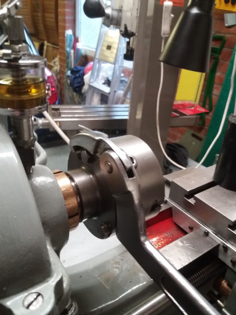

                    I remove the chucks by engaging back gear and putting a large adjustable spanner on the sides of one of the jaws. A bit of pressure releases them.

                      So does anyone have any recommendations for a specific make of 3-jaw chuck?
                      Do you just fit them, or does a backplate need to be machined somehow?
                      Thanks.

                              I use a piece of hardwood about 300mm long and 35 X 25mm section to remove and replace the chucks on my Myford.
                              I just open the chuck jaws about halfway and the wood fits between the jaws and is used as a lever.
                              Seems to work well enough and the wood does not mark the chuck.
                                  You risk shearing teeth off the back gear. Many have been wrecked doing this.

                                      So what's the best way of locking the spindle?

                                        On my M Type I have a notch and use a C spanner to unscrew the chucks. Just put on C spanner put a hand on the pulley and give the C spanner a tap with a No 0 copper hide mallet don't lock the back gear and don't disturbed the chuck alignment. As supplied by Myford.

                                            I have no way of using a c-spanner to lock the spindle. As far as I can see the only practical method is to engage a gear. I don’t need to apply a shock load, slight pressure on the long adjustable spanner always breaks it loose with not much effort. I never felt I was applying enough load to strip a gear.

                                                Re locking the spindle, I've not used this method as I have a S7 with spindle lock, but Mr Jordan's method looks nice and easy.
                                                Previous mention of a C spanner was to turn the chuck, rather than lock the spindle wasn't it?
                                                    It's much better to hold a stub of large hex in the chuck then use the spanner – over time, constantly doing it your way will stress the jaws/guides eventually, however slight the torque required. Personally though, I always use the chuck key to provide leverage
                                                    Engaging back gear and or inserting a piece of hardwood between the mesh is about the only way of locking the spindle on an ML7 if I recall correctly. As said the S7 has that very convenient locking pin.

                                                      I refer to L. H. Sparrey’s book quite a lot, and he suggests locking the spindle by engaging backgear, then putting some brass bar between the chuck jaws and levering it undone. Using a spanner isn’t that different – probably less damaging than a bar if I’ve assumed the contact points and load paths correctly. So I use a combination of Sparrey’s method and the one in Peak4’s video). Can’t see any harm in it tbh.
