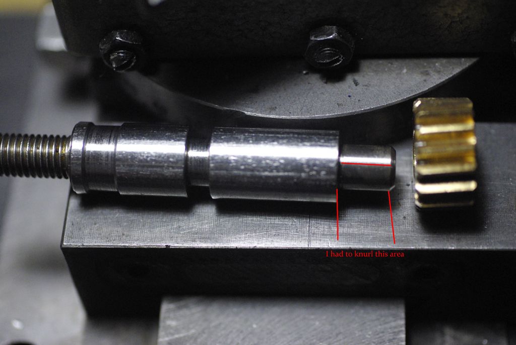

      If you wanted to squeeze the last life out of those gears without buying new, you could possibly put a shim between the apron and saddle so the upper drive gear is moved down lower and thus closer to the leadscrew for better engagement. Then replace the worn lower gear with an oversized Delrin roller, as all it does is stop leadscrew deflection so does not need to engage teeth for any reason. YOu would then have to adjust the half nuts to engage in the new position.
      It would be worth checking that the bolts holding your apron to the saddle are tight. If loose they could be allowing the whole apron to tilt, making the drive gear a loose mesh with the leadscrew, which could be the cause of the worn tips on the gear in the first place.
      If you buy new gears, it would be worth shimming the apron so the new gear engages to the full tooth depth to avoid a repeat of the problem..

        PS. Looking further at the pictures in the original post , it does appear that perhaps the original gears were throated worm gears made with the curved tops on the teeth for better engagement. The lower gear seems to have the same curved tooth tops so seems to be possibly original? Perhaps the new ones available today are made as the cheaper to manufacture straight variety?
        If that is the case, then definitely try shimming between the apron and saddle to get fuller gear engagement. I know I had to put shims in that location on my ML7 to get the best engagement of both halfnuts and rack gear.

          Just realised that GC's picture is upside down. So perhaps the idler gear is the same as the handle gear – after all it would make sense to mass produce teh same rather thatn have two differnet ones, so perhaps it is possible to swap them over, or use teh lower one and preplace it with a plain roller or flat plate as used on other lathes to oppose the push of the half nut.

                    Bob, I dont know where you can get a lower gear. But it should be possible to use an upper gear in the lower position if you mount it on the different spindle. They appear to be the same gear.

                      Yes, apologies for the orientation – leaning over from the back of the lathe, holding a torch in one hand and trying not to drop my phone . But from what I could see, the two gears are the same (at least on the outer circumference).

                        To clarify part numbers for Bob's benefit – reference 122 is the 'eccentric shaft' not the gear. The lower gear – referred to on the parts list as a 'counter pinion' is reference 119. There are two different versions of this – one for 8tpi imperial (A6513), or metric 3mm pitch (10296). The numbers in brackets are the original Myford part numbers. The other numbers 119, 222 etc that I mentioned earlier are more correctly the part reference numbers used by Myford on their drawings.
                        I would assume (!) that both pinions are the same, but, the lower one appears to be free to rotate on the eccentric end of the lower shaft and is shown retained by a circlip, reference 123 (Anderton external type, 5/16 inch). The upper pinion is fixed to the handle spindle but no details are given of the fixing method; press fit?

                              I recently replaced my transverse gear assembly as the brass gear was in a condition similar to yours. I ordered the new assembly (gear and spindle as per Michael Gilligan's link). After several confusing emails concerning acknowledgement of my order and subsequent shipping info, I finally received the item. When I opened the package, the contents fell apart in my hand. I needed to knurl the steel spindle in order to establish a tight press fit for the gear. This is what it looked like when it finally arrived from Myford.new myford transverse.jpg
