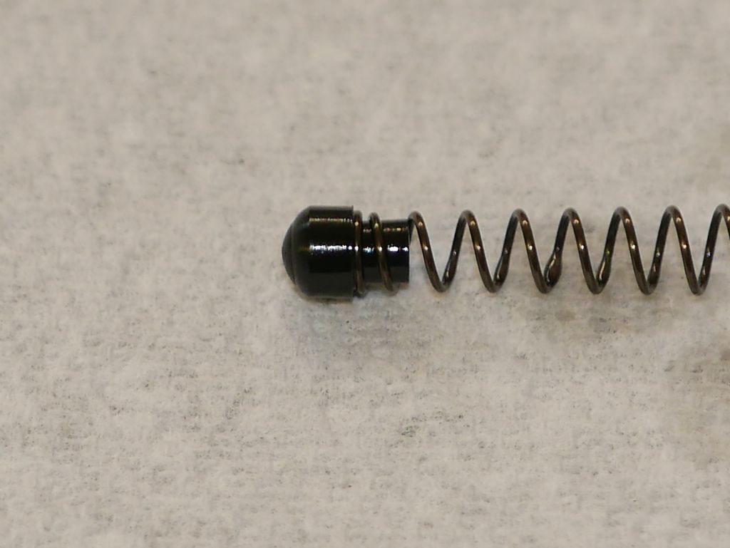

      My oil gun came from the Nottingham factory with lathe bought in the closing down sale in 2011. It looks identical to the one on the current Myford website. The assembly looks the same as Rod's but note the rubber seal in the nozzle.

        Thank you Andrew, that is the same oil gun, I have the spring and on further investigation the seal is present in the nozzle. What appears to be missing is the valve or ball bearing attached to the spring. Is it a ball bearing or valve? Can you kindly confirm please. Thank you again Robert

          Hi Robert. The valve attached to the spring is a medium-hard rubber. The large diameter is 5.0mm if you want to scale one from the photo.
