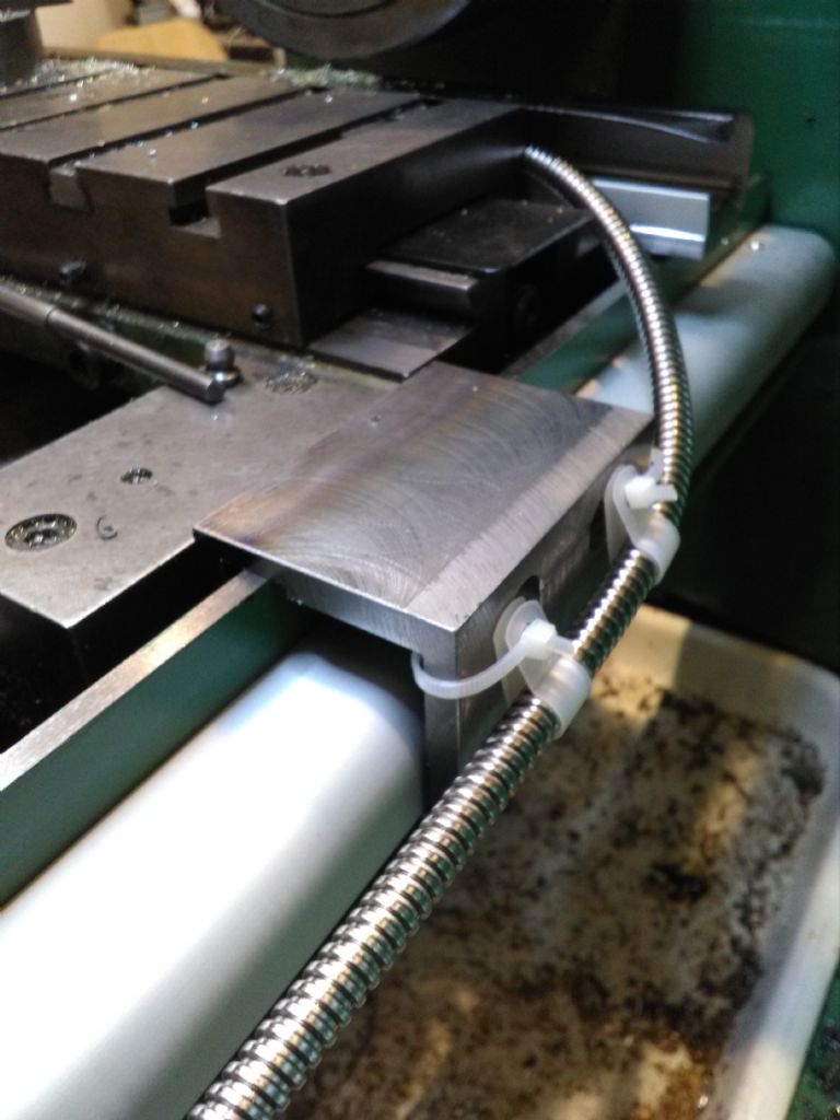

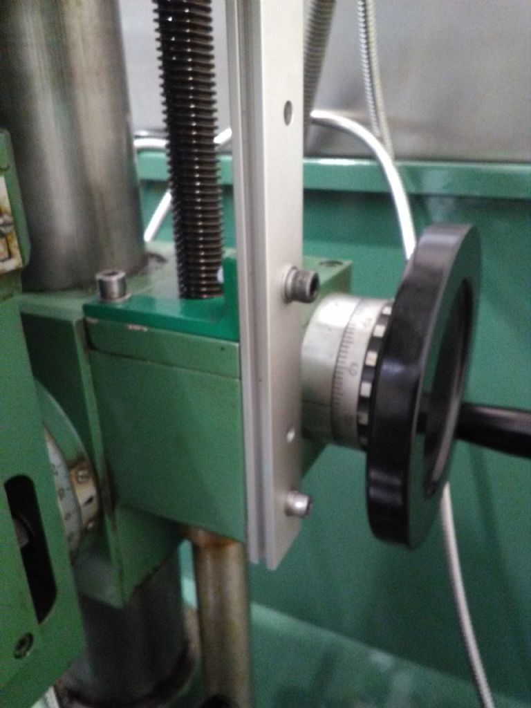

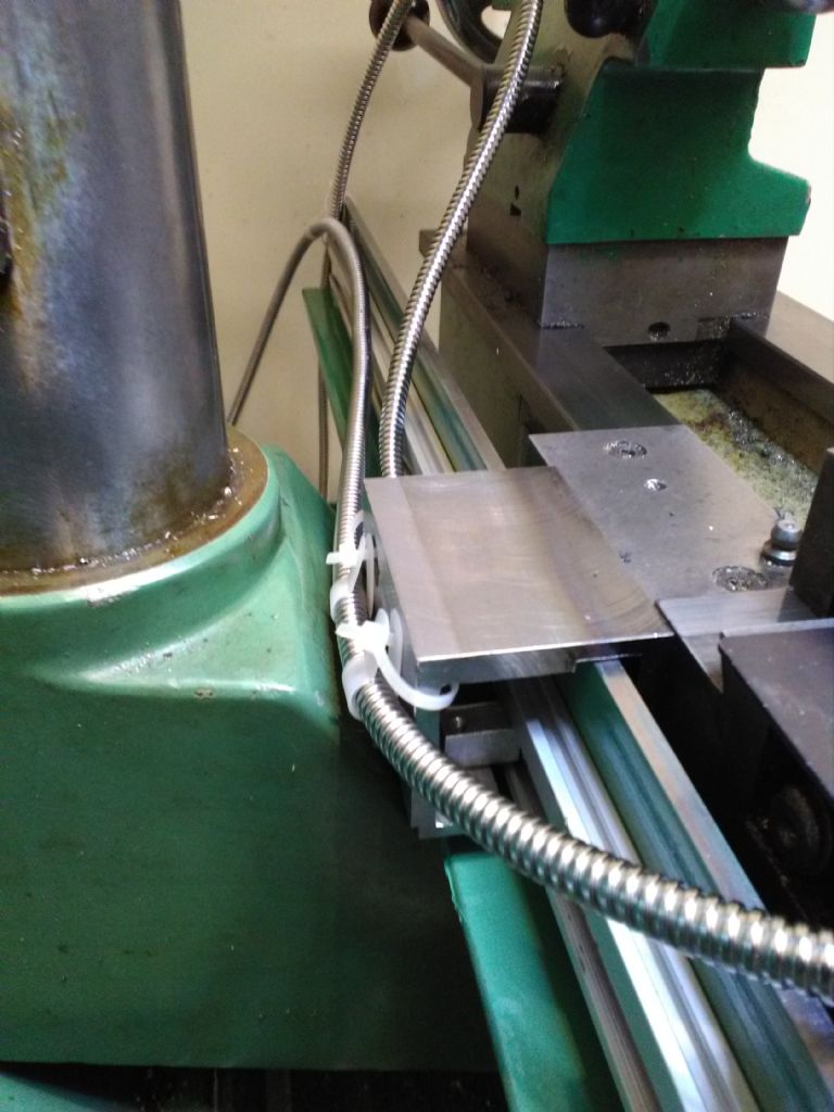

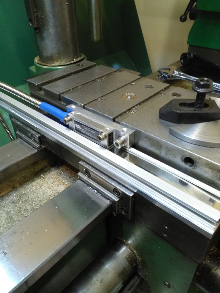

                          I have fitted one of the magnetic three axis kits from machine-dro.co.uk to my 254 and its good. Because I have the VMA attached I had to make custom fittings with an auxilliary beam behind the bed for the main feed readout and I fitted the cross slide readout in front to take it down low enough to allow a myford milling baseblock to fit. Picturesattached.img_20180429_140613.jpgimg_20180429_135123.jpgimg_20180425_181323.jpgimg_20180417_201654.jpg
