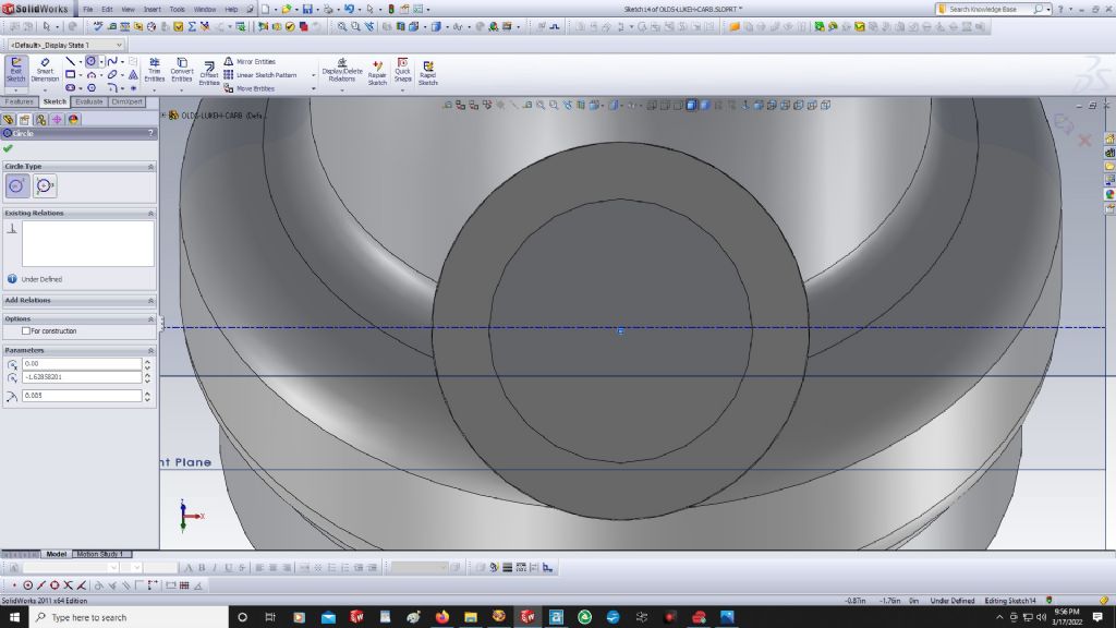

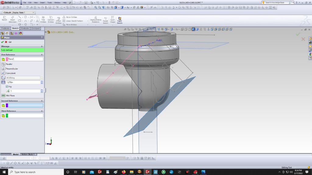

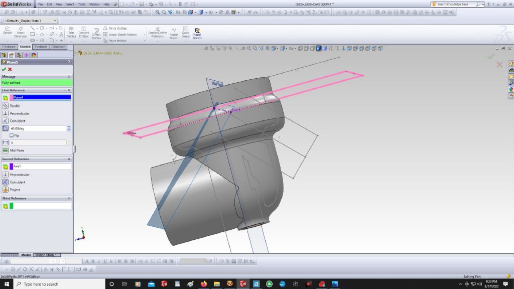

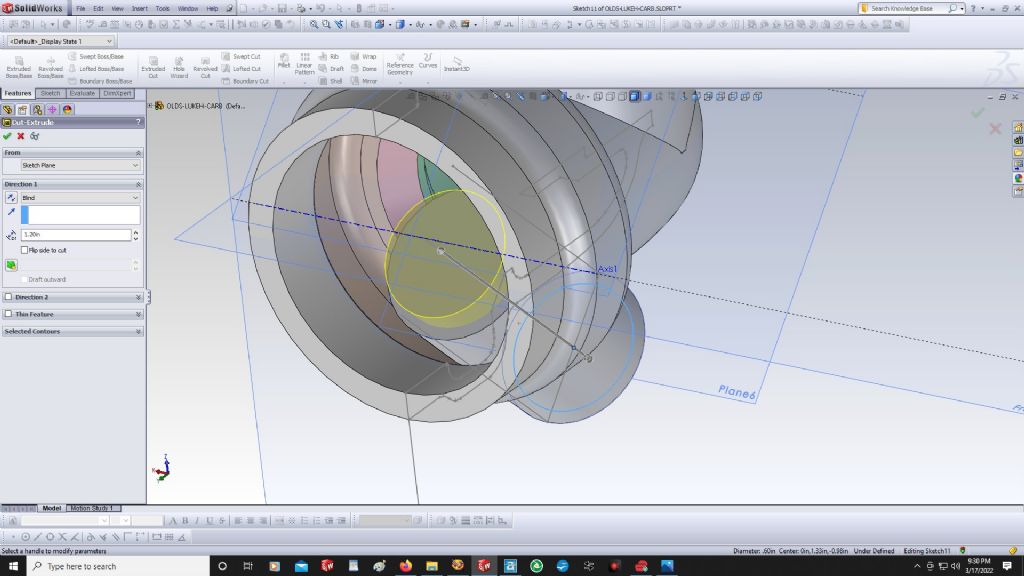

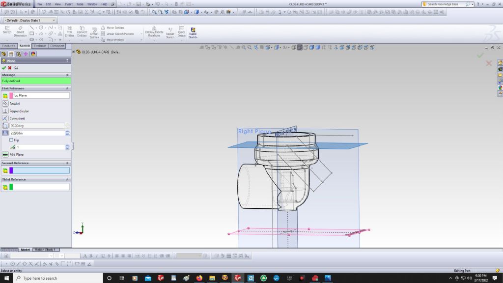

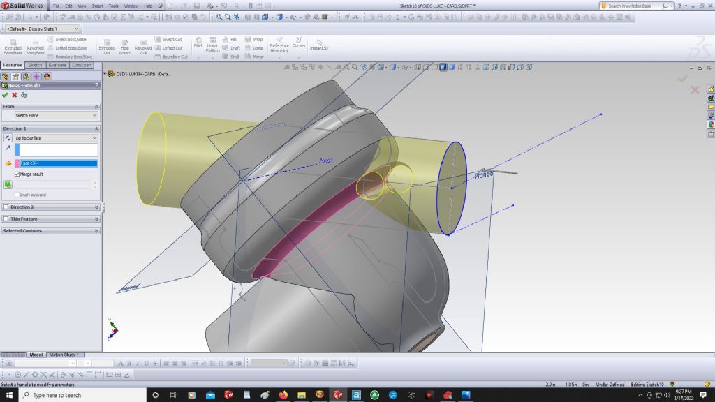

      This is my first attempt to model a Lunkenheimer carburetor.
      I made this model a few weeks ago.
      I think it is almost done, but perhaps not 100%.
      Not too bad for a first attempt, in my opinion, and not much time spend on this model (perhaps 2 hours).
      I had never modeled a carb before, and so I just stumbled my way through the model.
      My approach to modeling is to create a model in any way that I can, no matter how crude or clumsy the appoach or model may be.
      If I succeed in creating an accurate model, even if I used very crude methods, then I use the model "as-is".
      If I revisit the model later for use on another engine, I may re-model some parts of it, or create a new model entirely, if I think of a better more efficient approach.
      The main thing is to create a usable model.
      Don't worry about winning a "3D modeling efficiency" award; just get it done and refine your technique later over a period of time.

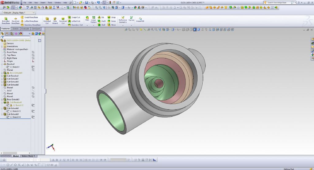

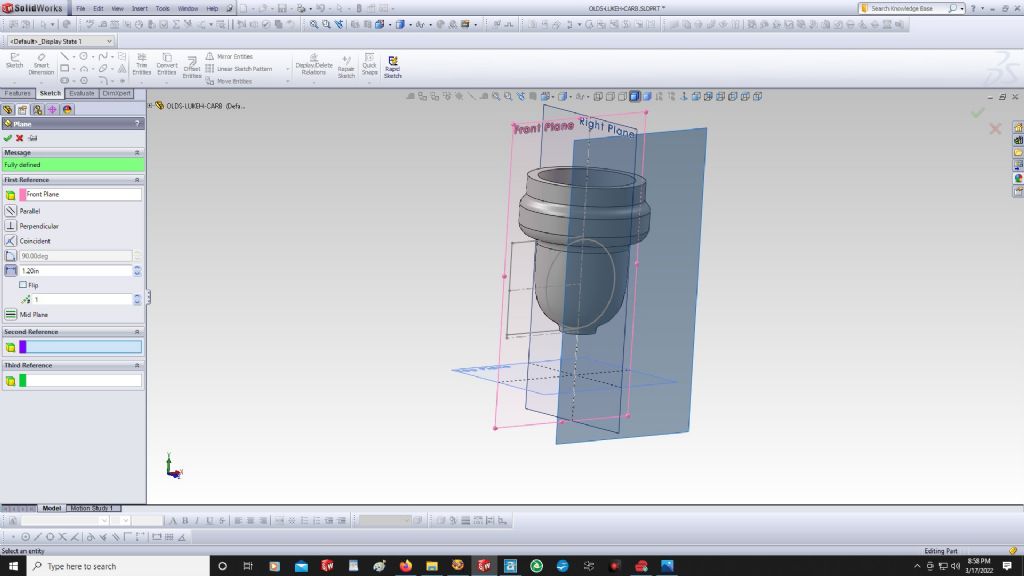

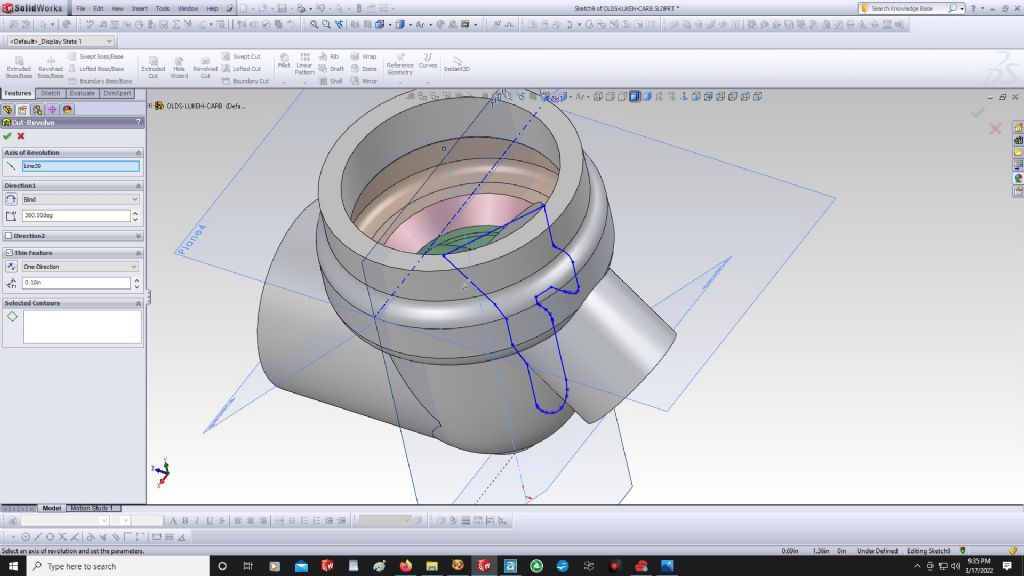

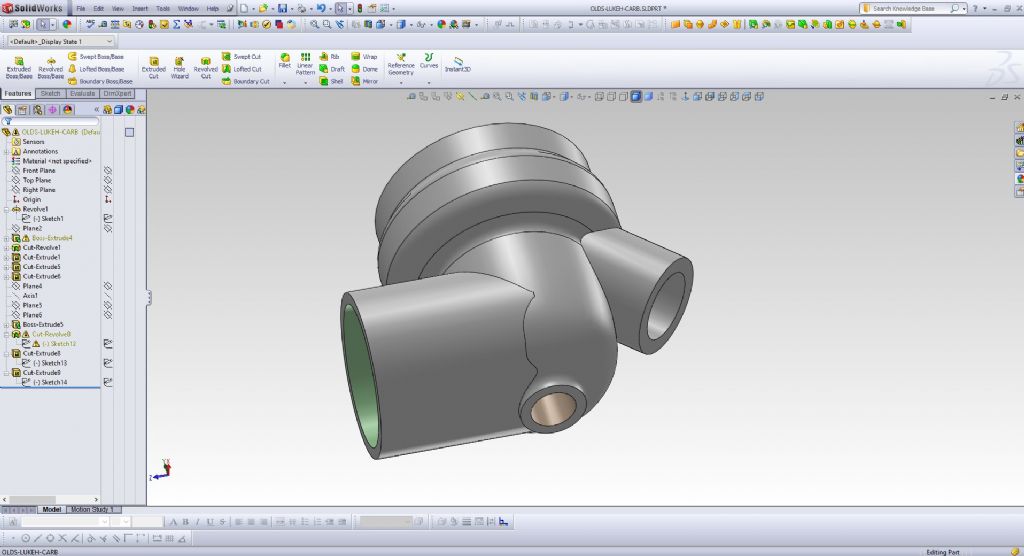

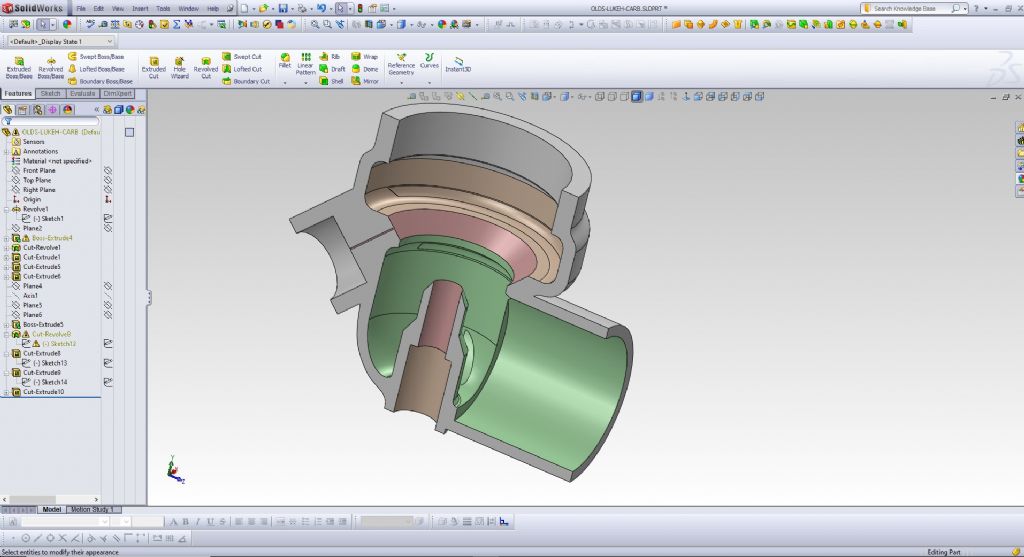

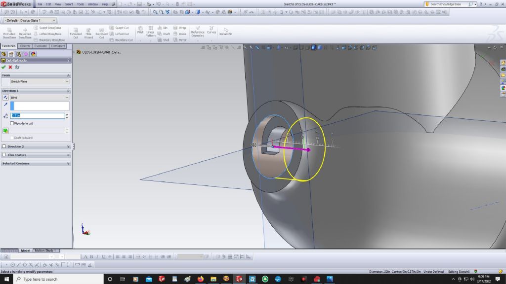

          More screen captures.

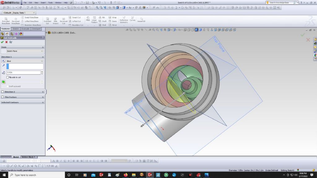

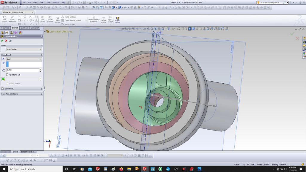

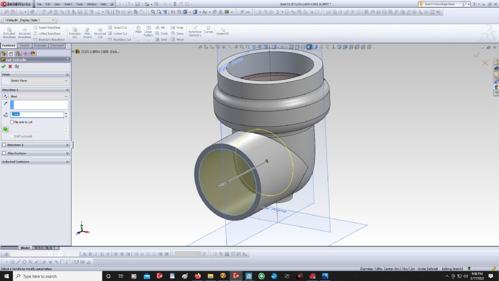

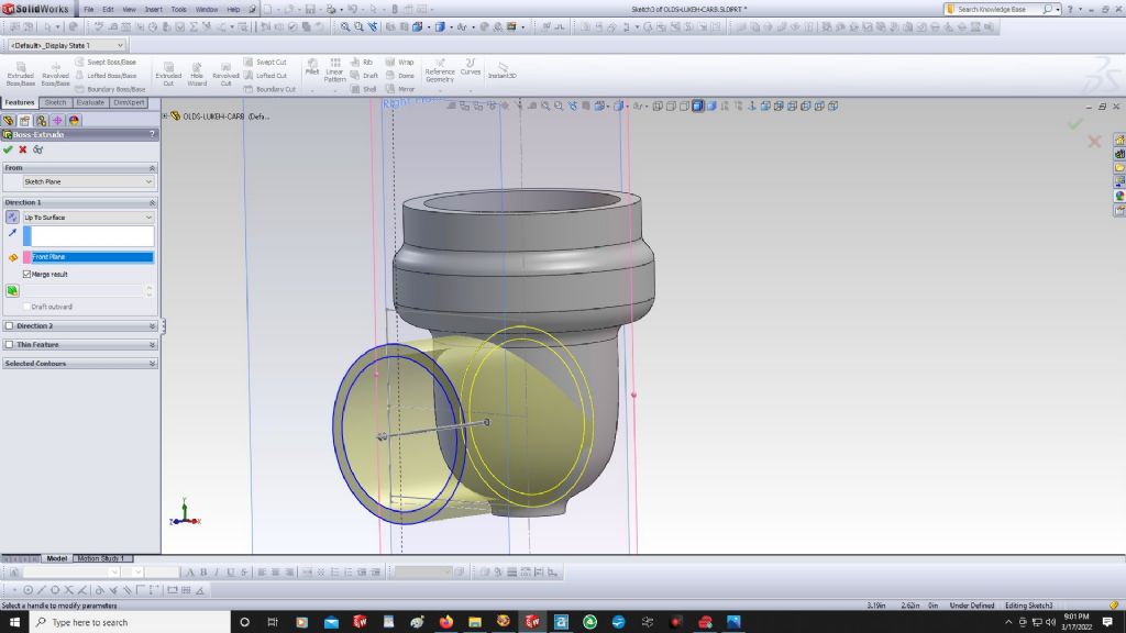

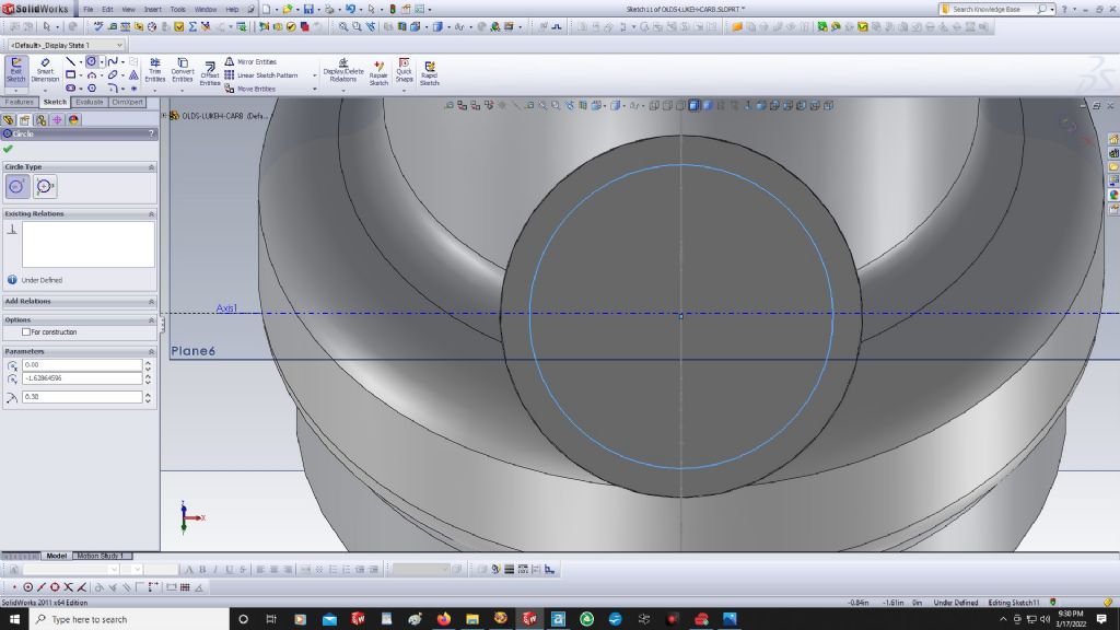

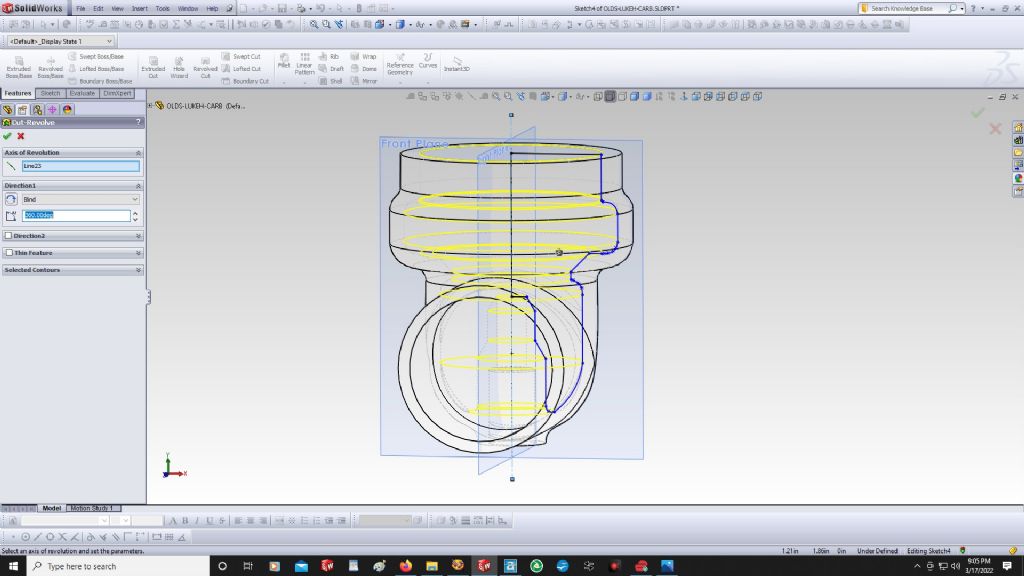

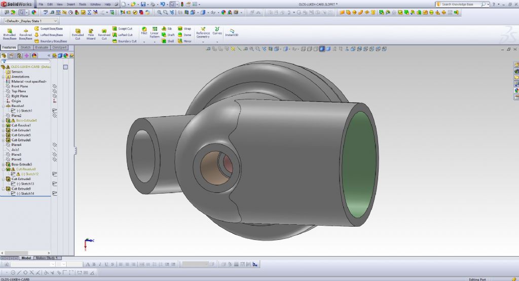

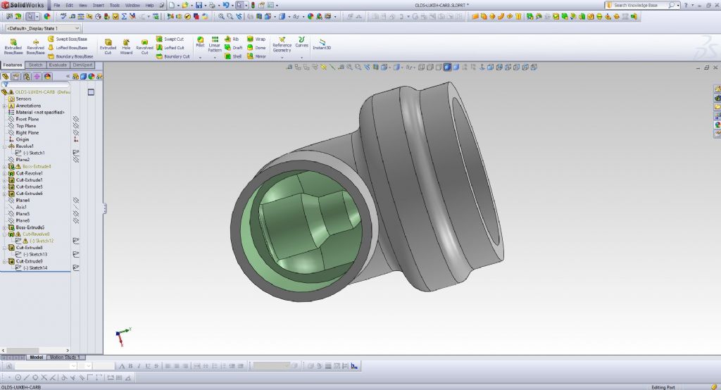

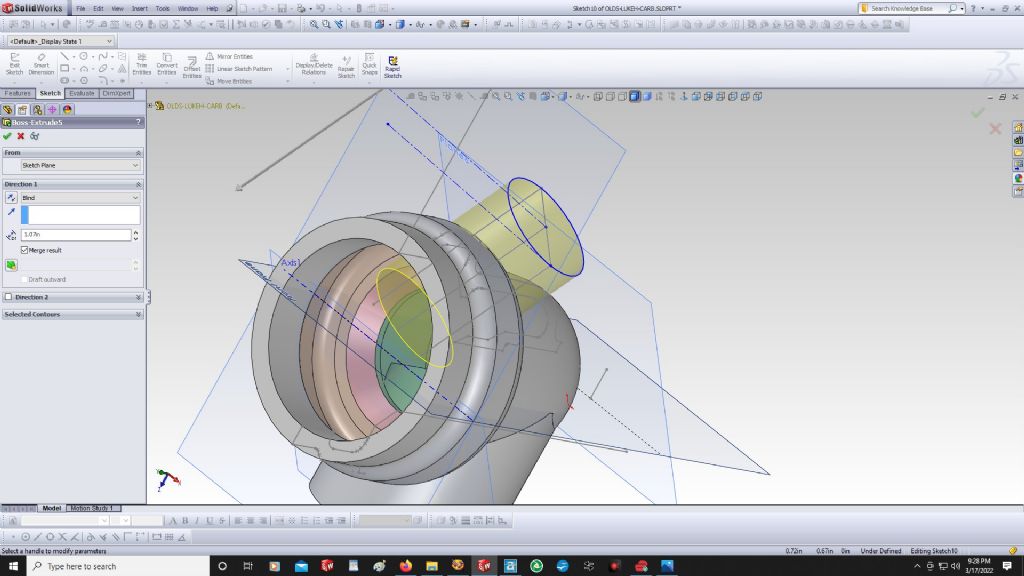

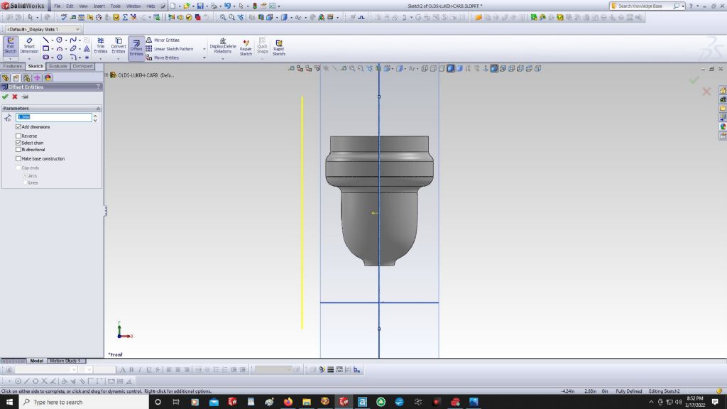

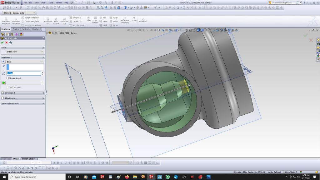

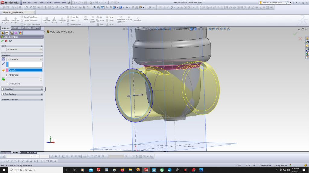

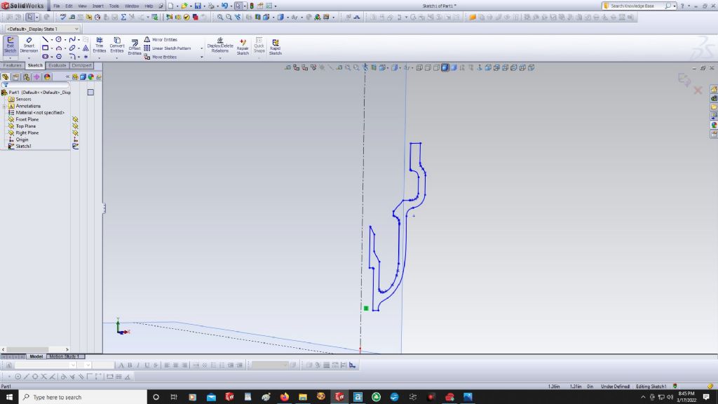

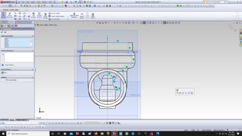

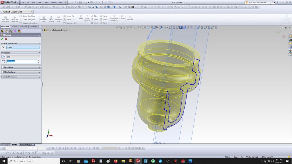

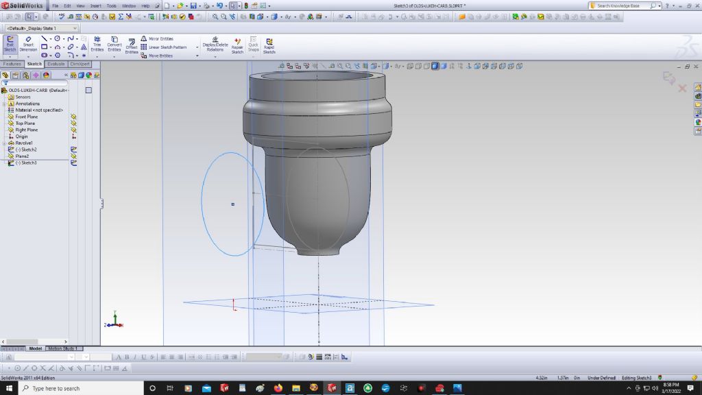

                My intent as with all of my 3D models is to 3D print patterns, and then cast the parts.

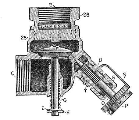

                The original sectional sketch that I used to rotate the initial bowl shape was taken from an old engraving of a Lunkenheimer carburetor, by importing the sketch as a raster image, and then tracing over it to create a 2D sketch, which I imported into Solidworks on my initial sketch plane.
                There are many ways to create this model, and many would no doubt be better than the methods I used, but I was able to get through it in a short period of time.
                The best way to finish a 3D model is to actually start a 3D model.
                Nobody I know of learns 3D modeling without diving in there and getting their hands dirty.
                Edited By PatJ on 11/05/2022 03:26:15

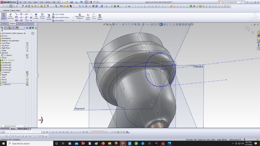

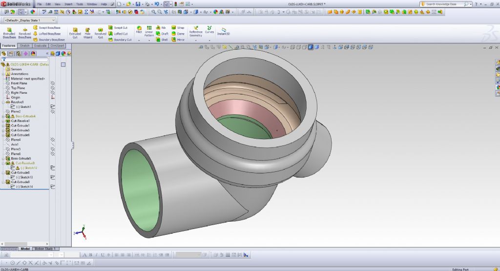

                  If I can get a 3D model printed fairly accurately, for use as a pattern, then I can touch it up either by lightly grinding/sanding/cutting on a few spots, or filling a few spots with filler.
                  Most 3d models are not perfect, but the intent is to 3D print something that can be made usable with some minor touch-up work.

                          How easy is it to produce the core and corebox from those drawings using Solidworks?
                          All the Lunks I have made have the bottom valve guide a separate part so coring is a lot less complex. The fun part is machining the valve seat and getting the fuel hole to exit through the seat.

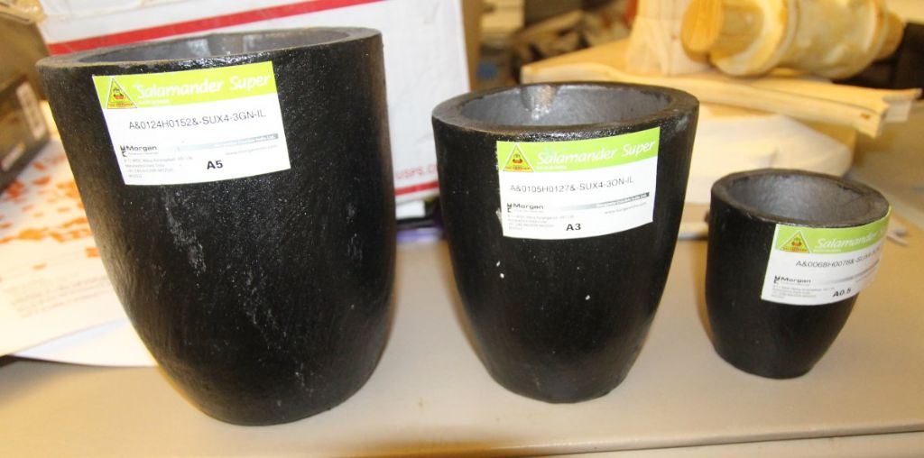

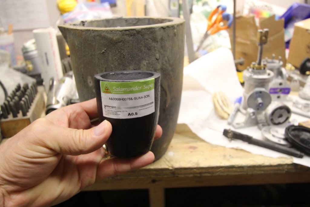

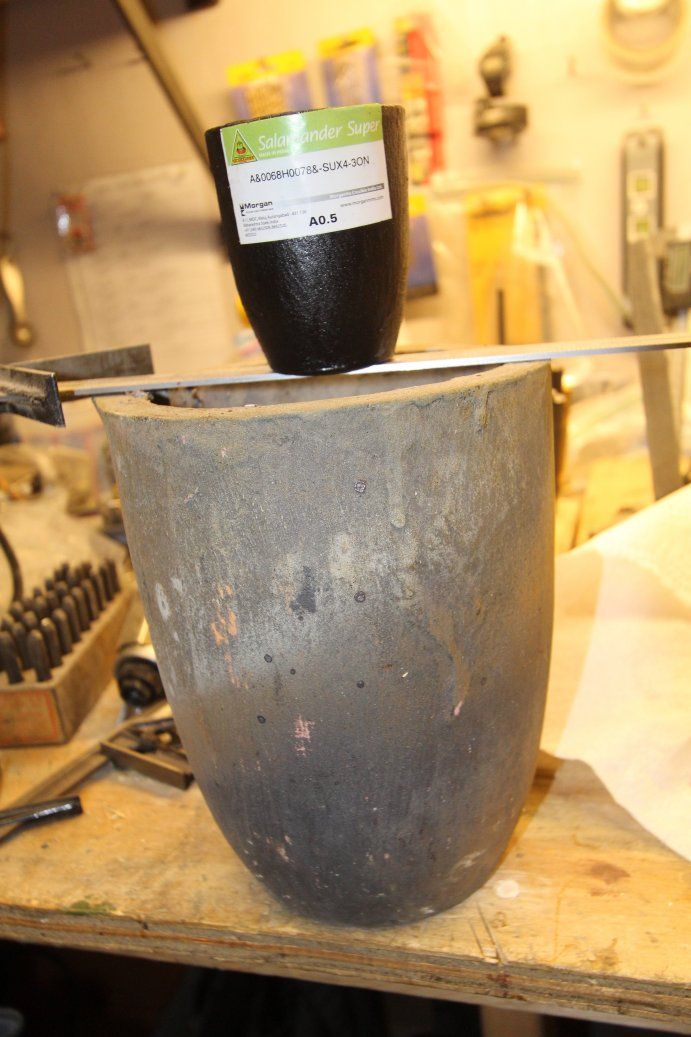

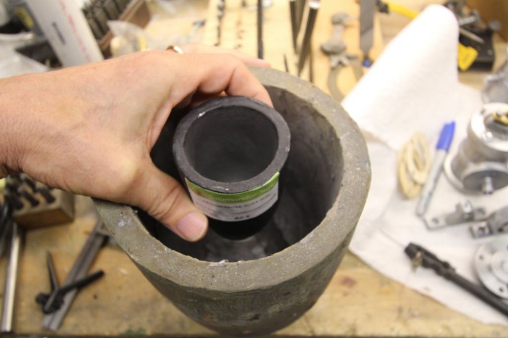

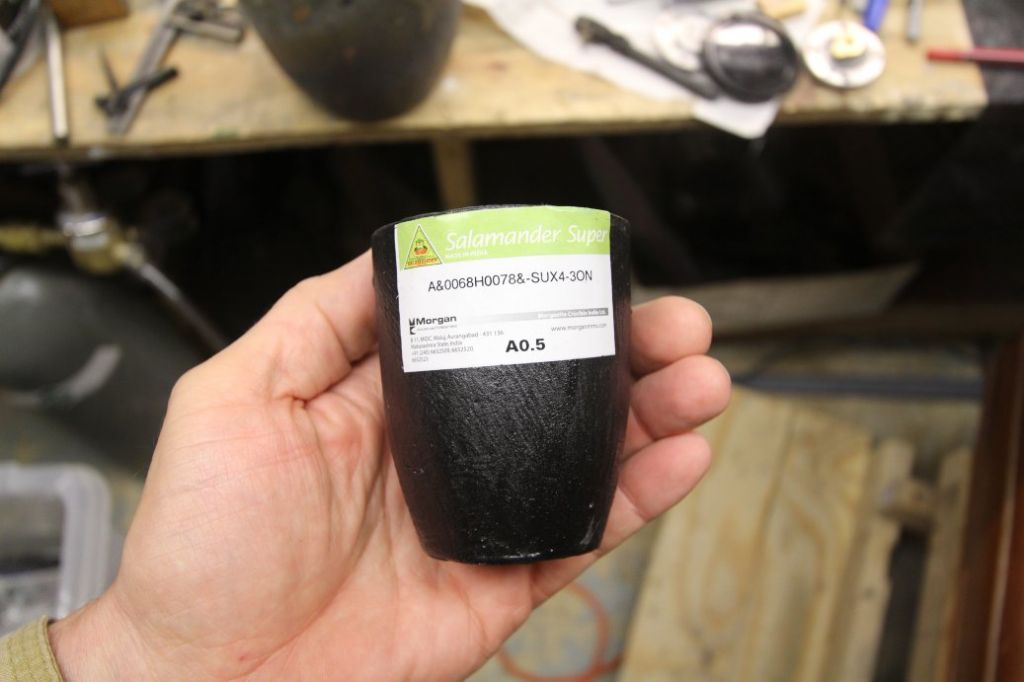

                              I bought some small crucibles. Photos attached.
                              I still say that the trick would be drilling that fuel hole. I would not start to make a casting without mastering drilling some tiny holes first.
                              The 0.5 crucible is compared to an A10.
                              Edited By PatJ on 12/05/2022 08:21:46

                                I have a range of crucibles I could use, but an A0.5 would be really easy to handle, if it were large enough, and I think it would be large enough for one or two carbs of a model engine size..
